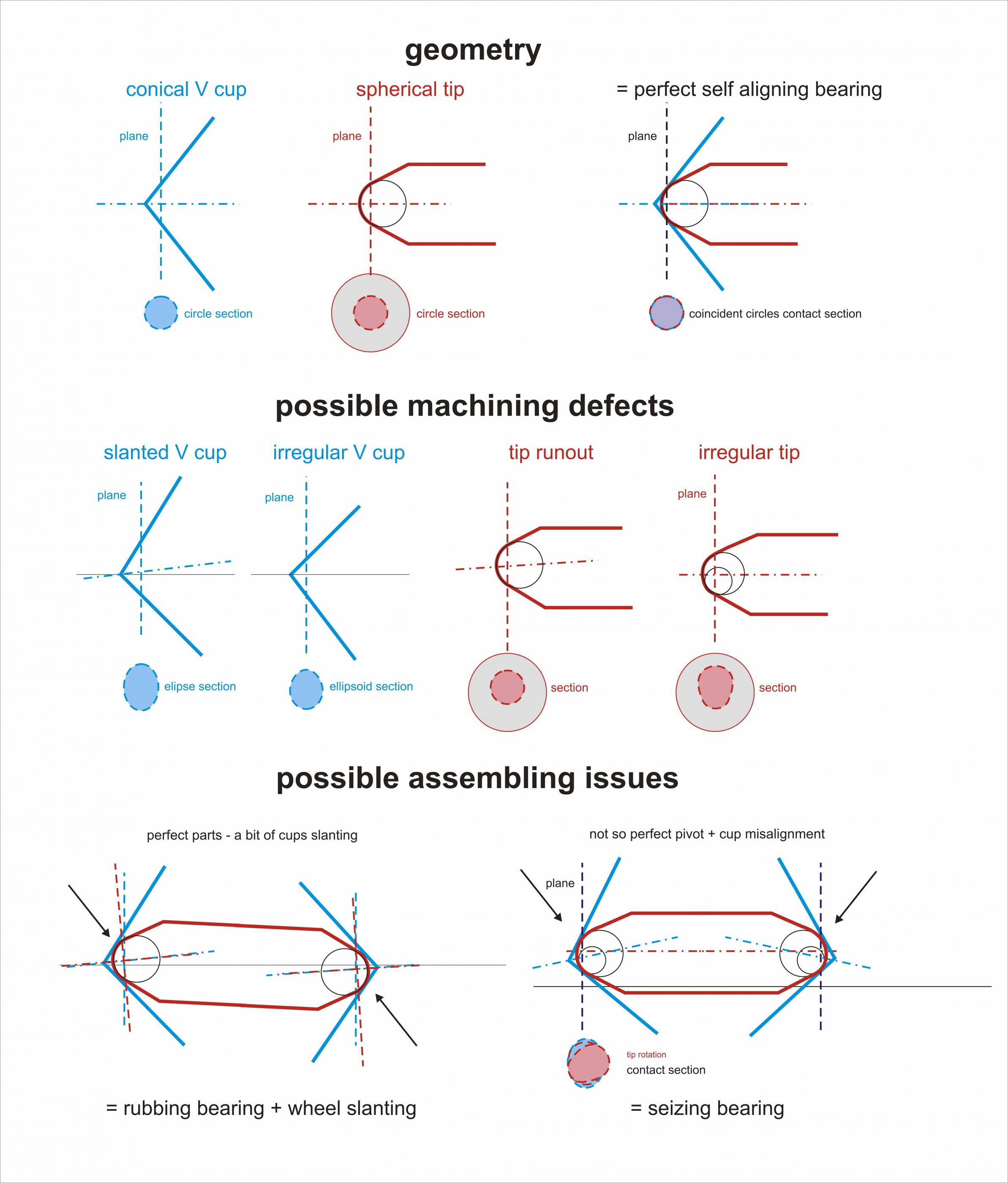

Really surprised that a conceptually simple and self-aligning carriage, so beautifully made by Warren, could face unexpected problems, i've tried to examine the possible faults sources in a so small V bearing.
Here some sketches on these thoughts.

Hi Warren. doing those drawings I realized that there are more problems around than the simplicity of the V bearing suggests. With such small dimensions the tolerances become really difficult to maintain (impossible for me), and a few extra milligrams of friction are enough to bring a lot of trouble.
he thing that surprised me more is the slanting of the wheel (and there are 2, unfortunately) caused by the tilting of the cups. The pivot has to find a circle section on the cone, tilting it's own axis.

Would you consider that the torque around the carriage centre might make the pivots climb in the cups? I seem to recall only the bottom being polished.
Also, Niffy has laid the groundwork here and the application calls for super hard materials to function correctly, ceramics and crystalline are the way to go but I do understand the supply problems as I have the same in my own projects.
Although the weight is very low here, the 4 contact points in the cups are very tiny, you could perhaps calculate the force at the points and determine if the materials are adequate. If the coefficient of friction and the force at these points overcome the slip in the cups, the pivots could run like a roller coaster in the bottom of the cups for oscillating torque.
There might be some evidence of this in the video without the brush, not 100% sure though.
You have done all the hard work already and to reach the same results as Niffy is not far now. Well done.

some more thoughts on V bearings
A - springed V jewel = elastic system, zero clearance needed
A1; maybe + friction 0 chattering -- A2; if slanted the V cup induce a pivot tilting to find a circular contact
B - V jewel + tuning screw = rigid system, some clearance needed
B1 maybe - friction + chattering -- B2; even with a slanted V cup, the pivot can stay aligned.
In B case the carriage weight determines friction and chattering - an heavier one seems beneficial against chattering, and, strangely, also some jewel misalignment (more stable contact)
carlo
just an hypothesis of course, but somehow confirming Niffy's reports about clearance and better sounding heavier carriages

Hi Carlo,
For our application I believe that the rigid system (B) is preferable. As the bearing is under constant load with a high contact pressure there will be no chatter. The friction will tend to be lower if there is a small amount of end shake, 5-10um. The sprung vee mounts are designed primarily for shock absorption for use where there is strong vibration or shock such as portable meters that run the risk of being dropped. The sprung mount is designed to prevent the jewel from being damaged. It is not designed to help align the bearing. As the pivot contacts the spherical cup of the vee and not the conical section absolute alignment is not critical.

yes, after those drawings I am convinced too that B is much better, especially with a carriage of a certain weight; otherwise the rotation could cause the pivot to climb on the Vee surface, with some irregular motion.
After all, V bearings are usually used vertically.

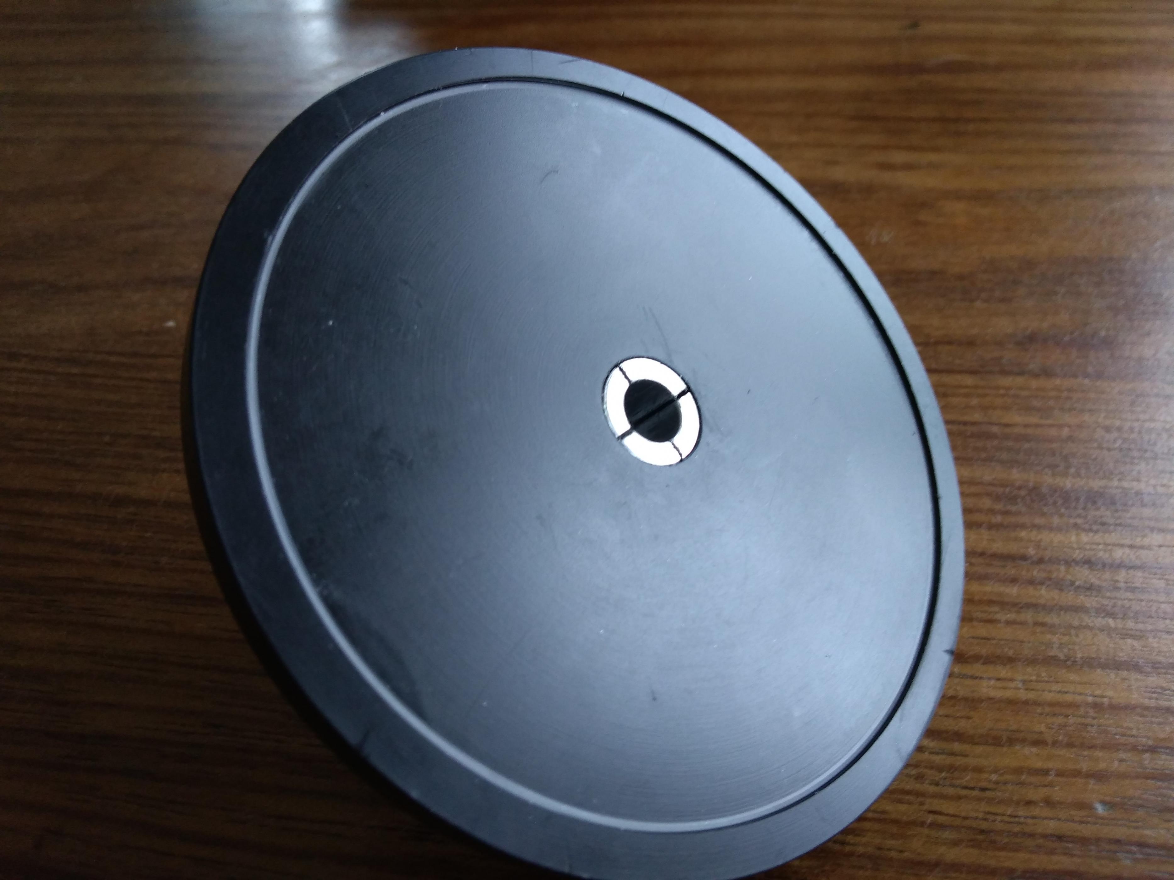

Hi Niffy,
You are correct the centre weight made the LP curve up at the perimeter. I was thinking ( a dangerous pastime I know) if I made an acrylic mat with a small dish like the in the link. The rubber mat on the SP10 has the label indent (which I think is too deep) but the mat is flat.
[DIY] TNT DIY Acrylic Turntable Mat
I have been thinking about the periphery clamp but I have not yet devised a way to machine it in the lathe, my lathe will hold 330mm but I would have to remove the gap and I don't want to do that too hard to get it back in. The commercial clamps are milled but I don't have a rotary table.
I have not given up on the pin bearings I am planning a new carriage that will use pin bearings. The mistake I made with the current one was two fold. I drilled the polycarbonate for the M3 Vees too slow and I suspect the drill wandered. I also drilled after shaping the carriage top so I had to line it up to drill with a square. It was not out by much visually it looked ok but if you put a straight edge (100mm carbide rod) between the wheels it was obvious.
This time I will machine the top of the carriage rectangular so I have the bottom perpendicular to the sides this way I can get the screws in the correct location. I'm a electronic Tech/Engineer by trade not a machinist so still learning the finer details of the art.
The RH wheel was pointing ever so slightly outwards so as the carriage moved it was trying to twist add that to the slight out of round of the carbide ring and I think these 2 things added up to miss tracking.

Hi Warrjon,
As a simple experiment you could try some different thickness penny washers over the spindle. One that is slightly thicker than the depth of the label recess would be a good starting point.
Depending on the material you want to make a peripheral clamp from you could just use a router with a circle jig. I made my platter using a router and that came out very well.

I measured the black acrylic I have and it's 3mm thick and just over 300mm square so I might use this for a mat. I have some 10mm thick polycarbonate that is big enough to make a peripheral ring from..........I have a router circle jig - good thought
My Vee's are high tensile M3 grub screws. I machined the carriage in the milling machine, which has a Digital Readout with 0.005mm precision. So I can centre the chuck and drill holes at Xmm each side of centre in X and Y axis. I used polycarbonate for the mounting blocks which did not drill well at low speed. I am going to use aluminium for the next mounting blocks.
Last time I drilled the holes all the way through from one side so the drill must have wandered. Next time I am going to drill/tap each Vee mounting hole separately.

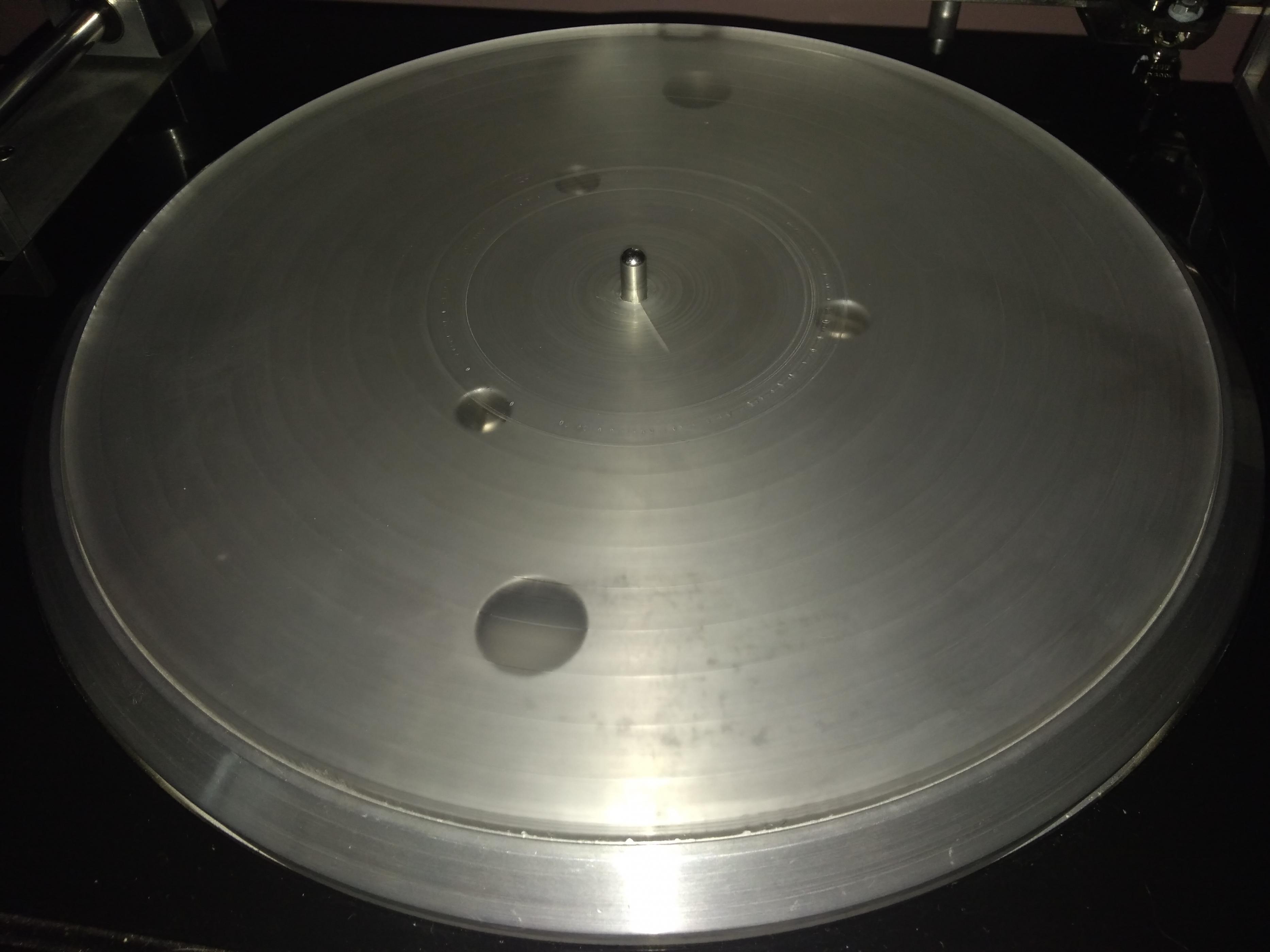

I found some 5mm clear acrylic so made this. It's the same outside thickness as the SP10 mat. I cracked it trying to machine the last little bit near the spindle.
9 steps of 0.08mm with label indent 0.1mm below the 9th step. Unfortunately it didn't flatten the 180g LP as I had hoped, but the sound was better background noise dropped and detail improved. It was a success but not in the way I had expected. I will need to make a periphery clamp.
Dealing with bad warps. I had hoped that the dished mat would work but alas it still didn't flatten dished LP's and I don't have room to use a periphery weight. So after some research I decided to make a clamp and felt washer similar to the Mitchell.
I made a new mat this time flat with a 0.75mm label recess.
