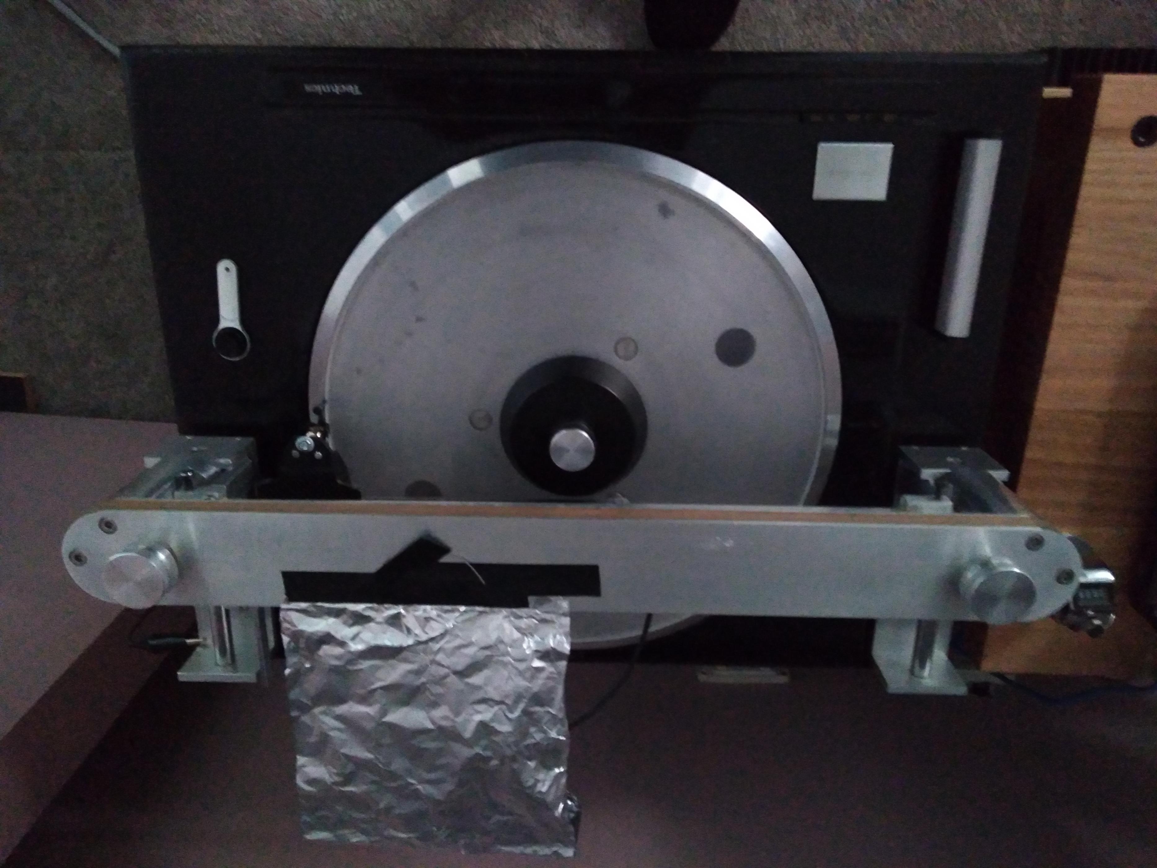

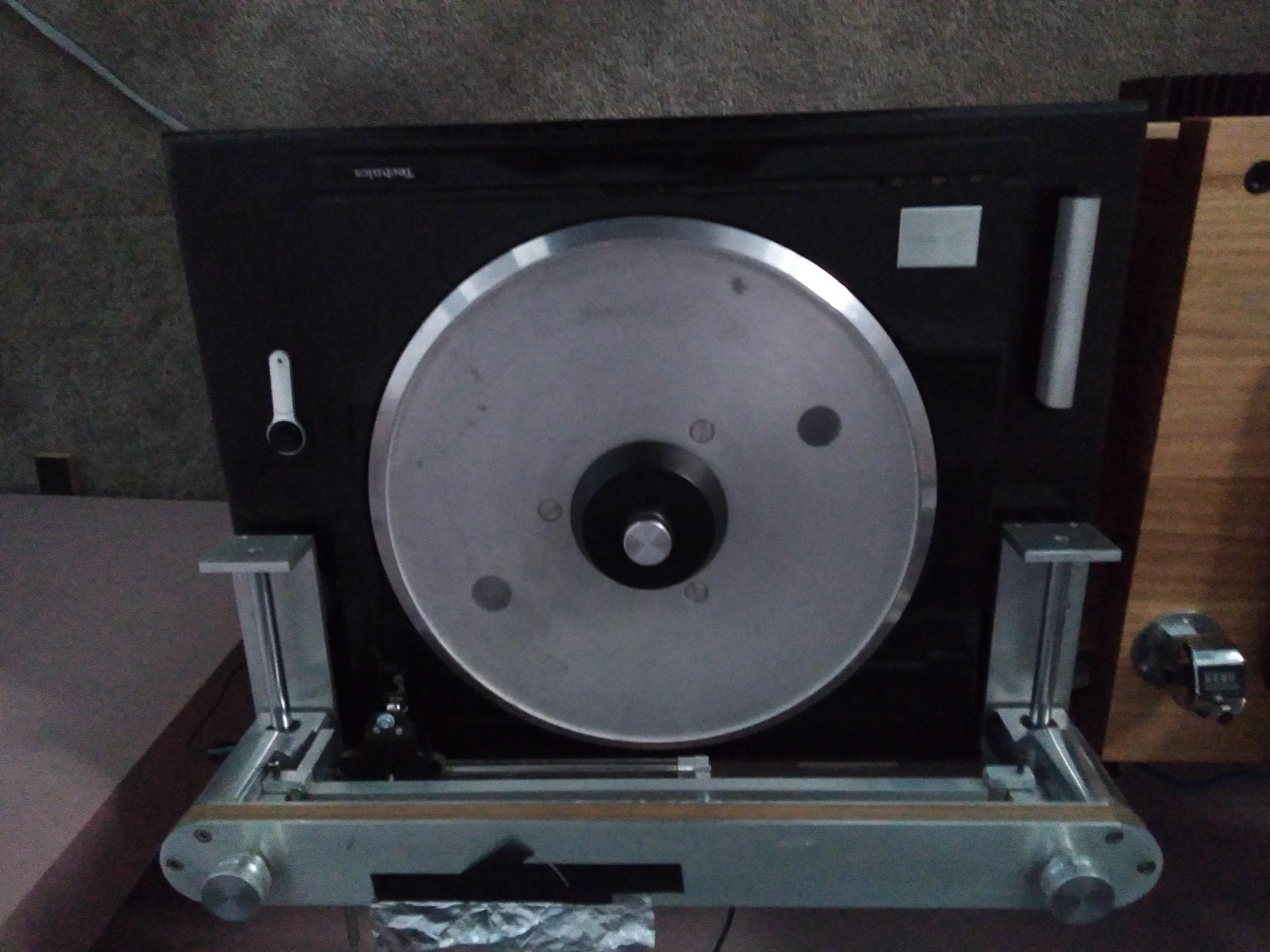

It would be if the rail was fixed. Mine is designed so the whole rail moves backwards to facilitate changing records. It's held forward by neodymium magnets.
Others have done it differently, Niffy's also moves back and others rotate away from the platter. I wanted mine to be mounted both sides of the rail to increase rigidity.

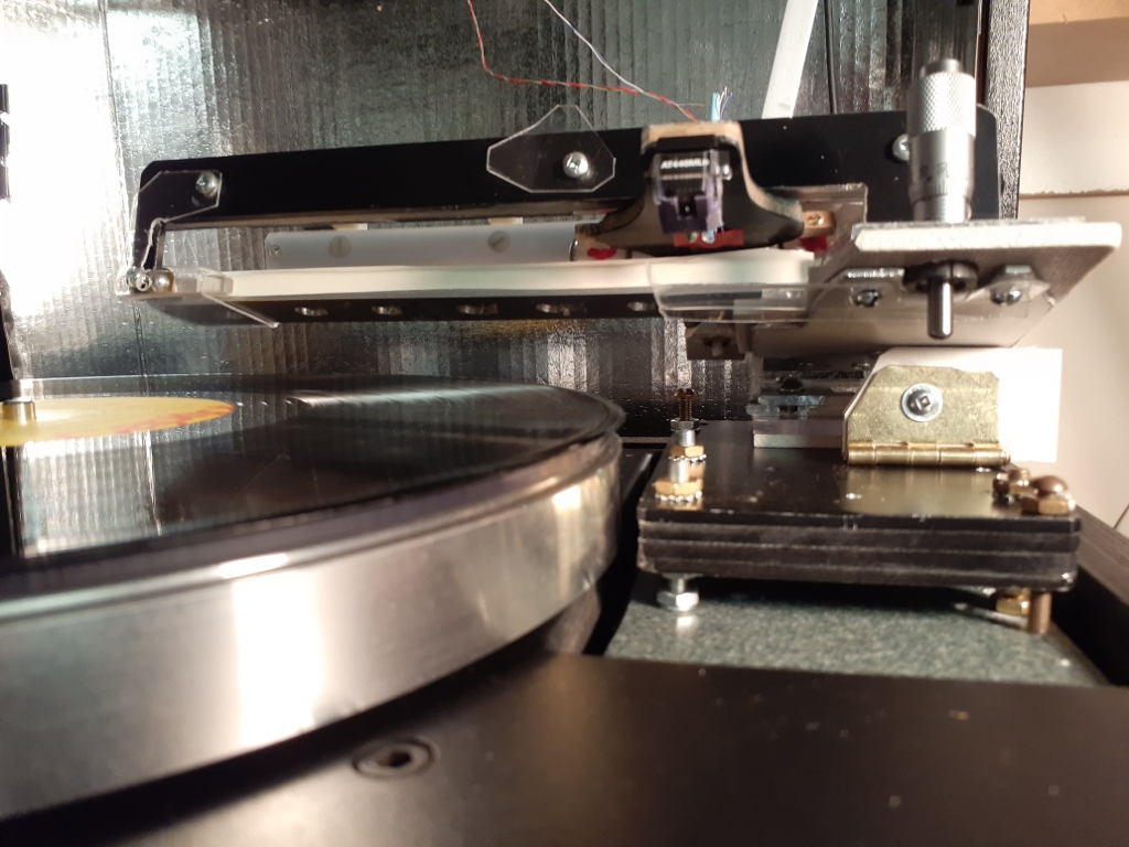

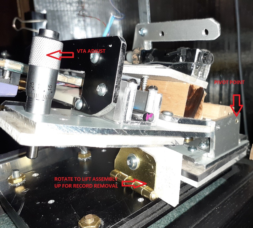

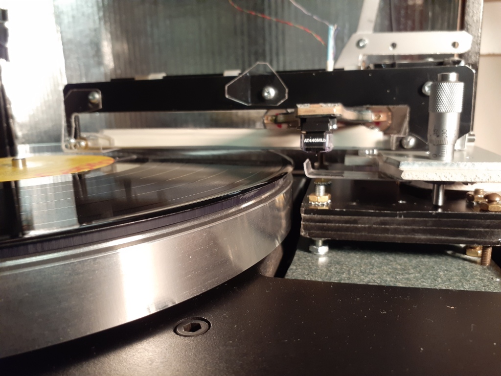

My TT has a suspended Platter and Armboard, which cuts down on my options for attaching the LTA. So, I have a pivot at the back which lets the entire assembly swing up. This allows easy record removal.
I would have preferred to use a tight 2-1/2" hinge for the pivot, but could not get out during the Covid period.
The Vernier in the front sets the Vertical Tracking angle. It can be adjusted while the record plays.
Please excuse the prototype appearance.
Hugh

massive horizontal mass (why to move the entire rail instead of the train? usually it's used the opposite)
horizontal torque asymmetrical and magnified by an absurd lever arm (arm length + increasing rail length)
vertical torque (completely absent in all LTAs) due to the unbalanced weight, as the stylus advances during the tracing.
Maybe with air bearings it can still work, but it doesn't seem to me the smartest idea around. But ask Jim, on his thread, for a qualified expertise, I have never used air bearings
ciao carlo
a sliding or rotating rail is not so uncomfortable, or difficult to build. See Warrjon, or Niffy, or other well known solutions

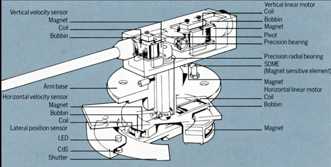

What I was really talking about wasn't so much of tracking error per say of pivot vs lta. I was really referring to the technology that these vintage japanese turntables employ to counter warps and off center records (hence the need for damping) and this is why I believe what you have mentioned, a short and stiff arm would be good. If you look at sony LTA tonearms with Biotracer, arguably the PS-X800 was their best. I believe some tonearms made today like WTL LTD utilizes silicone gel for damping to make it stiff mechanically. But when we study through the history of japanese tonearm makers, you can see that they've migrated from using silicone fluid as damping to using electronics (sony first to be there, then jvc and denon and despite the former 2 dropped off the tech, denon continued through year 2000). It is believable this tech was dropped off due to rise in CDs not because of the technology being inferior. I've attached a picture below of the internals from the tonearm that utilizes this.
What intrigued me was because of the possibility of these tonearms that may be the best and there's no need to look further and modern tonearms may not come close because they may not have the capability of these japanese giants as these tonearms are all controlled by a microprocessor. Any thoughts? I would love to see measurements being made on these tonearms. I believe Sony PS-X800/ Sony PS-B80 may be their flagship with Denon DP-59L being the most advanced electronic damping (albeit a pivot than being a LTA compared to Sony).

Yes I have a vintage Technics EPA100 and it out performed my Rega RB808 by a significant margin.
The EPA100 also has VTA on the fly and dynamic damping, all lacking in high end Rega arm
The only vintage Japanese LTA I have heard was my mates Revox LTA and my LP12 with LVV and K9 at the time out performed it, this was in the 80's.
