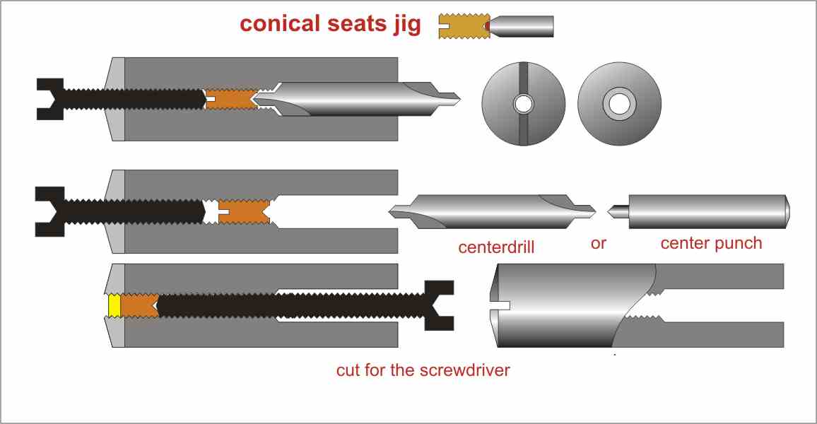

Looking for excuses for not building a TT (...the last thing i will build) i am starting the Lil Casey MK3; beginning from the most boring small parts, such as the eight pen-tip seats. So I decided to finally make a better jig to get them quickly and precisely. (attachment)
A center drill (new) or a diy hardened punch is used to make the seat, then polished using the usual paste and the center drill itself, in reverse rotation. The jig is also used to make the cut for the screwdriver. The most useful detail is the counter screw to block the piece during processing.
Another recent discovery: there is a glue, the so common UHU Extra, which dissolves with alcohol instead of other solvents that damage plastics or paints. Very easy to remove even after a long time without any damaging
Don't expect a great glueing power, but it is very useful to block the cabling of our arms, or to increase the insulation of the very thin enameled ones that we use for the linear ones.

Are you using brass for the seats? Do you use stock threaded material or do you make the thread yourself? Wouldn't it be easier to buy some allen pinols and then just make the V in the seats, still using the jig?Looking for excuses for not building a TT (...the last thing i will build) i am starting the Lil Casey MK3; beginning from the most boring small parts, such as the eight pen-tip seats. So I decided to finally make a better jig to get them quickly and precisely. (attachment)

Yes 2,5 mm stock brass screws, then cut to needed measures. As holder i thread inside some 3,2 mm copper or stainless rivets, cut to measure.
Using pen tips my case is somehow different than using carbide pins: the 118° angle of the center drill is good for me, and I don't need a mirror finish since the rotation is inside the pen tip, not against the seat. What I need (maybe like you) is a perfectly centered seat and for this is crucial the counter screw that avoids completely the screw play while drilling (relevant % with such small diameters) inside the jig's threading .

Using a good, new center drill helps to get a good finish. Better to make the seat with a hand drill, electric tools are too aggressive

I see. I still think that I could use pinol screws ,with the same jig (good idea with the rivets), and just make the seats in them with the center drill.
A lathe would be ok to make the finish, right??
I used M3 cupped set screws these are high tensile. Made a forge from an old drill to make the radius in the Vee. Pins were made from 1.5mm drills cut down.
Then the the whole lot was polished down to 1micron with diamond paste.
Allen pinols are an easier solution for sure: but difficult here to find in 2,5 mm, impossible of brass. To make the screwdriver cut is just a matter of a minute, and shows you the screw tightening position for benefit.
But the needs for the Lil Casey parallelogram with pen tips are quite different from your carriages.
carlo
the jig is made on a lathe of course, but to make the seat a center drill, simply hold in small chuck pushed by hand gives a better feel. The way of watchmakers

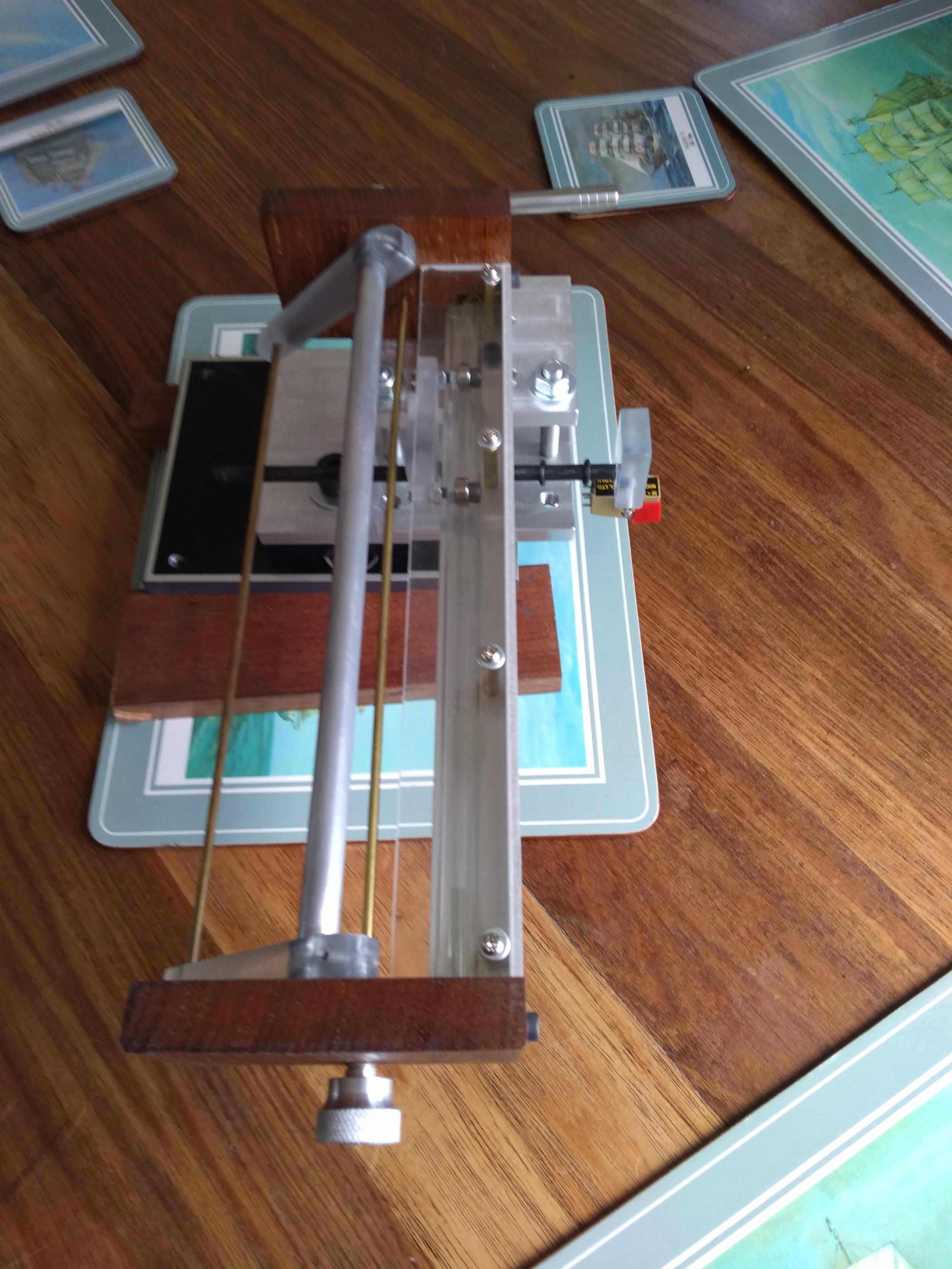

How are you planning to make the rail? New ideas of a non tilting design?
Hi Carlo,
Just wondering, is the VTF of the Lil Casey consistent from outside to inside of the LP, I would have expected VTF to increase as the cartridge moved away from the vertical pivot.
I'm still struggling with my carriage mistracking on off centre pressings, as soon as I get my milling machine up and running again I am going to make a new lighter carriage.

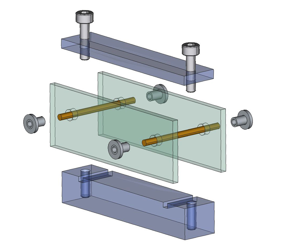

jig sequel
... But once built perfectly centered seats, even more important is the jig to align the threaded supports, just to avoid #3622 - 27 issues ...
Here is mine (attachment): one block grooved to measure + its clamping cover + two threaded bars.
Holes for threaded rivets are drilled 2-3 tenths wider. Rivets, glued with epoxy are then screwed into place. It will be the epoxy to ensure and maintain the correct alignment.
Nothing new, Koldby, I'm slowly trying the #3528 - solution C - that showed promising measures and behavior.
Somehow reluctantly because L C mk2 plays really good, practically with no tilt at all, once set up dynamically for a specific cartridge + VTF. And with the strange feel that often it's easier to go back than forward.
il fren dell'Arte ... we say here
Hi Warren - the Lil Casey is based on two simple concepts, so trivial as to be counter intuitive
the radial rail #2355 - and where should a linear arm rail be positioned? why keep it at a distance?
the parallelogram scale #2384 (well, half parallelogram scale) - Someone calls it "Robertval" (?) but Romans used it 2000 years ago and who knows who else before - no one may joke with the weight of the goods - .
The topic was further discussed with Walter (#3013) in posts #3015-17-19-22-24 with some sketches and calculations.

If I am understanding this jig correct:jig sequel

The two side plates are the ones used in the tonearm. The jig is to ensure that the rivets are glued in place so they are parallel with each other and 90 deg to the plates and exactly in line with the rivet in the opposite plate. Right?
Well, after reading this thread six months ago (and taking 6 months to actually read it all!) I completed a prototype quite quickly (about a week) whilst 'locked down' based on what I remembered from this huge thread.
It's basically a glass railed, two wheeled version, using 12 x 2.5 mm open bearings washed with IPA, and an acrylic / CF sled, fitted to one of my own design / build DD turntables and the thing is IT WORKS!!!
As I said, it's very much a prototype and I'll be building another one based on what I've learned along the way, and leaving out the errors! I want to incorporate pin bearings on the next one, even though the 'washed' bearings seem to work well and move freely with very little stylus deflection (though I appreciate this is also a function of the all up sled / cartridge weight) and I get very little mistracking (I can play whole sides without any skips, and on the rare occasion I do get a skip it's usually contamination of a rail as they're uncovered.
What I would like pointers with if you dont mind is a cueing device. I tried a Rega one as I had one lying around, lifting a CF tube above the cartridge, but obviously the throw isn't great enough. I'm considering an over-centre cam operating a tube which will push down on the rear of the sled. Does that make sense? How have you guys done it?
Anyway, thanks for so much excellent information and guidance, it's been a massive help! Some pics of my prototype attached. The other arm is a 12" unipivot also of my own design, for use when alcohol has been drunk as without a cueing device, the LT is a PITA to cue by hand
If I am understanding this jig correct: (.... ....) Right? (Koldby)
Right!
In the L.C. carbon the threaded alignment bar was inserted directly into the support tubes of the pen-tips on the parallelogram levers (that's why the M2,5 mm). This way may be simpler and even applicable to your carriages (schematized in green). Maybe because of my bad lathe (or inadequate skill?) i learned at my expense to rely much more in the matching of parts than in precision up to thous.
For example now I've understood that by pushing the seat in the threaded jig with the counter screw the clearnce is axially canceled by the taper of the threading itself, and this is exactly what happens during use, when it is pushed by the pen tip (mounted elastically).
Seems exaggerated, but at this level of measures a minimal off-center not only grows the friction, but above all makes it irregular, which is even worse.
carlo
Great looking arm.
The easiest cuing device is to push down on the back of the carriage. This is a pic of my first arm the 10mm aluminium tube holds the cuing mechanism, which is just mechanical using friction to keep the cartridge up.
