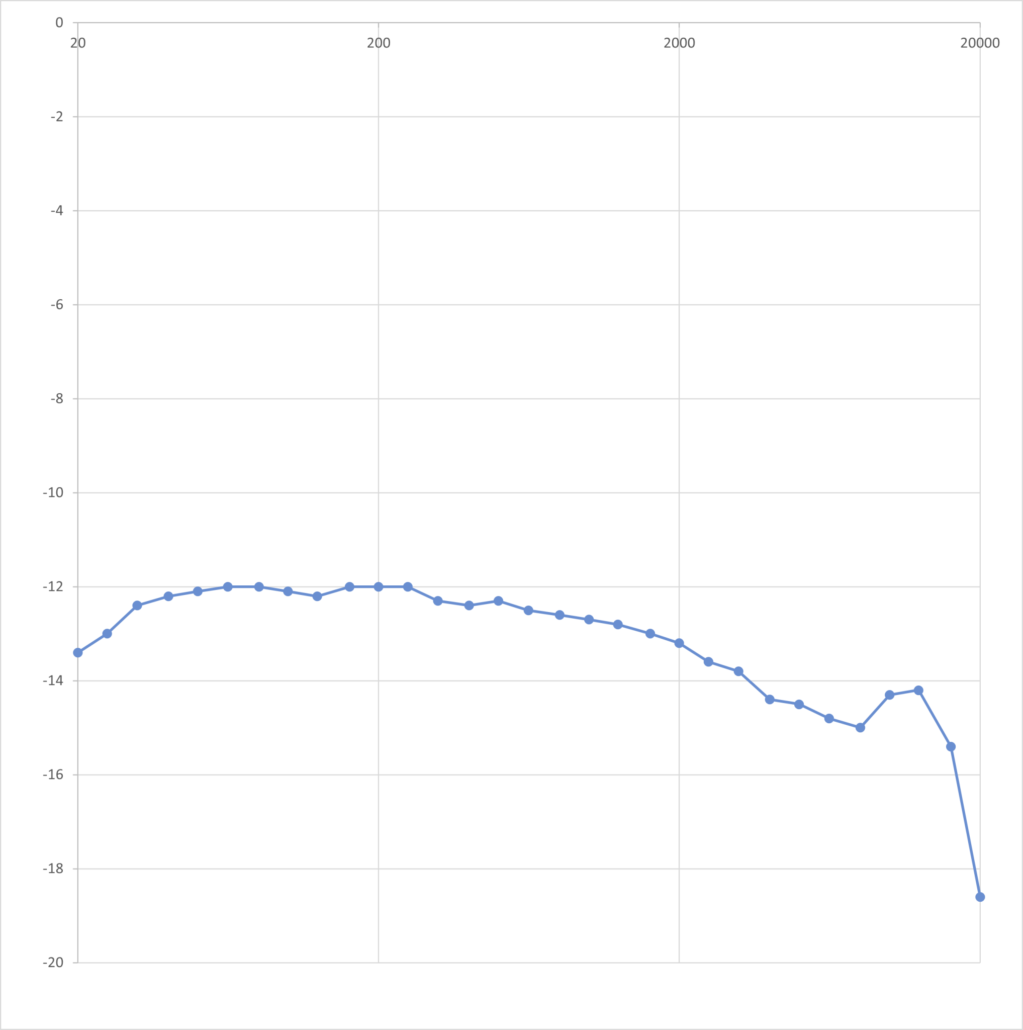

@Mike56 the anomaly at 160Hz is about 0.5dB which could be environmental, I would not spend time chasing it at this point.
The plot looks pretty good and is approx +0.5dB / -1.2dB until 16kHz.
With the resistive load testing I would start with a load of 10kR and work up. 13kR in parallel with 47kR will give you close to 10kR. Keep in mind lowering the resistive load will drop the level of the whole plot. I would use a 1kHz tone to normalise levels between different loads before you run the pots.

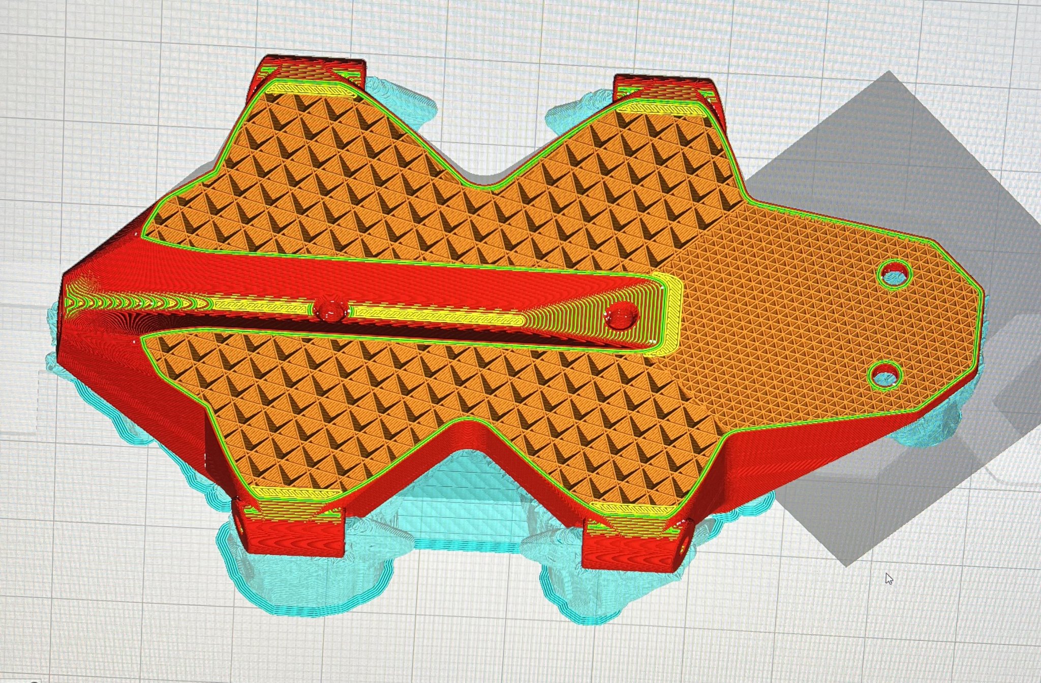

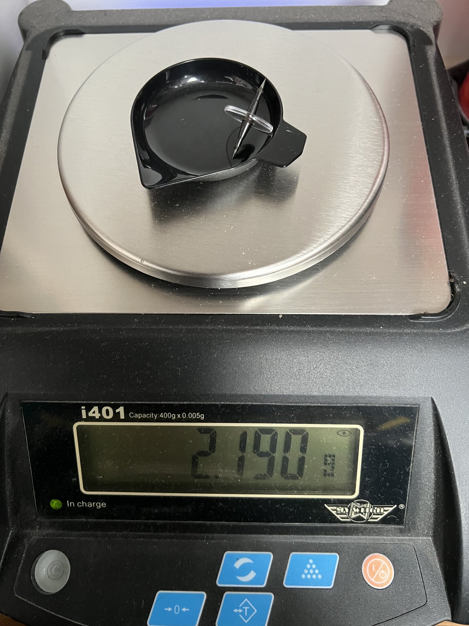

Wheels are now complete, total weight per wheel/axle = 2.180g very pleased with this weight saving. Having a go at proofing the carriage with two different infill densities and patterns. Triangles at a higher density which should give higher compressive strength at the cartridge mounting holes and cubic throughout the rest which should give some nice triangulated forms within.
Wheels/axles 4.36g
Sapphire vees and mounts 2.59g
Cartridge 7.2g
Carriage 26g
Total before CW and ballast = 40.15g
That leaves me with 15.85g to play with for CW and ballast.
Hopefully going to hear something soon!
S.

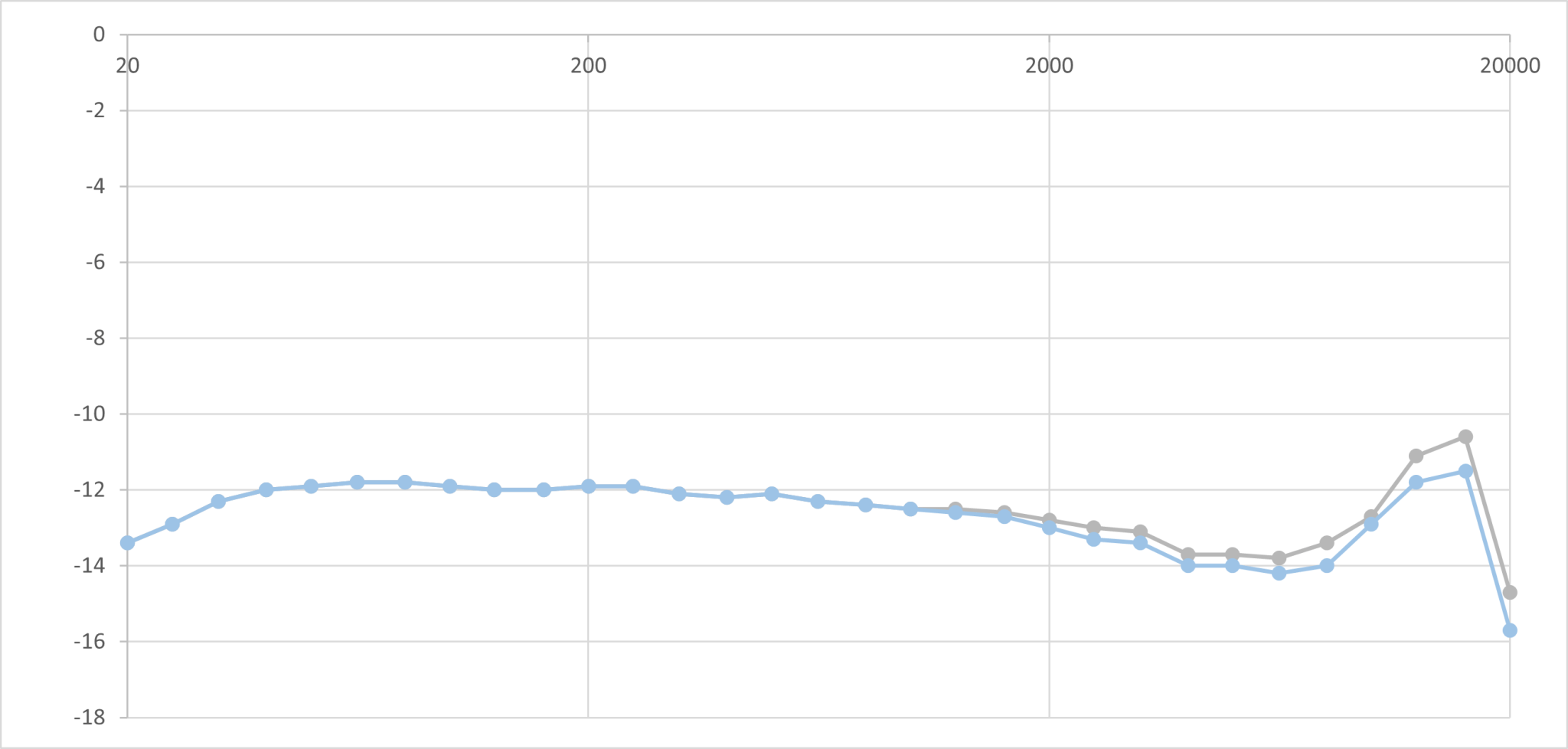

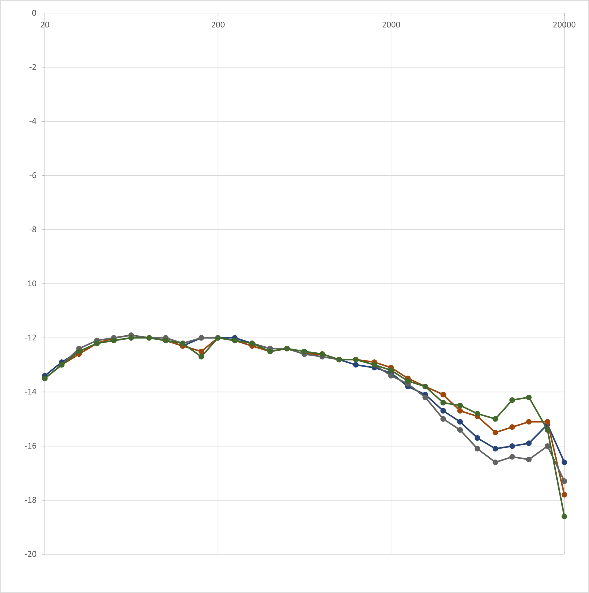

OK, so I removed all external resistors so R remains at 47k
I only have the two pairs of capacitors so added 100 plus 220 = 320pf
A logical progress is demonstrated as per attached graph…….
Lowest in treble area grey is 0pf
Next up blue is 100 pf
Next up red is 220 pf
Next up funny murky dark green colour! Is 320pf
Nothing wrong with the shape up to say 10kHz as I see it, it would be nice to spread the trough and peak right and smooth it, which I read would happen with increased resistance across the inputs, but I have to go into the amp to do that…..
The 160 Hz trough is quite an unstable reading, some resonance or vibration artefact?

Now I know why it is useful to be able to plot a frequency response!!!!!!
Soon after changing the capacitance, I was taking a look at the various parts of the RTA, applying test/check lumps of blue tack and found the 160 Hz anomaly in about 10 minutes!
I have now coated the lift arm in black tape, the heat shrink I was going to use was just too tight but that would probably be an incremental improvement for the future.
I have now replotted the curve because it was obvious it now stays flat straight through the 160Hz point. So below 1000Hz the curve is within 1dB now. i did not record above 1000Hz but there were small improvements throughout that as well, shows how one thing can affect others.........
I am sure it is imagination, but the piano sounds much more piano-like now!

Thanks niffy, I’ll look into the FEA. I’ve proofed one carriage and it needs some tweaking. I was a little tight on the tolerance where the rail passes through. It’s funny how things look massive in the CAD program but in reality it’s tiny. I took the chance to experiment with heat treating the print by baking in the oven at 90degC as I’ve heard that this can increase strength in the PLA. It certainly helps but it introduces more dimensional inaccuracies with uncontrollable thermal distortion. Thanks for the info on the CW I was wondering how you did it.

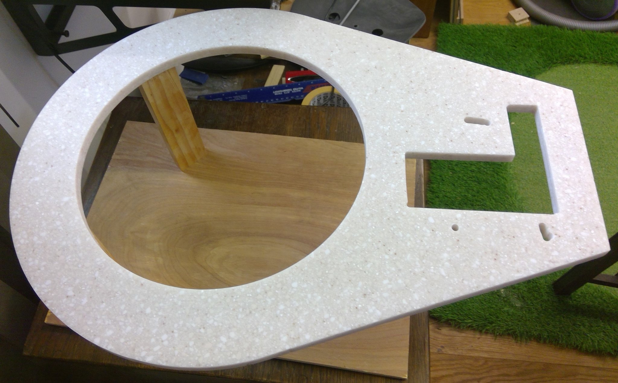

Has anyone used Paxolin phenolic paper sheet for plinths? Contains the magic‘phenolic’ resin, beloved by densified wood advocates. Probably has different damping properties though. @Mike56 i see that you use a Corian type material for your plinth, is your arm mounted on the same panel as your turntable or on a separate piece?

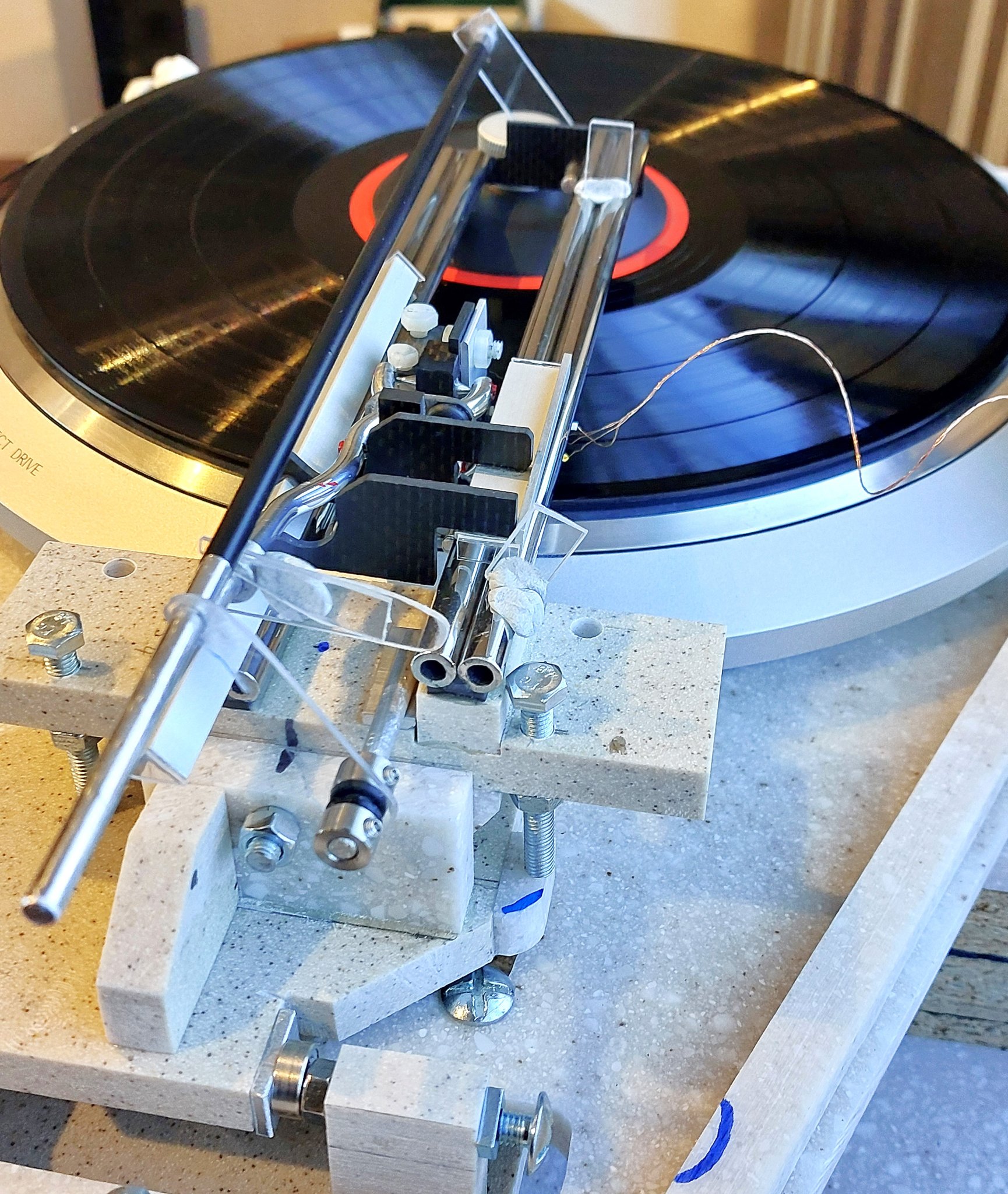

I believe in the Spindle being coupled to the arm, so they vibrate as near identically as possible, and of course as little as possible.
I measured improvements when i did that.

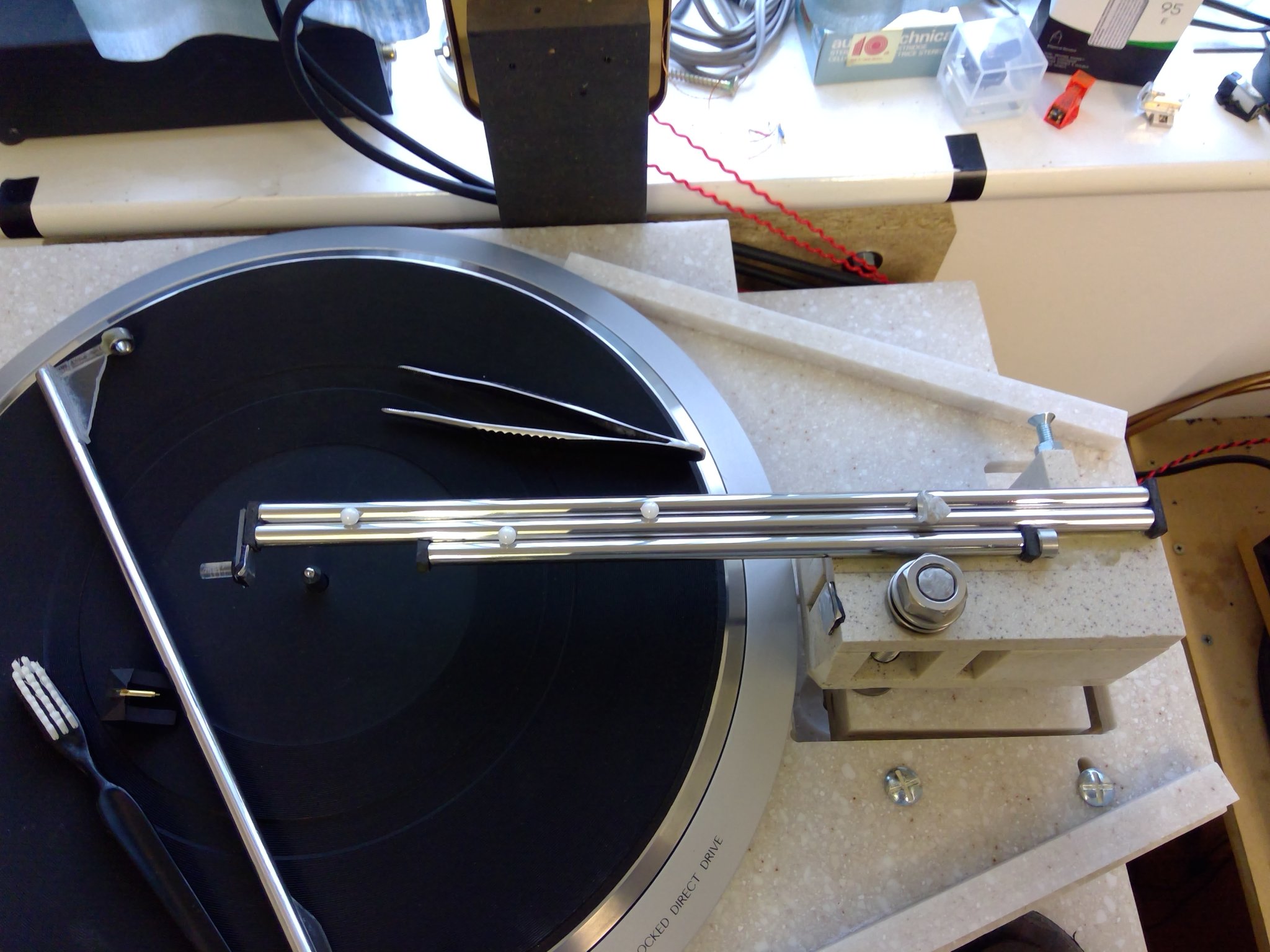

So my arm is mounted on the same base as the TT, its got a hole for the TT and a hole for the arm, an extension of the same thing to allow easy level and height adjustment. here is a pic both as cut and during assembly.
I had read that Corian type materials could be good and had some, i also read about true CLD. i don't believe my use of either Corian or CLD are good solutions, its an area i can seek improvements, but i am reluctant to spend what Panzerholz or similar would cost, so seek a magic simple DIY solution!

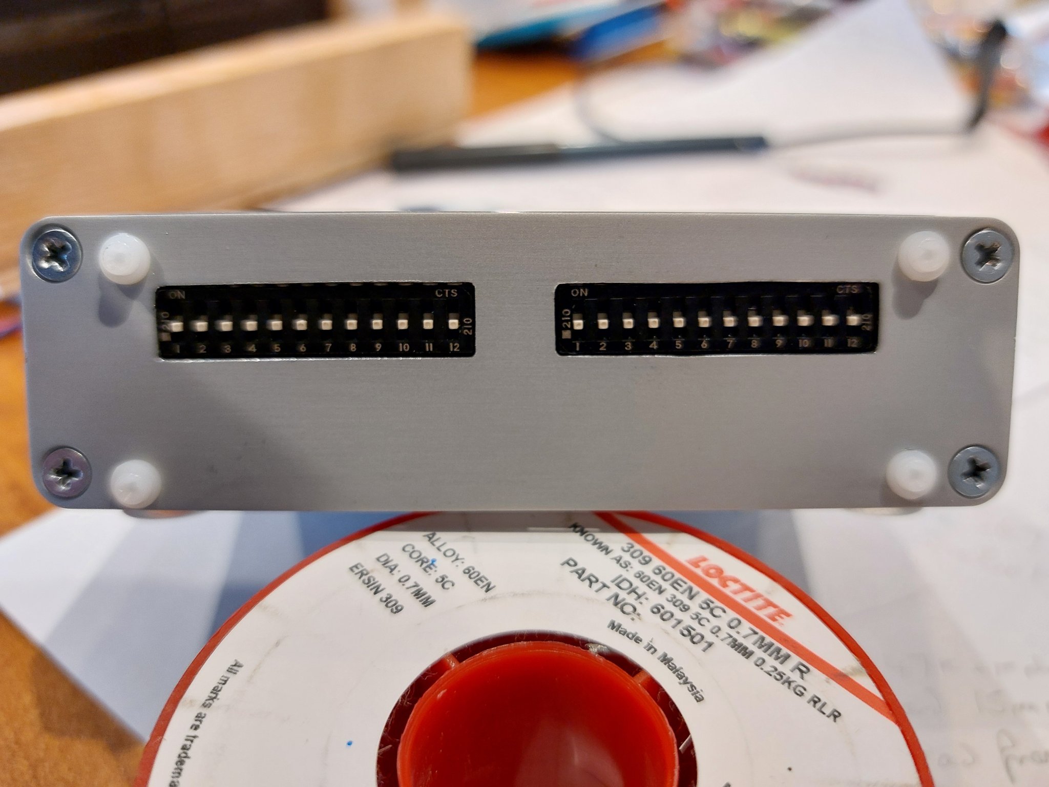

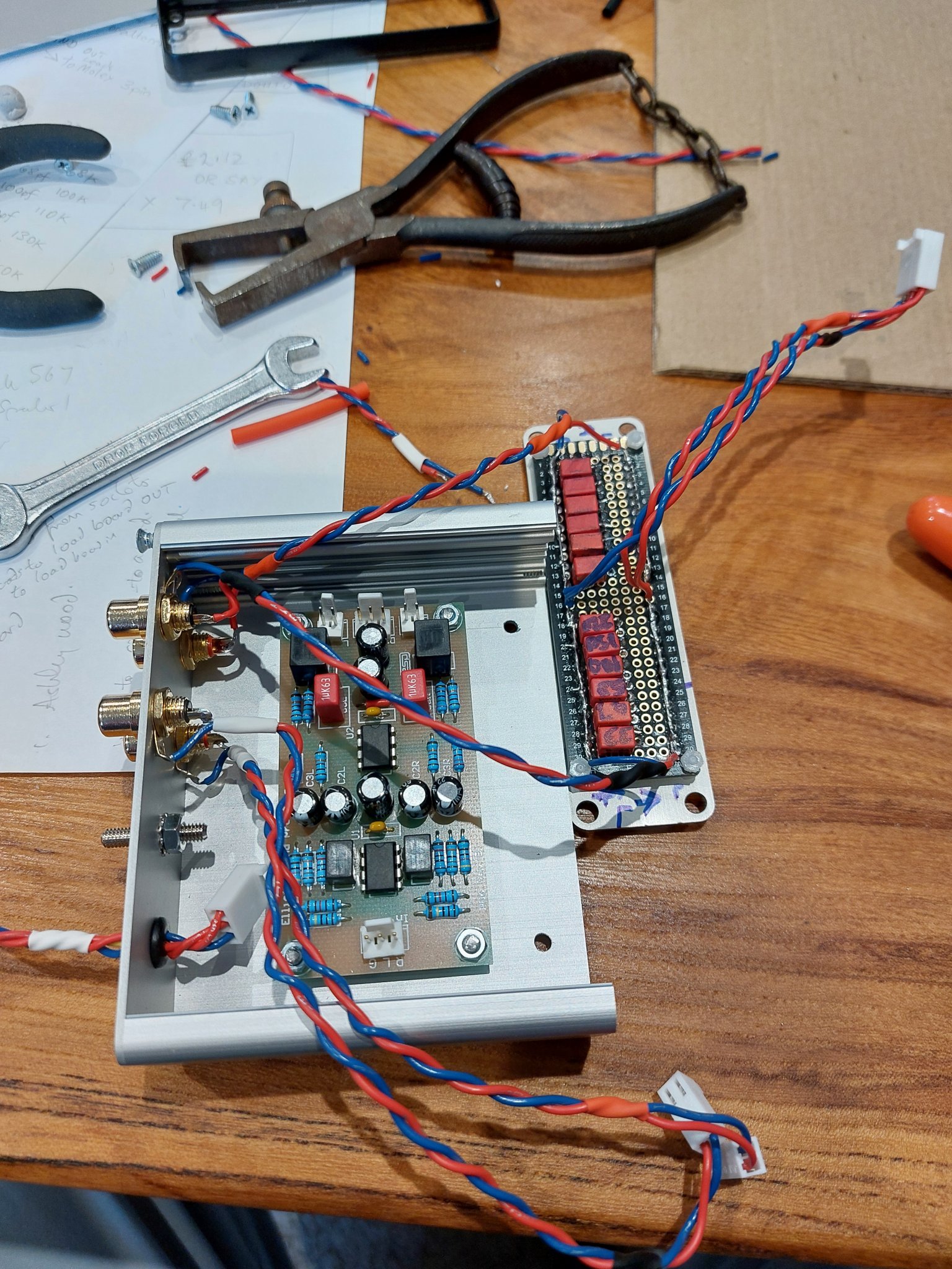

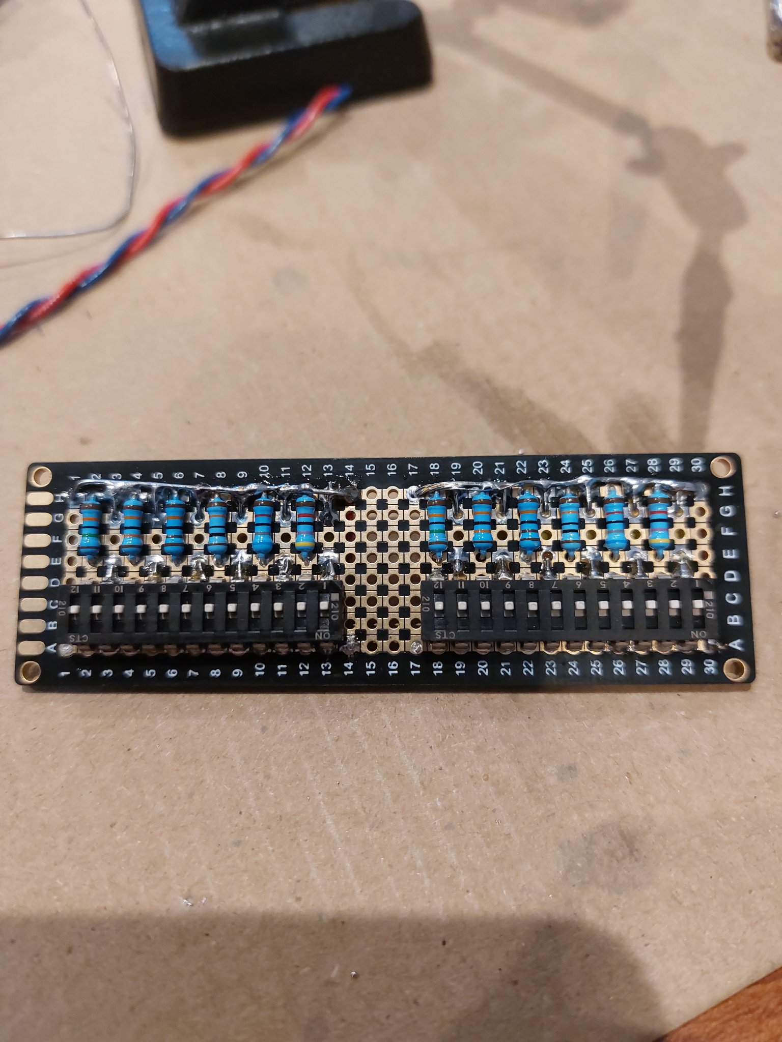

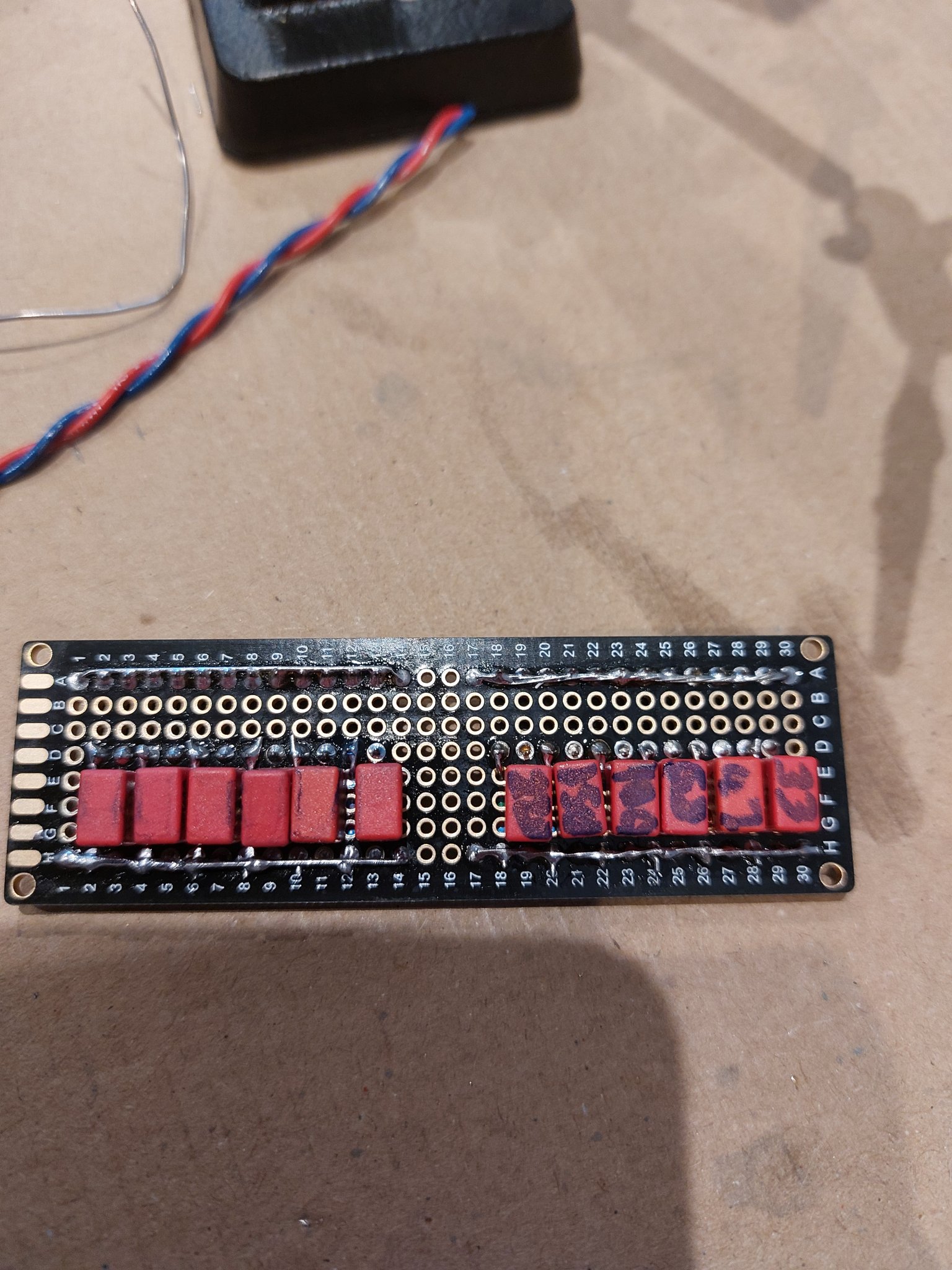

Going back to when i minimalised the output wiring i have now completed my project to incorporate an input loading adjustment in my phono pre.
Various contributors gave me help, support and encouragement, many thanks.
Whilst initially it seemed easy enough i learnt a couple of things en route.
Spare space in the case is useful, it ended up a bit tight to fit!
Prototype breadboards with lands you can bridge with solder don't work for me, the gap to bridge is tiny, but try as i might i could not achieve a bridge so ended up wire bridging all the connections, which is not tidy.
However, that aside, here is a picture of the construction and two DIP switches in the case, this gives me six capacitance and six resistance options on each channel, - an almost infinite number of combinations, but only a few relevant to each cartridge.
Having now run the experiments i can get 20-16,000Hz at less than 3dB variation in a couple of ways, but its clear, from what i can see, my Technics 205 likes to see 220pf plus whatever is in the cables and 85-100kOhm resistance.

And happy to say i believe the sound is better, clearer vocals etc.
Which allows me to revert to the subject of the thread, it allows my RTA to sound better!
More to the point i hope to use the new (to me) measurement technique to search further improvements, i found one vibration en rote already.
