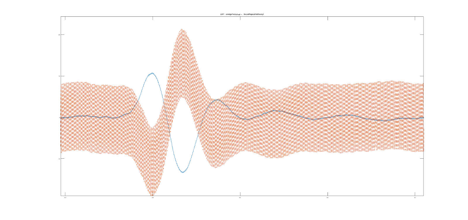

Horizontal stylus deflection can be derived directly from the cartridge signal. If you use a flat response preamp and capture the signal with a DC coupled or very extended bass response (2 Hz) computer sound card line level input or USB interface the signal can be integrated to produce a displacement value. The cartridge output voltage is proportional to stylus velocity. I did this with my Technics SL-5Q linear tracking table and found that I had misadjusted the feedback on the servo drive of the tonearm carriage. Playing a test record with a 1 kHz 5 cm/s track allows for calibrating the displacement.
1 kHz 5 cm/s tone in R channel no signal in the L channel from Ortofon test record. R channel is dashed line, producing the wide pattern. The horizontal graph ticks are 0.1 seconds. The vertical axis ticks are at 10 um. Displacement calculated by integrating the cartridge output and scaling to um. The large slow waveform is about 12 Hz and low damping, corresponding to the tonearm-stylus resonance for side to side motion of the cartridge.
So this waveform was due to the carriage drive pulsing the motion of the arm about every 1.5 seconds rather than moving it smoothly. After making adjustments this was reduced. The curves go in opposite directions as the left and right channels measure horizontal motion in opposite polarity.
It would be great to see this kind of measurement for the DIY arms. Until I started making and documenting measurements I could only guess at the performance of my tonearm. I think it would be fun to design a linear tracking arm. I would like to make it as simple as possible and leverage 3D printing for many of the parts. I will have to work through the few hundred pages of this thread.

Hi Mike, I'll try my best to explain. I started digging into this three months ago for several hours a day, so it isn't obvious.
Inertial navigation systems are used on spacecraft, aircraft, and your phone to track position for navigation. These systems use an accelerometer to measure acceleration at a high sample rate. The acceleration values are then integrated twice to produce velocity and then position values.
A simple integrator for a stream of data samples is implemented by multiplying each sample by the sample interval time and then adding that to a sum. This summed value will grow or shrink with positive or negative sample values, such that the sum will be equal to the area under the curve or the integral of the input signal samples. If you measured the frequency response of an integrator it is a sloped line that drops 6 dB per octave with rising frequency such that it has infinite gain at DC and zero gain at infinite frequency.
The typical phono cartridge produces a voltage by moving a magnet in relation a coil. The voltage induced in the coil is proportional to the velocity of the stylus that is moving either the coil or the magnet in the cartridge through a lever. The coil and magnet system for the left channel are wired to produce a positive voltage proportional to the motion of the stylus at 45 degrees moving upwards and towards the outside of the record. So an upward slope on the inside groove wall will produce a positive L channel signal. The right channel coil is wired to produces a positive voltage for motion of the stylus downward and to the outside of the record. So a downward slope, or falling into a depression in the outside groove wall, produces a positive voltage on the R channel.
So to calculate the stylus displacement, the voltage from each channel, proportional to velocity, can be integrated (summed) over time to produce displacement values.
To orient the displacement values to be positive for upward motion of the stylus from both channels, the signal from the R channel needs to have the polarity reversed as it's velocity is measured with positive polarity for downward motion.
To isolate the horizontal motion of the stylus the L + R channels are summed. The horizontal values add and the vertical contributions being of opposite signs cancels.
To isolate the vertical motion of the stylus the L - R signal is formed. This subtraction cancels the horizontal motion from the two signals and sums the vertical signals. Both of these are a 45 degree coordinate transformation.
To produce the plot I show in my earlier post, inverted the sign of the R channel signal and integrated each signal individually to produce left and right position traces. So a positive value on the graph represents a positive vertical displacement on the record surface, up and to the outside for the L channel and up and to the inside for the R channel to be specific. So for vertical displacement both signals would rise together. For horizontal displacement the signals are identical but in opposite directions on this graph. I was playing the Ortofon test record track with a 1 kHz 5 cm/s tone on the R channel only. So the rapid up and down motion is the signal. The Left channel had no signal on the record, so all the deflection is from rumble or external disturbance of the tone arm. As both channels show a large slow displacement in the opposite direction, this is a horizontal displacement of the stylus. The low frequency matches the expected tone arm resonance.
If the record had mono bass notes recorded on it, they would also appear as low frequency horizontal deflections in the graph. Hopefully I didn't make any mistakes in my description.
