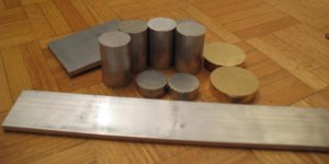

Hello
I just received my material from EPay for my tonearms suspension.
Any opinion about wood tonearm VS carbon fibre or metal..Please!
Did someone com pared them.
I have several material for the arm, I will test them and give some info.
I have aluminium arrow shaft, titanium tube (these only 6mm and 0.4mm wall thickness) but very solid also very light.
I ordered carbon fibre tubes 3K version 9mm with 1mm wall thickness and 13mm with 0.5mm wall thickness.
I would like to get some opinion about the wood arm. Also some info, have to be hard wood or half hard etc.
I have a long 12" drill bit less than 5mm thick I can try to drill some wood and after machined to the right size.
Al do I don't have source (friend) who work or has those machines required.
Because of that I have to make arm suspension on the kitchen table.
Probably will not be so professional I sow some of you done but I use what I have. Cordless drill, jig saw, hacksaw so on...
Some picture, the aluminum for the suspension, the brass 2" diameter 1/2 thick for counter weight.
Greetings Gabor

Hi Gabor,
Even though the suitability or sonic merits of various armwand materials have been discussed here and elsewhere, I'd like to remind you that the bearing design does "drain" (a poor metophor) the mechanical energy generated during playback per rigid coupling to the arm base(board). Almost all of the energy dissipation needs to take place in the armwand/counterweight assembly. Merely relying on a rigid material(Titanium, CF...) will allow for both standing waves and strong resonances to be exited.
Suitable woods combine high enough a rigidity with excellent internal damping(further aided by oil or laquer treatment). CF and particularly Titanium requires some form of damping(i.e. CLD) .
Lastly, a 5mm bore diameter in wood(or any other material) calls for the wiring running though it to be fixated. You don't want it to "flop around" or rattle inside the wand.

Hello
Thanks for the answer!
So I leave out the wood armwand for now. From your answer I understood rigid materials are the favorite with these type of suspension.
My titanium tube is a soft type compare to the regular titanium alloy materials.
These is 99.5% titanium and 0.5% aluminum.
All do soft still rigid enough (like low carbon iron) for armwand and of course light.
About the inside hole in the armwand all the tubes has larger than 5mm hole that is why I taught that can be good if I use wood armwand.
About damping material, silicon gel or oil etc would ad a lot of weight what we do not want here.
How I know I must use dumping material or with out my tonearm still OK?
Can I hear it?
Thanks one more time.
Greetings Gabor

gabby:
I don't think trying to bore through a dowel will be successful. without a drill press or some sort of precision machinery. I've snapped drill bits trying to do that through 4" thick material. You might consider notching a channel out along the length (if careful a Dremel Tool can be used). Then glue some heat shrink or similar tubing into the notch . As long as you use large enough heat shrink, wires should be easy enough to push through the tubing.
You can use theatrical makeup (pure latex) to paint the tonearm shaft. Sumiko sold something called the "analog survival kit", they still might.

Hello
I want to do these way.
First drill a hole with my 12" long drill bit in a piece of 1" X 1" wood. When I'm done after shaved done to the right size with machine.
I think these could work fine.
I use that drill bit many time, and if you go slowly it is possible to use it all the way (12") .
Probably I will try it on some oak wood before I spend on exotic wood.
Let see what happen. I know it take a lot of time but that is why wee call it DIY.
Nannok actually you have a good idea to.
Greetings Gabor
