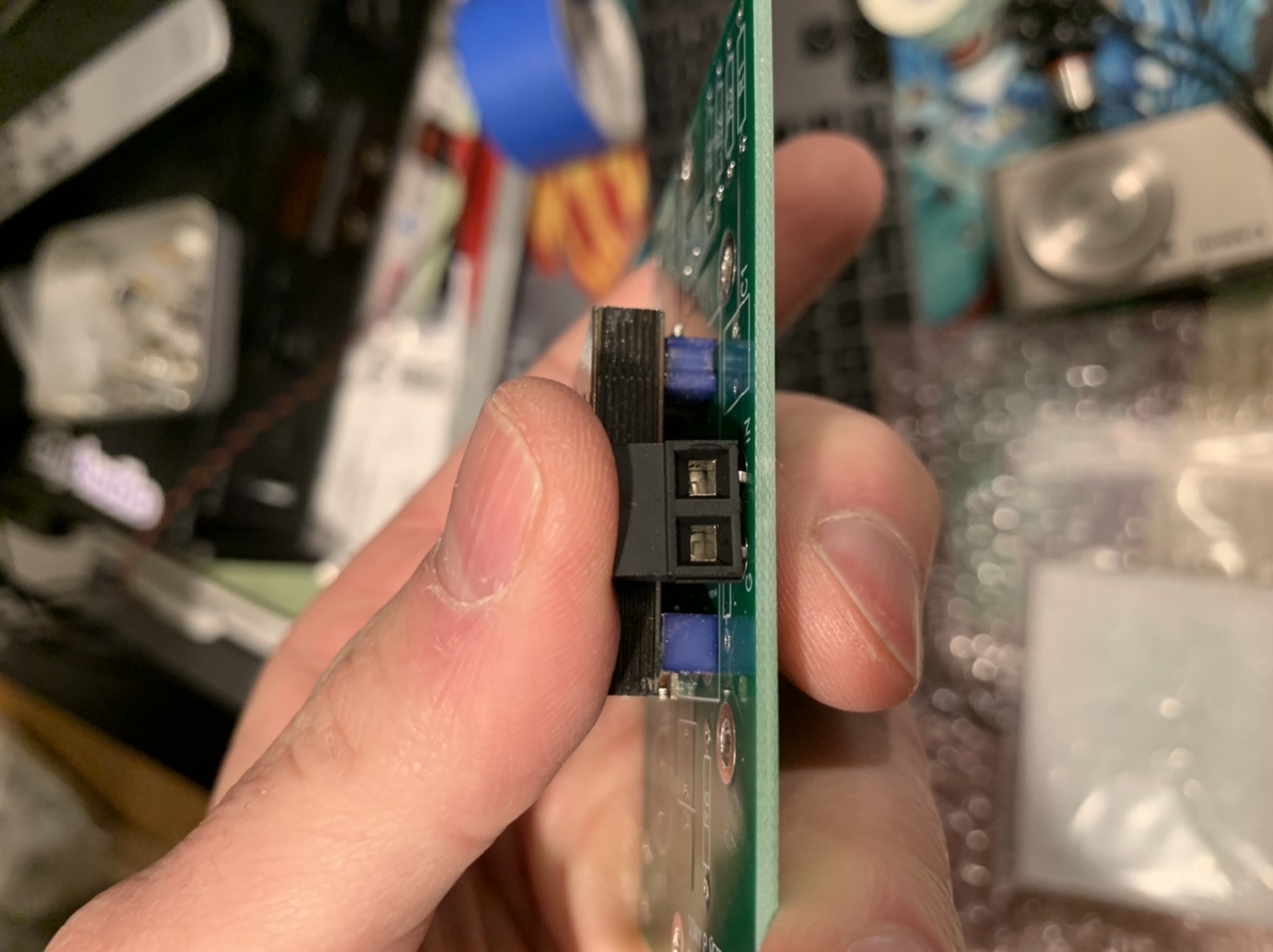

I’m thinking of using some quick disconnects for front end boards to facilitate swapping them. Something like this if they fit.

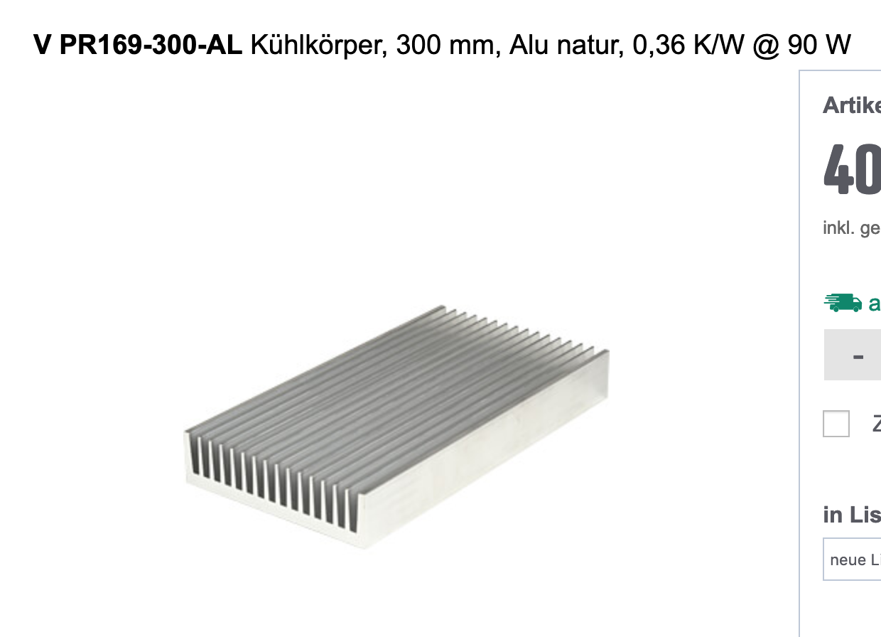

Maybe I want to use those (picture) heatsinks for VFet (approx 60W dissipation per channel) and they should be sufficient when installed properly (fins vertically).
But i want to use them with fins horizontally. Does anybody has experience how much efficiency I will loose. I mean, no numbers needed, but maybe experience from a former build or so...
Heatsink is 300mm x 170mm
tnx, stefan
