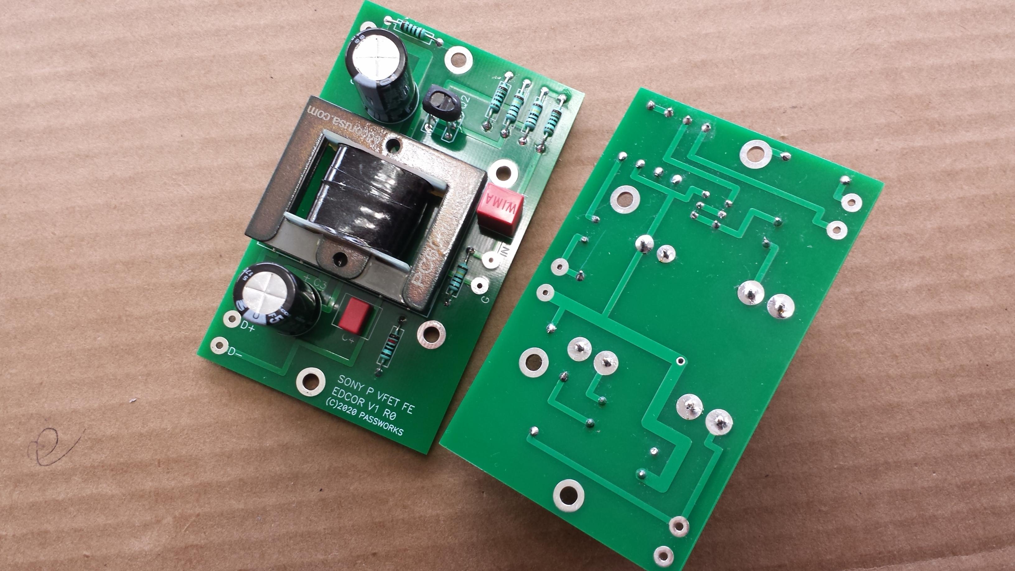

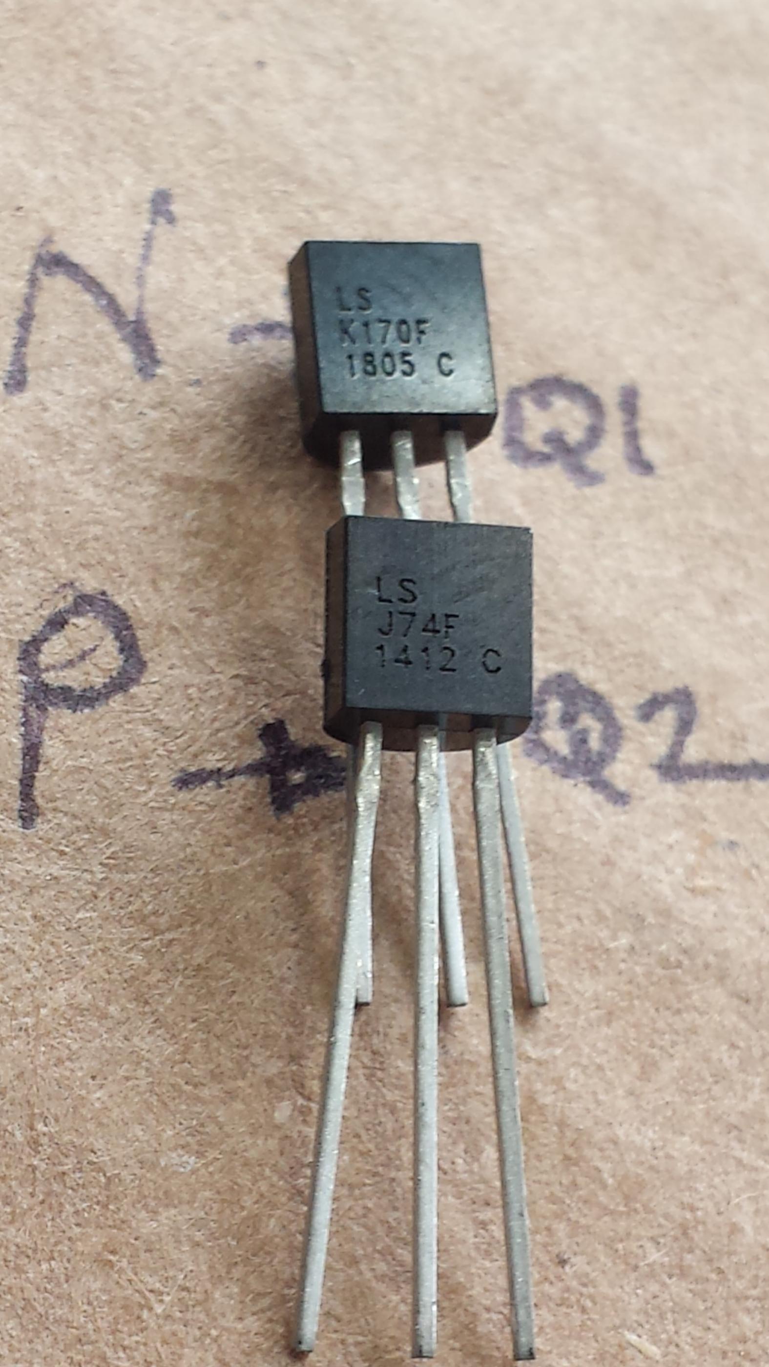

I am now onto the FE cards and my jfets are not the ones in the guide so to be on the safe side I would like to confirm the proper N and P channels of these ones. Am I wrong assuming that these are ok for this build,I am pretty sure they are just trying to not be in the explosive club!
Picture attacked ,thanks.

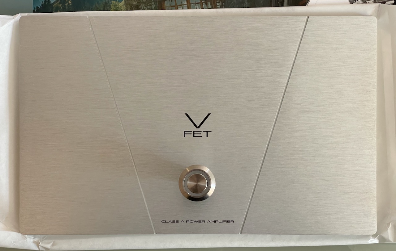

In case anyone is interested, I found some quasi inexpensive aluminum feet that actually grip instead of the felt bottomed stock ones. It visually looks similar and is within 2mm O.D. Of the stock feet.
https://www.amazon.com/dp/B07QL285T...abc_8CXGEJFZQT3EF4XF2TMC?_encoding=UTF8&psc=1
Oooh, I always wanted sand blasting feet. Totally jumping on the bandwagon... Ordered!

These are more than OK, I think! These are the very coveted jfets that will populate most of the FirstWatt clones! I think these are actually "better" than the ones described in the BOM.I am now onto the FE cards and my jfets are not the ones in the guide so to be on the safe side I would like to confirm the proper N and P channels of these ones. Am I wrong assuming that these are ok for this build,I am pretty sure they are just trying to not be in the explosive club!Picture attacked ,thanks.
To get these is a real treat, IMO!
Rafa.

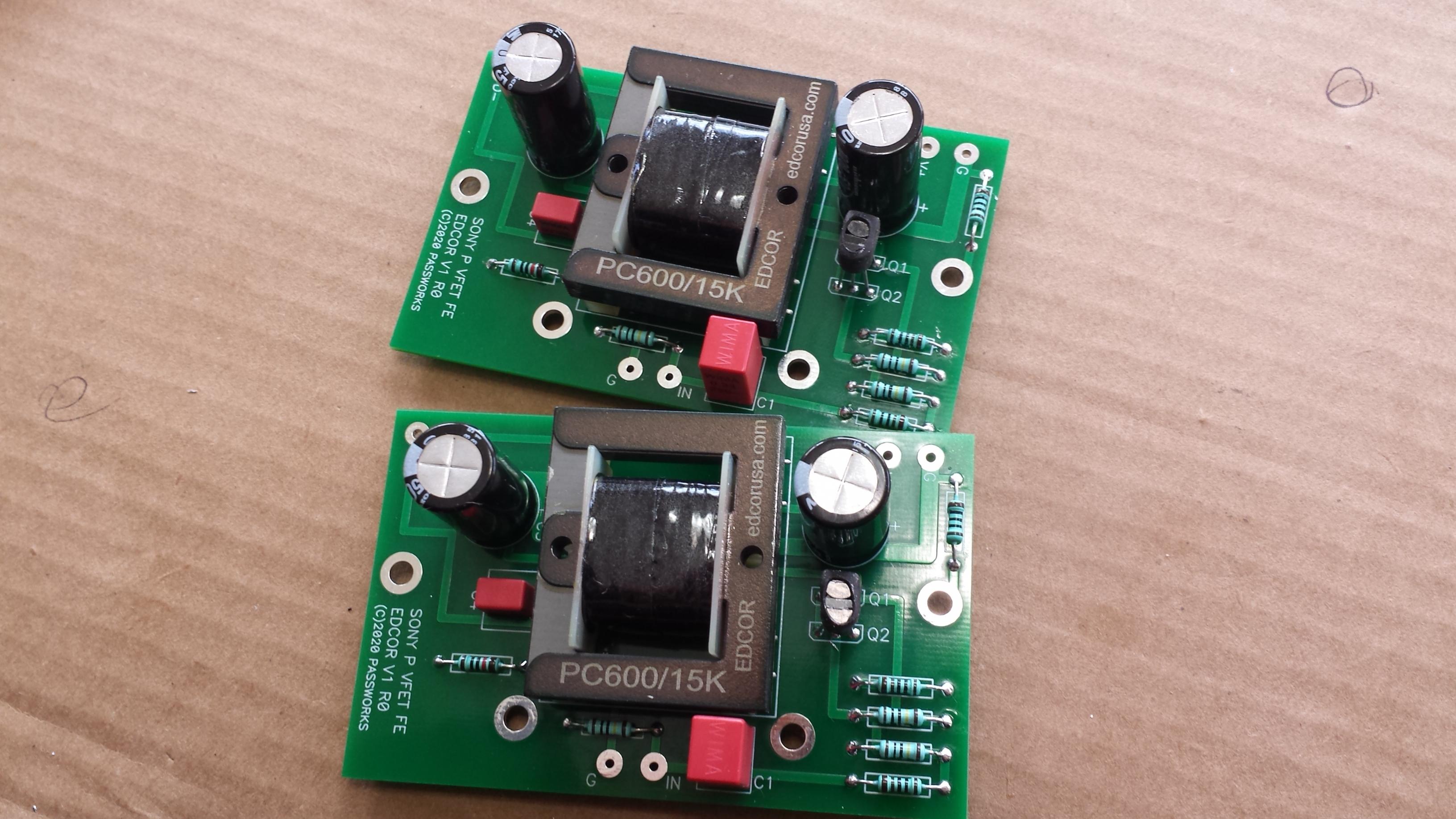

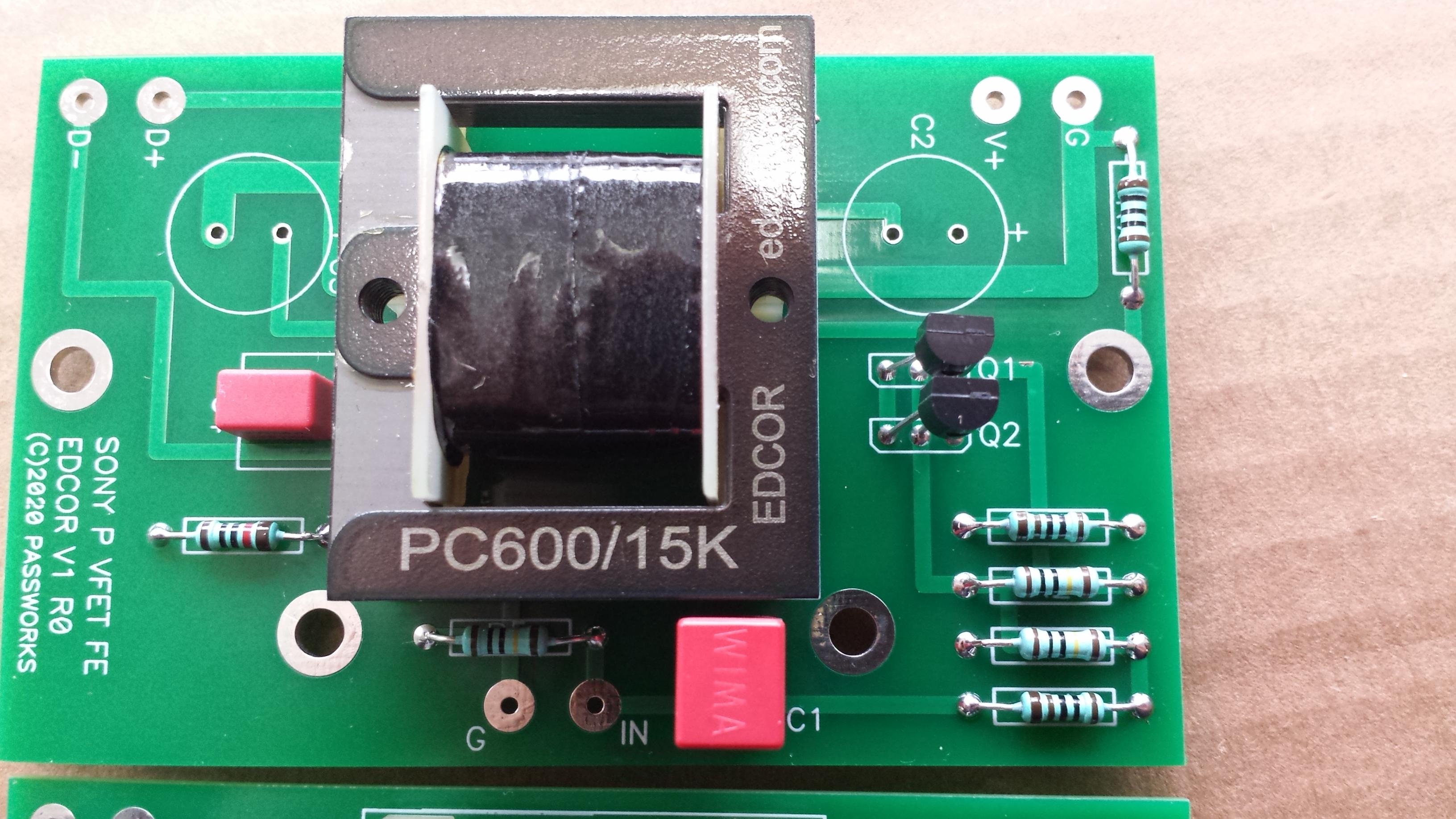

Well that's good to hear I am long overdue for a treat. Here they are soldered in then tucked in a sandwich with a bit of silver paste and my last piece of heat shrink.

Is there a general consensus that it is beneficial to thermally couple both jfets? (even if done front to back?).Well that's good to hear I am long overdue for a treat. Here they are soldered in then tucked in a sandwich with a bit of silver paste and my last piece of heat shrink.
I guess I could put an aluminum sheet between them and wrap them with a plastic fastener. Do you think that would be useful at all? Or detrimental if it is not done 'properly'?
Thanks.
Rafa.
Thanks.
Rafa.
No real point in this design, because the output of the front-end buffer is cap coupled to the transformer. If it were DC coupled at the output, then the thermal drift due to temperature difference between the two FETs might matter, and benefit from a tight thermal coupling.
