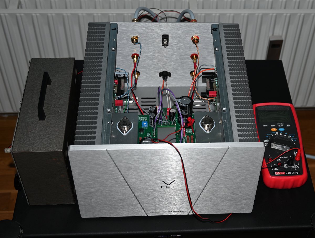

I have now prepared for a re-flow job this evening. Then I also made this modification I have seen other been doing so it is easier to mount again. Then I don't have to fiddle with the plastic spacers.

The solder re-flow was to check if the very faint noise I had in R-channel was caused by a bad solder joint. I don't expect it but I try it out. It is very faint noise not audible with year 20cm from tweeter but L-channel is 100% silent with ear few cm from tweeter. I am just obsessed by symmetry
Then I also made some small adjustments on chassis. Rail adjustment etc. so chassis looks nicer when assembled. Not finished yet.....but almost there......
I was surprised that the nuts that secures the TO-3's to PCB and also should make electrical contact to PCB seems a bit on the loose side......so I made them a bit more tight. Maybe for this job people here talked a lot of torque screwdrivers?

R-channel still makes a bit of "flicker-noise".
They funny thing is that suddenly it is gone and total silence even with ear close to tweeter. Is that the nature of this kind of noise?

It would make sense if this pot is noisy as the wiper of the pot goes to the gate of the VFET. The 20V seems very stable after warm up but pot can still make some troubles it seems. It is not the most funny to unsolder......but let's see.....

In my ACA I had something similar. Replaced all active divices; replaced output resistors. In the end someone gave the tip: the input coupling cap. And yes, that gave that intermittent clicking hushy flickering noise. Replaced it. It was gone. So I'd say: look at C4 (D- input) or C1 grand input or C2 (buffer, unlikely).R-channel still makes a bit of "flicker-noise".

It puzzles me that it is dependent on the preamp (passive you hear it, active not). Then it looks like the vol pot.
imho Trimpot noise is totally blanked out by the C2/1000uF.

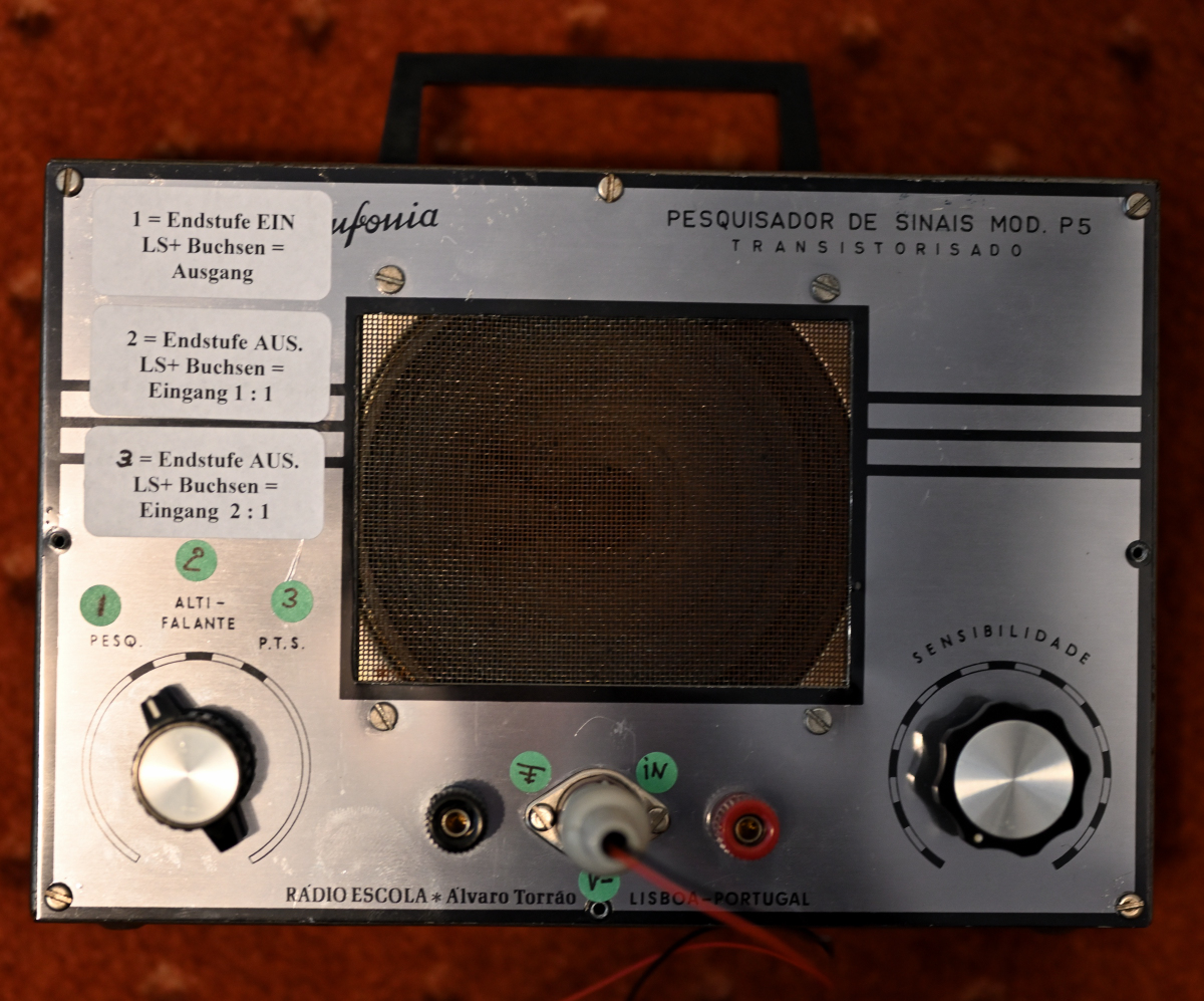

With active preamp the preamp also contributes to the audible noise in tweeter so when the passive was installed I noticed the "silence" apart from the "clicking" noise from time to time. It is the same with input shorted. But to get a feeling for if the noise could be from the trimpot I used my old amplifying device and coupled it to speaker out. Then I can hear the output noise in 5m distance instead of 5cm. Then I "played" with trimpot. And it is very obvious that just touching the white trim screw with screwdriver creates this noise. And of course turning it creates a lot of noise. I think there is a high probability that trimpot is "noisy". It may also explain why noise can come and go.
Think I will get some 25k pots and see if it cures it.
To unsolder the old I may use a SMD "heat gun" which has some attachments that can direct the heat at a concentrated spot.....or is that a bad idea?
The idea was to heat all 3 terminal at same time for a quick easy removal.
