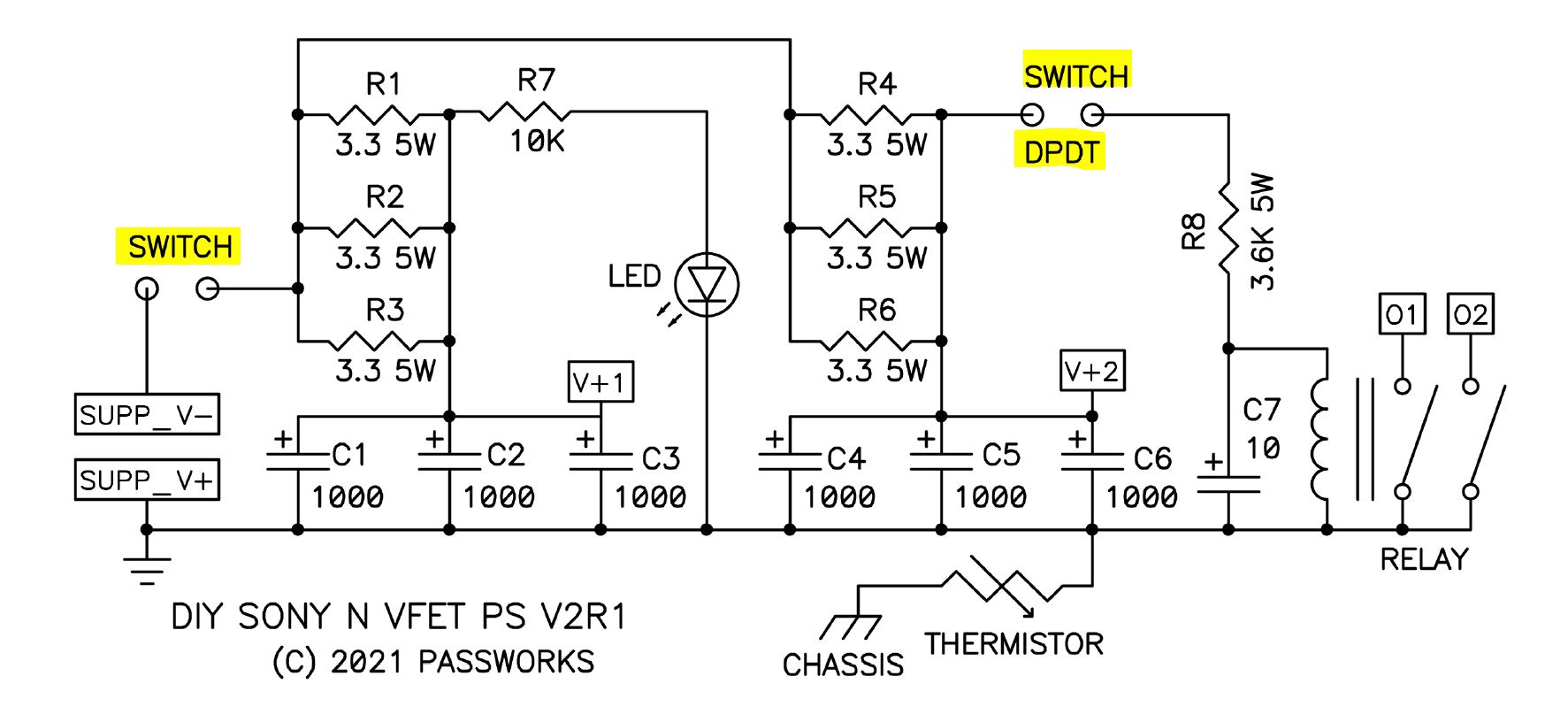

I don’t have any of this amp yet except the article posted above, but if those switches in question need to open/close at the same time, a single DPDT wired to the PCB pads will work… Not sure what the SPST is intended for. I’m sure there’s a logical reason…
I believe those two switches are indeed the DPDT switch. A single switch that has 2 different contacts. So the single switch device covers the 2 switches seen on the diagram.
As I understand it (kind of) one side of the switch allows connects the power into the amp, and the other side allows the relays to ground the speaker output, to prevent the turn on/off “thump”.

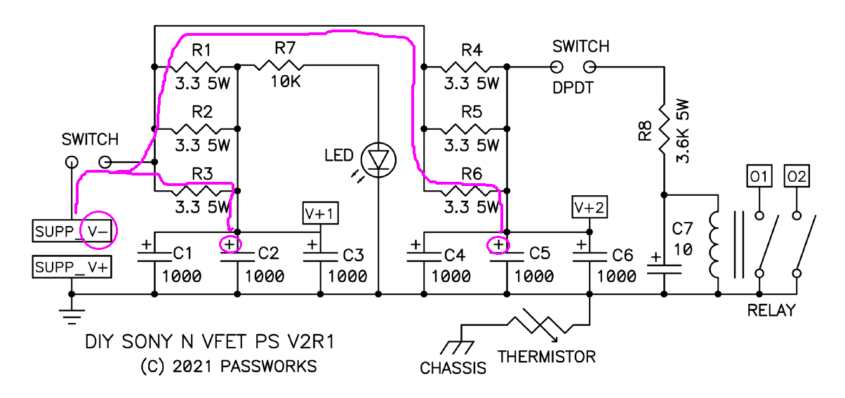

PCB Layout does show both connections are to the Power supply connection. Diagram shows wrong -Ve supply on the Switch. If corrected to + V supply, then single switch will do (SPST) ? to connect Power to these two points
I don't think a single SPST switch will work here. Please note that the second switch is after R4|R5|R6.
Yes you are right - then you really do not require DPDT Switch as it gets supplied anyway from switch 1?

Well, if you don't have a separate switch for the relay ... power for the relay coil will be provided by the 6 x 1000 uF capacitors.
Depending on the time constant / current draw of the output stages, that might not drop the relay quickly enough at switch-off to prevent a power-off thump ...

Yes, I read the article. My only comment was about the switch included in the kit - it is SPST, not DPDT. Probably a mistake...
