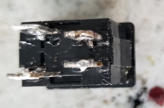

This PSU board arranges the relay contacts to be in parallel with the loudspeaker. While the supply voltage is ramping up (@ power-on) or ramping down (@ power-off), Nelson's circuit closes the relay contacts. This means the loudspeaker(+) terminal is shorted to the loudspeaker(-) terminal in both channels, during power-on and power-off events. And of course the relay contacts are also closed, shorting out the loudspeakers, the whole time the amp is turned off.
I think that amplifier (and speaker) outputs are shorted to ground by normally closed relay contacts. On power on the relay opens these contacts after a delay. On power off the relay imiediately shorts the amplifier output to ground again. Do I understand this correctly?
Usually there should be a protection diode across the relay coil, but perhaps not required here?
