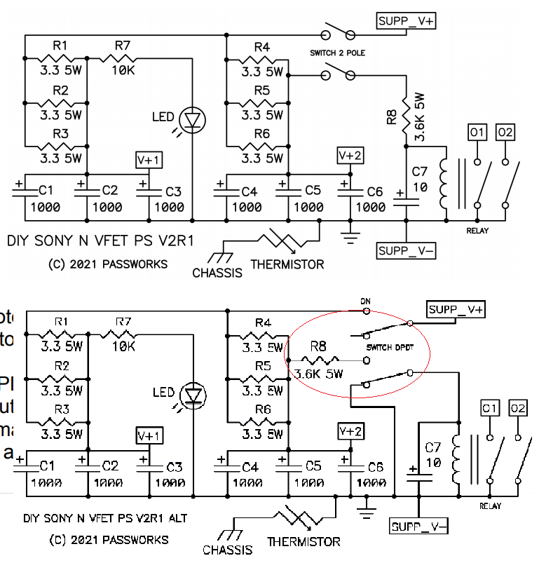

My bad.

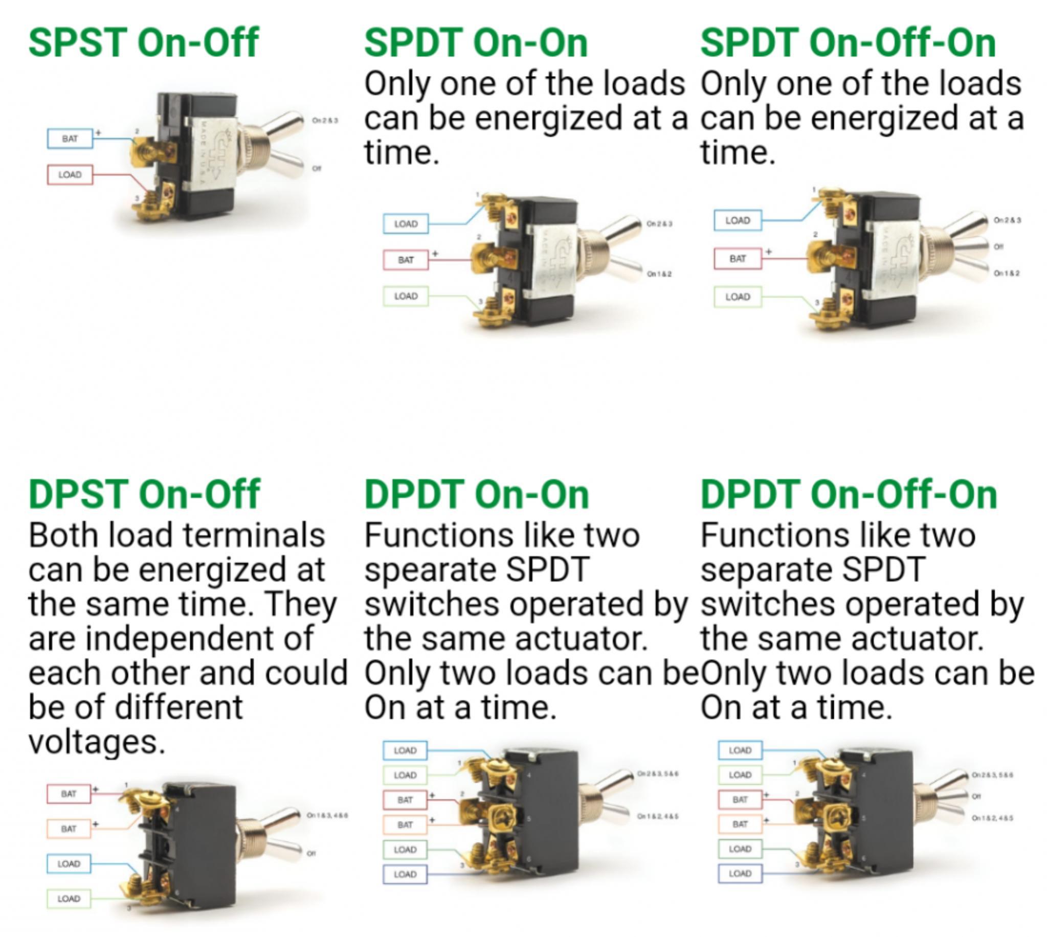

It is a DPST SW.

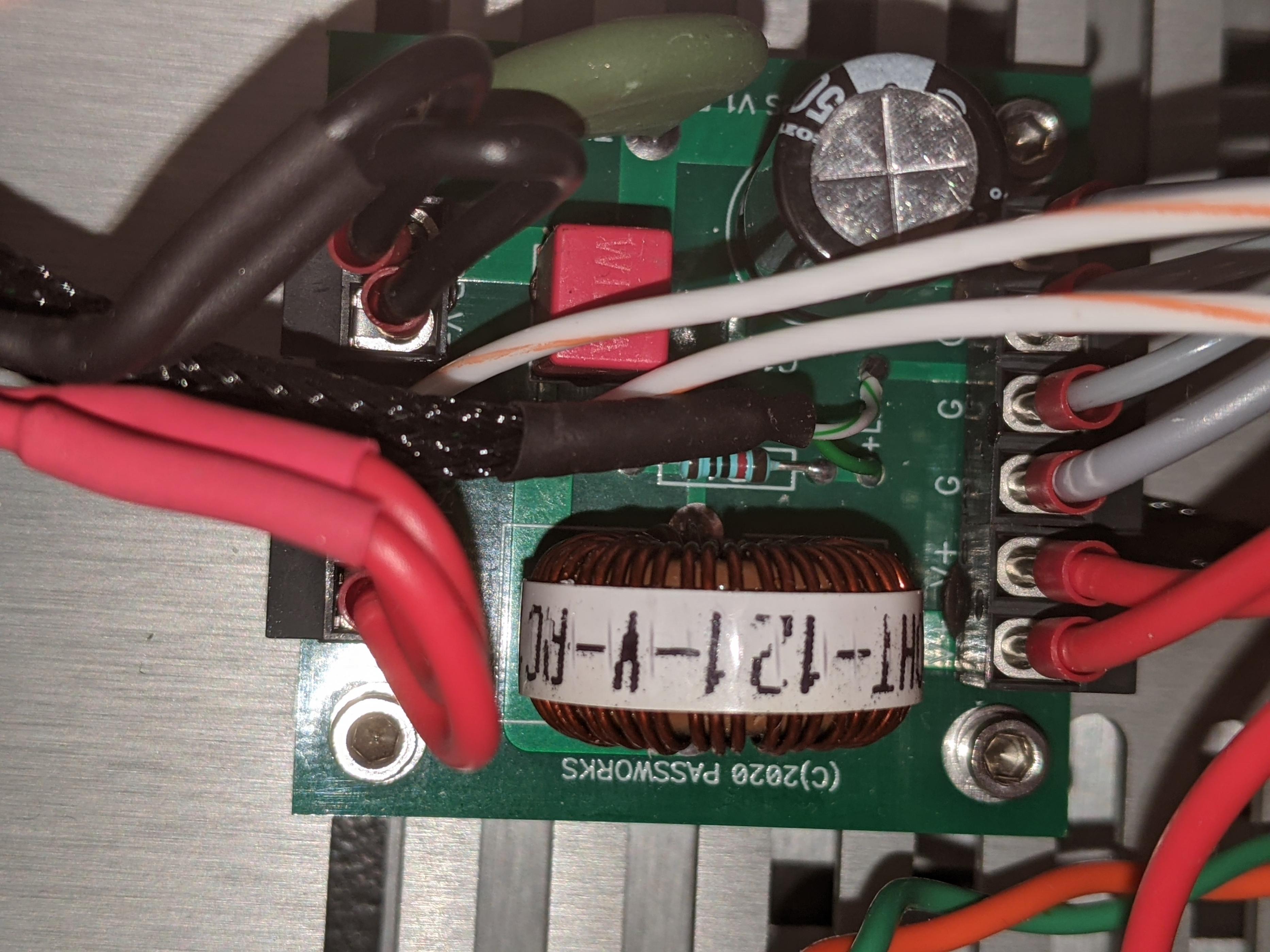

But from the schematics and the filter PCB board, it looks that a DPST could work. I might be wrong.
I just checked the PCB, the speaker is short to GND without power.
I still have grievances with this switch. If I don't switch it off fast enough (like smacking it) I get a disturbing Pop! in my precious vintage compression drivers. Does anybody know a switch that switches off with maximum effort?
Two secrions? Anyone of these?

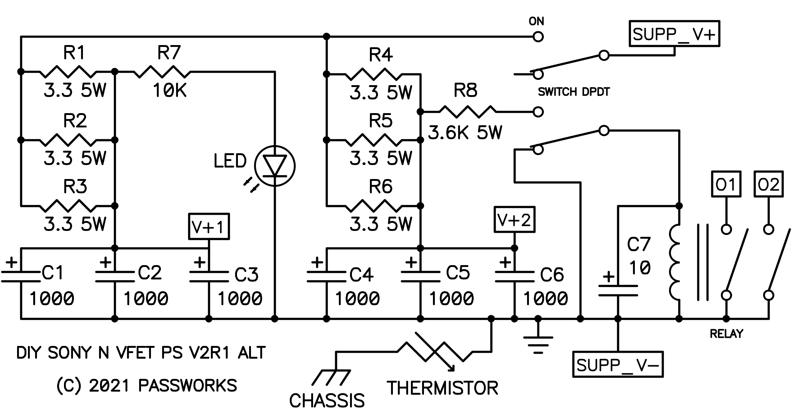

There is always a thump, I was just trying to keep it down to a dull roar.
However just for you I have an alternative switch arrangement to try,
which should shut the relay off faster.

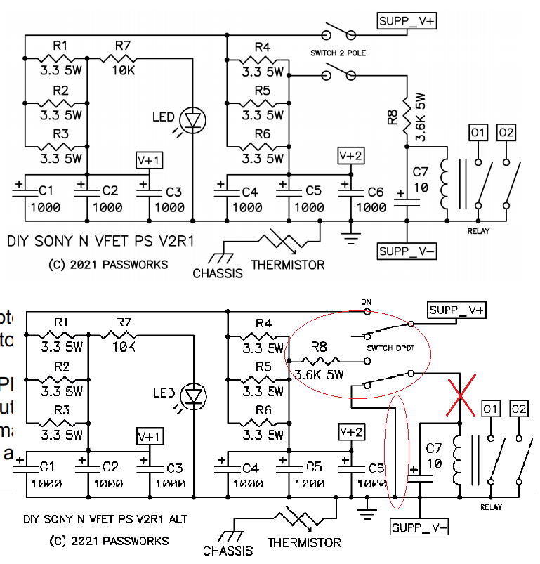

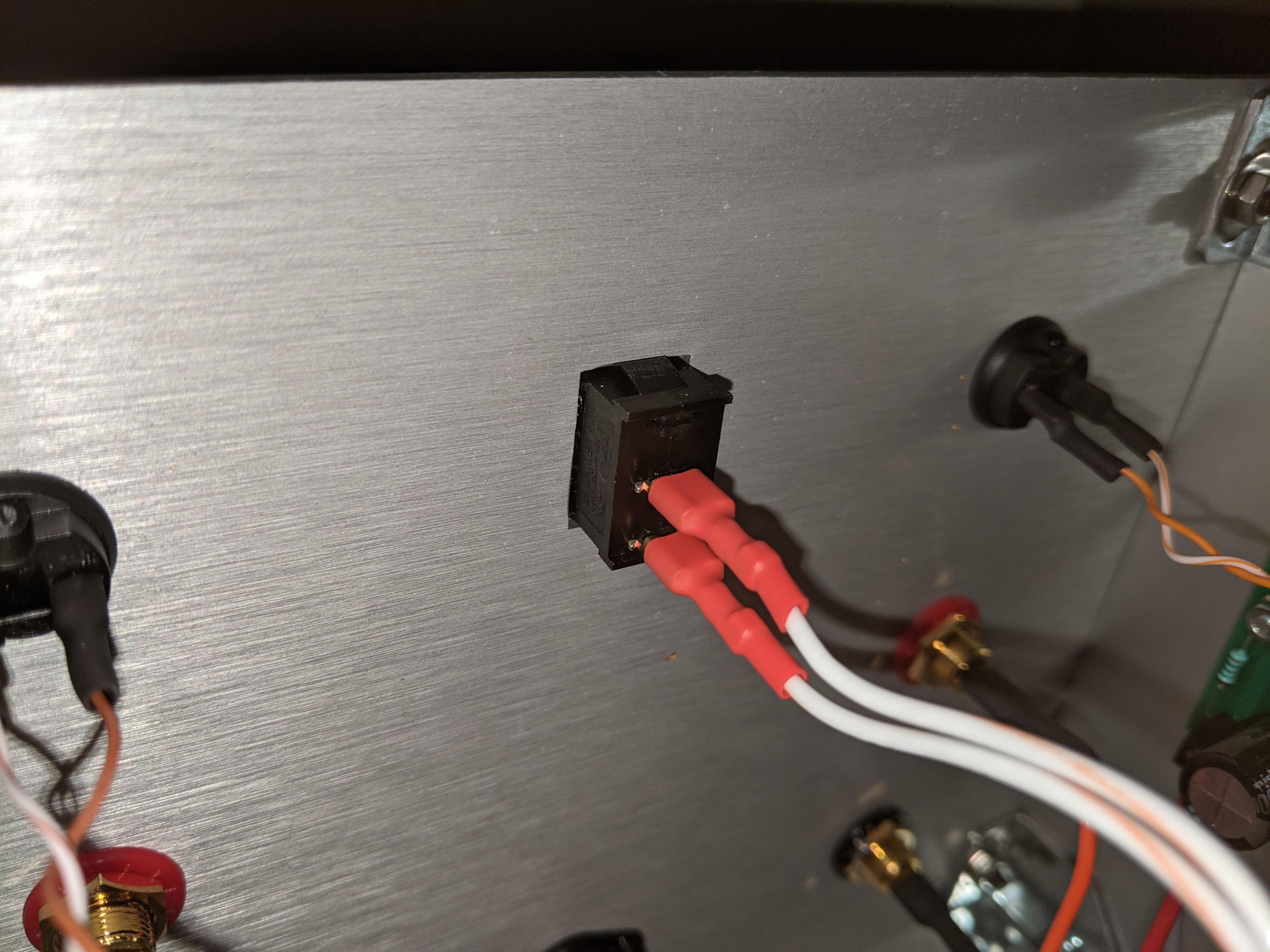

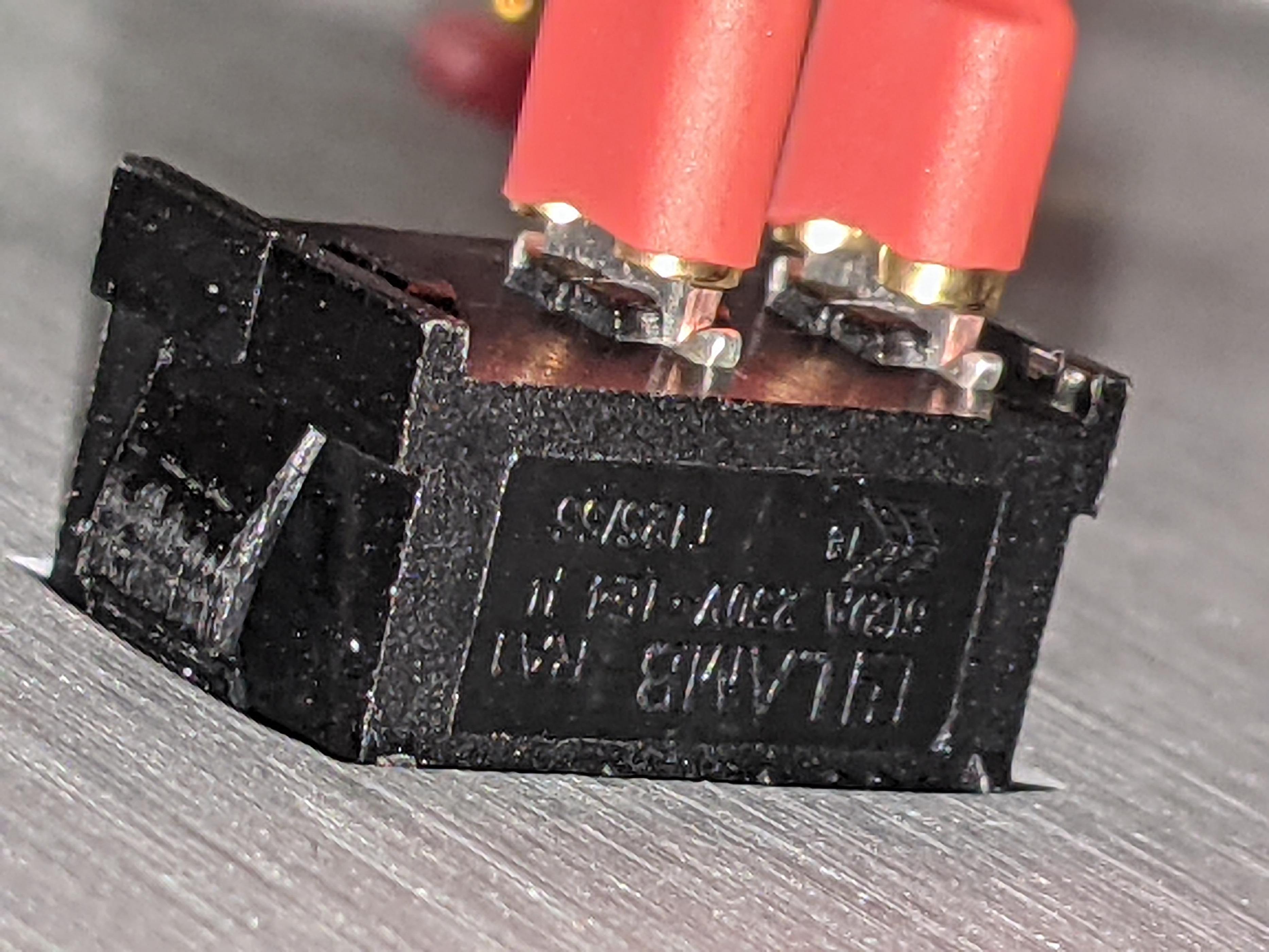

Thank you so much for the help! Just to confuse things, does it work on the P-channel amp as well? I aquired both through various donations and back alley deals.

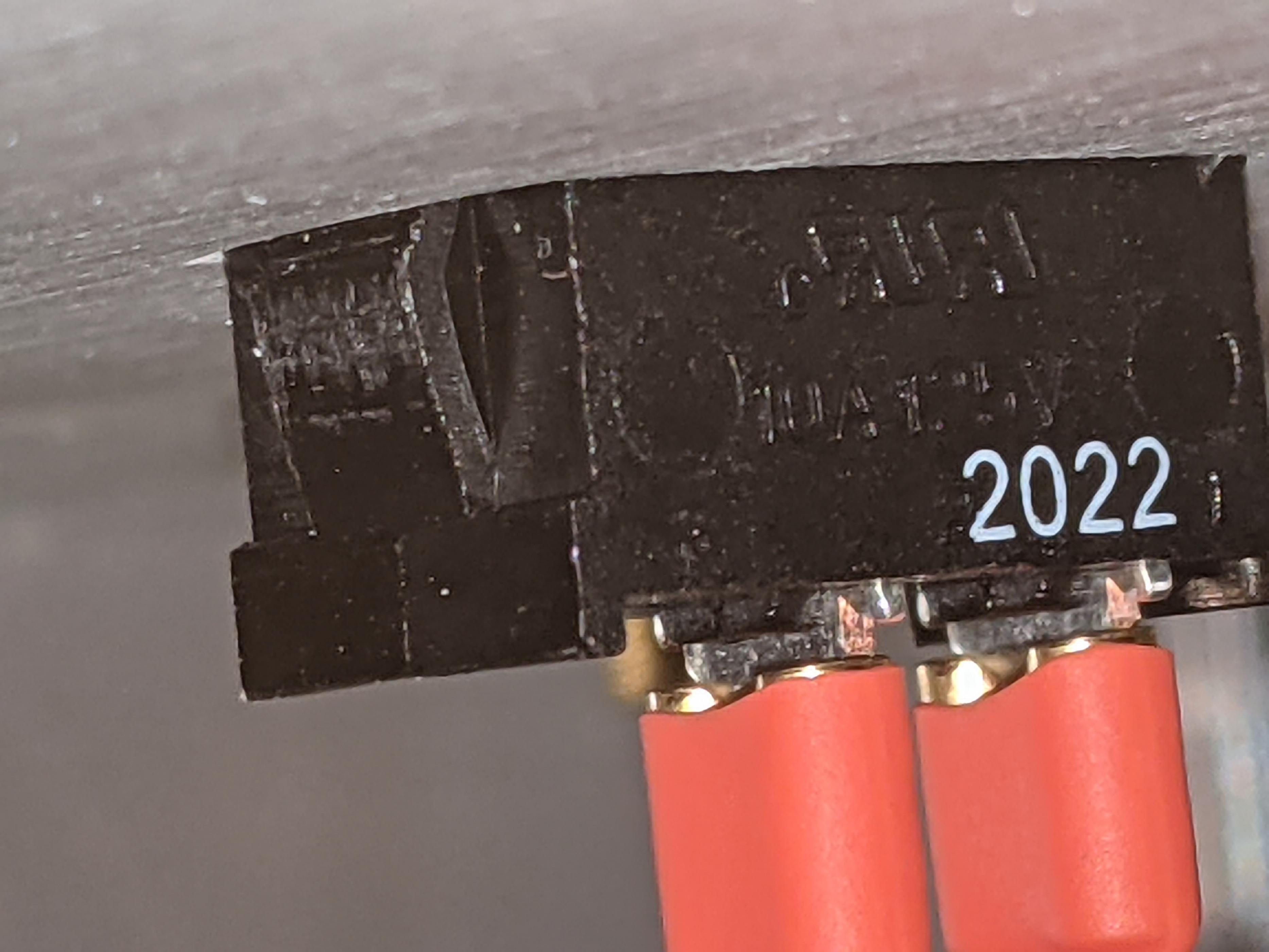

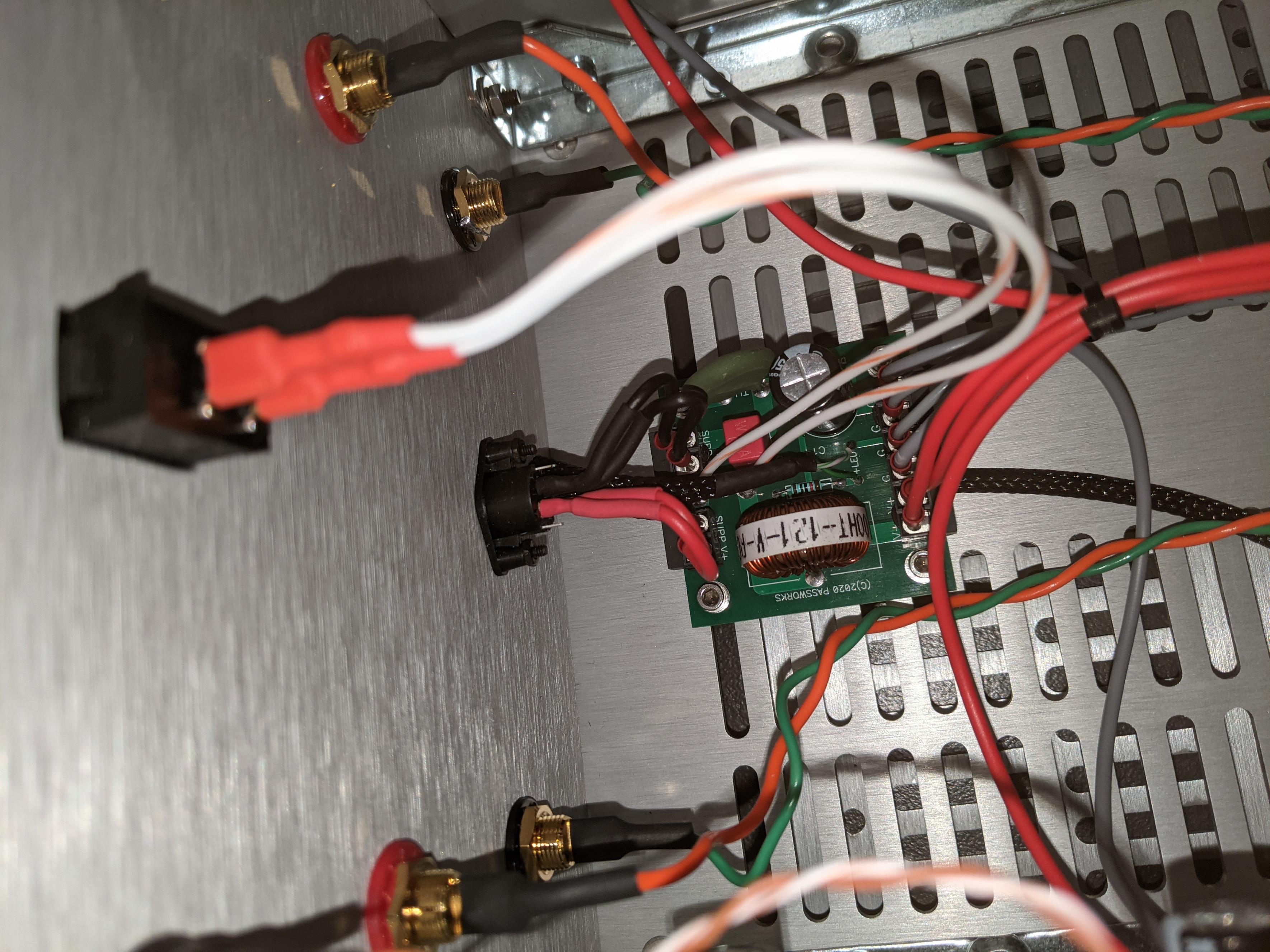

The one used is Lamb 10A 125V / 250V, and the hole in the chassis measures 20x12mm, for future reference.
