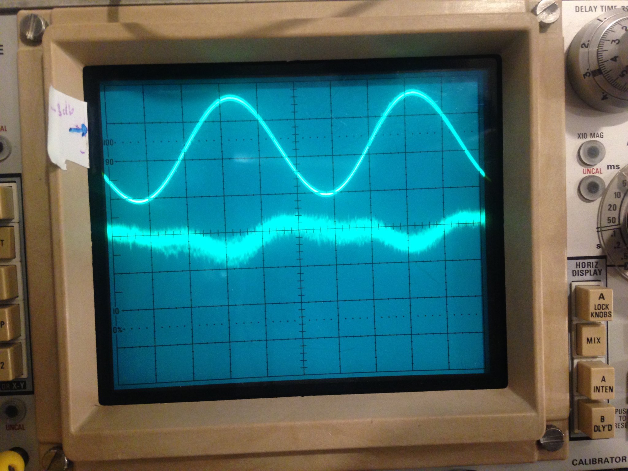

The gain should be less than 1, but I have no idea why it might be greater than 1. I see from your two graphs that the signal level is the same. Did you adjust the input signal to get identical signal levels.
Do you have individual power supplies for each channel? Are they switching supplies? If you have individual supplies, did you try changing the power supply with one from a good amp to see if the problem is with the supply? Did you also try changing the PS board board with one from a good amp to see if the problem is with the PS board?
The increase in noise in both the good and bad amps at about 9kHz is not normal either.
Pictures of your amps would be helpful.
Arrangement of cables, power cords, proximity to power transformers, etc, and arrangement of amplifier and test apparatus may also affect the test measurements. Photos of that may be helpful too.

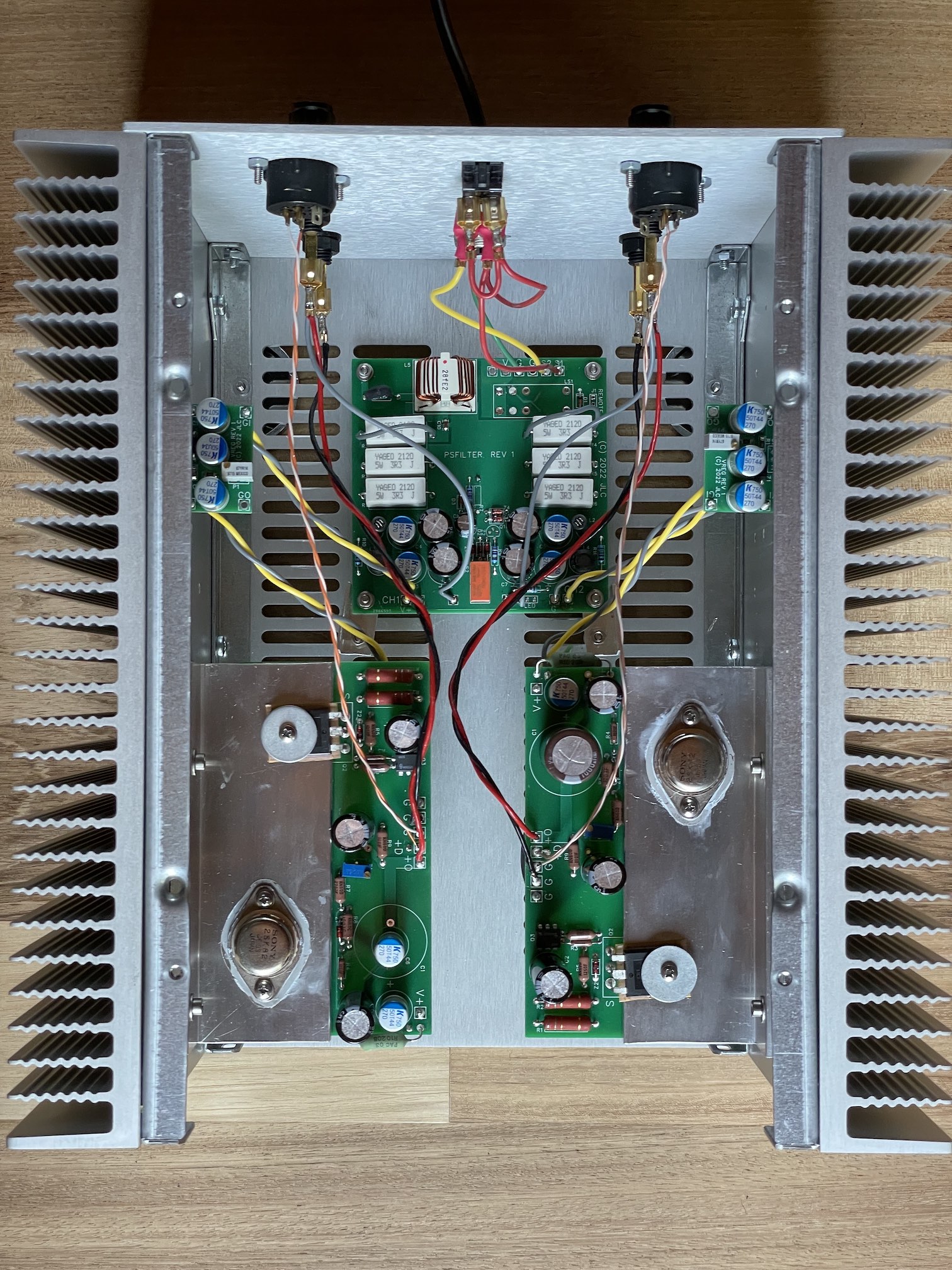

Ben,
Thanks for your reply. I just did a sanity check on the gain level using 1kHz sine wave and multimeter. It is <1 in all cases. My digital measurement was giving me the wrong gain factor.
There is no transformer in the chassis. It is using the same Meanwell 36V switching power supply as the project specified. I thought the noise at 9kHz is probably from the switching power supply, though I'm surprised that the LT1084 didn't do any attenuation to it. I thought the noise level is low enough that I wasn't too concern about it.
I have attached a picture of the build. The power supply board basically provide some RC and LC filters, and the relay output muting function. The R is currently bypassed in order the add the voltage regulator inline.
You may notice that I'm using a much smaller output coupling capacitor than the 10,000uF specified as I'm using them as high pass filter to drive the tweeter directly.

You previously mentioned four channels with one channel having high noise. Did you try swapping power supplies to try to track down the source of the noise?
You just mentioned that you bypassed the R of the RC filter and added a voltage regulator. I do not know exactly what you have done. A schematic would be helpful. My suspicion is that this change may have caused the noise issues. By bypassing the R, you have removed a stage of filtering. If you want to add a regulator, you should leave the power supply as designed and add the regulator after the RC stage.
I suggest you remove the voltage regulator and build the power supply as designed. Then listen and test. If it then tests noisy, there may be an issue with your build since this is a tested design.
After you get the amps to meet the design specifications, then you can modify them if you still have the desire to do more.
I built 4 channels in two stereo chassis. Each stereo chassis use one switching power supply. I started out with the passive RC+LC filter on the power supply and found that I have a 120Hz hum/buzz coming through my speakers (since they have 102dB and 107dB/W sensitivity). So I proceeded to add the LT1084 to reduce the low frequency noise. Before adding the voltage regulator, I have a similar noise floor rise with the passive power supply on the bad channel, but with higher 60/120 Hz components and harmonics.
Today, I tried swapping power supply between the two channels and the noise characteristics changed, but not reduced. So I try to add another ground wire twisted on the V+ wire since currently there is a section of 5 inches that is not twisted. That seem to solve the problem.
I don't quite understand why the other channel with similar layout doesn't show the problem, but I will add the ground wire to it as preventive measure. May be shielded power wiring could further bring down the noise floor?
As to why this could solve the problem, I'm not quite sure. A wire picking up interference on specific frequencies from a nearby radiation source is understandable. A broadband noise floor like that is something that I have not seen before.
For the 9kHz noise band, it may be worth further investigation. But probably after I spend some time enjoying listening to the amp first.

If you have extremely sensitive speakers, you need to pay attention to all factors that may allow noise into your system. I have 103dB sensitive speakers and I have experienced noise, so I have learned to build noise free amps and preamps. For me, noise abatement starts at the beginning of the build, not at the end.
Single ended circuits are especially prone to noise, and the N channel circuits with the power supply connected the drain are even more susceptible to noise. So very clean power is needed. Good grounding techniques and keeping loop areas to the absolute minimum is required. In your case pairing a ground wire with the V+ wire is a case where you reduced a loop area.
In my amps and preamps, all conductors (whether power or signal) and their returns are twisted together. So Ground and V+ together, (Ground and V+ and V- together if bipolar supply), input signal+ and Ground together, output signal or speaker and Ground together.
Keeping AC and power transformers away from the amplifier circuit is also critical. You are using a SMPS so you have no AC in your box, but the SMPS should be kept away from the amplifier. Also helpful is to plug all of your music system components into one wall AC outlet, and as much as physically feasible, bundle all of the AC cords together. That all helps to minimize loop area and noise.

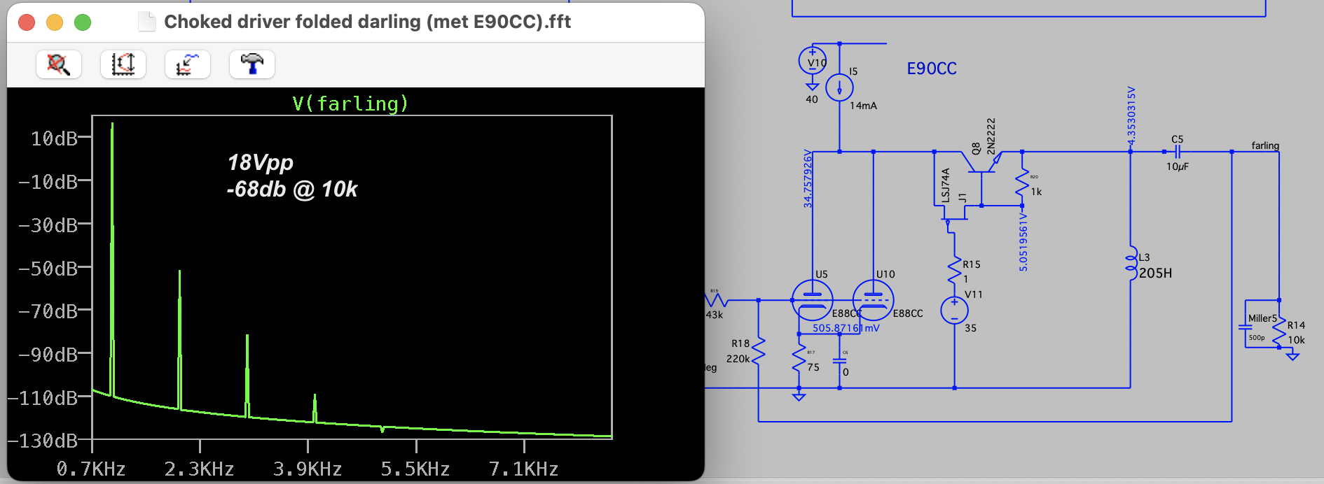

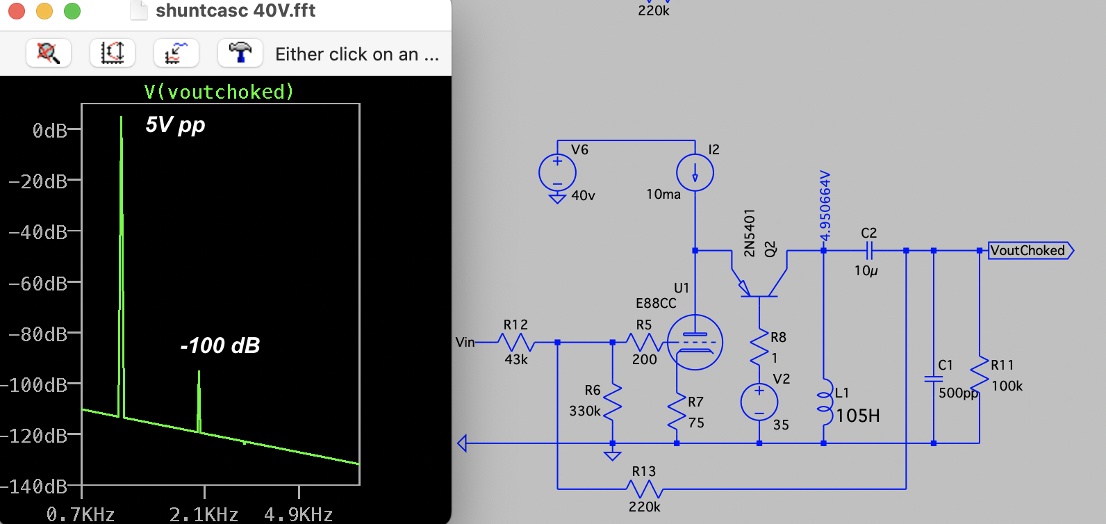

I have implemented the folded PCC88 driver. The first model was with a standard CCS from LT Spice. Actually I used a JFET for it, J103, giving Idss of 20 ma, with a 39 ohm, it is 15 mA. That is split across the tubes (2,6 mA) and the choke.I'm pondering folding the front end: here with ECC88, but can be done with great success with for instance a 2SK30 too. (In the sims I found the 2SK170 a bit too hefty).
The bonus points: it works with the Vb=40 Volts; I made the bias simple here, but all the elaborate bias that others cam up with can be used of course.
I charge it with a choke to get a flying output, that is, it swings up and below the earth.
I have a choke like this already in my box.
My first idea was to load this on the ECC88 anode (or jFET drain), it gives a great bandwidth but imho needs feedback. Ben Mah if I remember approximately did this too.
Now the follower is a compound one, not a darlington (two PNP) but a Darlingnot (a PNP and an NPN; in fact I choose a high voltage P-FET that can handle 50Vds and a BD139). I choose that because in modelling the standard darlington gave 5th and 7th harmonics; while the darlingnot has a natural degradation. So not the 'ideal' no distortion.
Measured: A trace of second, at 0,03% about and 8VRMS out. All I need. But - repeat: this circuit can give a clean 40Vpp from 40V Vb!
Al together, not bad.
BW from 6Hz to 105 kHz. Two halves of the transformer parallel. Each has Rdc of 1k2; parallel it is 600 ohms. Parallel it behave nice.
There are a few minor bumps of about 2 dB at the higher end. The BW fall gracefully.
Without current just on the signal generator the 'choke' had a higher BW. The 'choke' is a 10K:10K transformer. It was sold to me as allowing 45mA DC. I doubt the specs, I somehow distrust it to be a PP transformer not SE as they said.

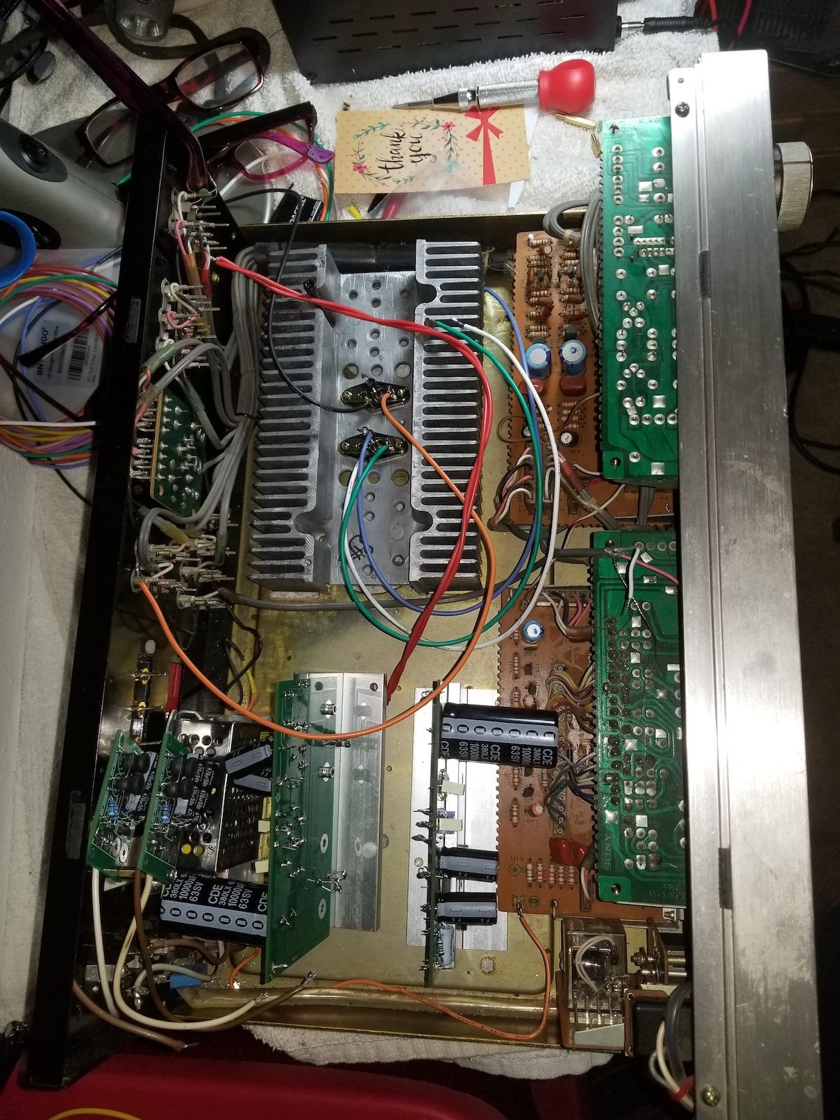

Channels are within less than 0,1 dB.I'm finally getting back to the Sony chassis TA 4650 build after three non functioning power supplies. Got the wall wart 36v from DIY store, works, tested. I know the cards and transistors work great because they were bench tested. What I have now is logistics and manipulation to get things in the chassis, which I think is quite do'able now.
Question on wall wart power supply: There are two output rails of V+ and V-. Does this mean if these two branches are used, each rail has 36v with half the current if they are both used at the same time i.e. one branch for each card? If only one branch is used, will that provide 36v at full current that can be split between the cards with just two wires output from the wall wart?
Also, the
Also, the
