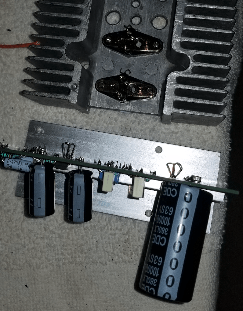

VFET and MOSFET are secured to the heat sink (4650) for one channel. I guess I just have to connect the wires in the right order to the input board and add V+ to test the heat sink viability. Can V+ be ramped up slowly, or should it be turned on at full V? What is the proper current/amp setting for a variable power supply? The transistors with the flexible junction wafers are on the underside of the heat sink, the attachment apparatus is on top. Attachment apparatus is what is showing (S, D, G).

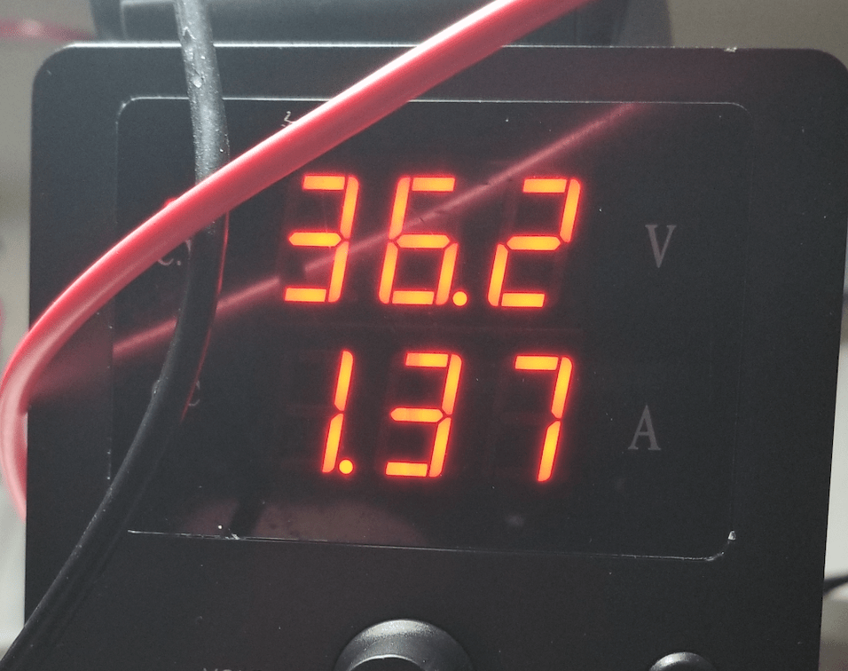

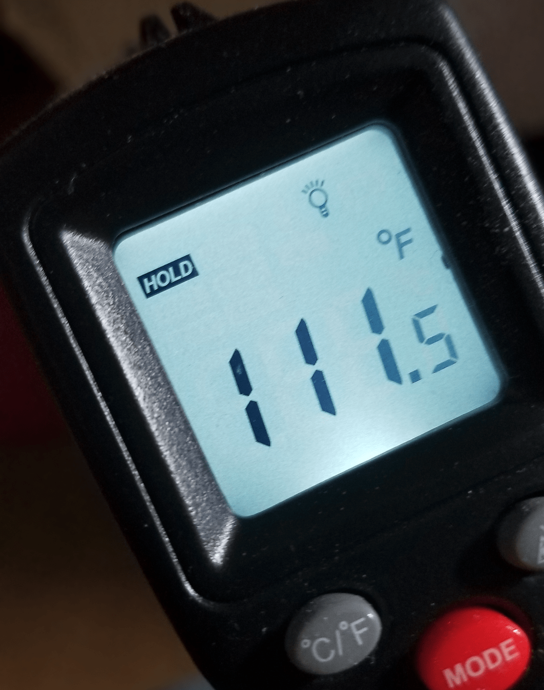

OK, I was curious so I hooked it up to V+. It didn't blow up, so I assume it is OK. The variable power source read around 36.3 v and 1.37 amps or so with no adjustment. I imagine adjustment will make the amps a little lower.

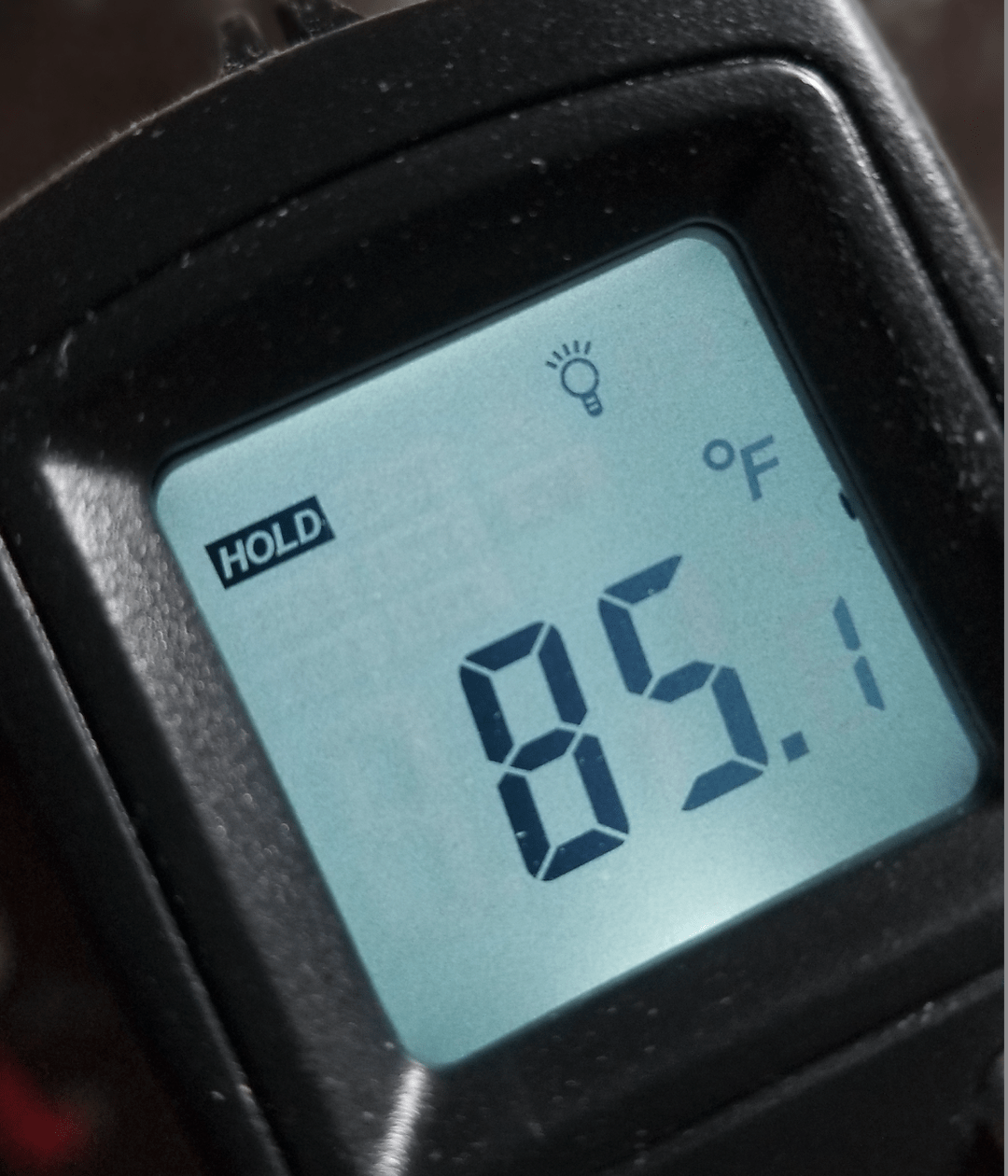

After about 40 min., the 'hot' side of the heat sink seemed to stabilize about 130 F. The 'cold' side of the heat sink seemed to stabilize around 95 F. I could touch the heat sink for several seconds most of the time at greater than five seconds.

130 F is about 54.5 C so it's getting up there in heat.
1.37A is a bit higher than the specified 1.2V/0.94R=1.28A through R1+R2, so that is the reason for your higher power dissipation.
However R1+R2 (0.94R total) is in the path of the 1.37A so they dissipate 1.37A x 1.37A x 0.94R= 1.8W. Therefore the the heat sink dissipates 1.37Ax36.3V - 1.8W=47.9W.
You can lower the power dissipation by reducing the CCS current. Increase R6 (N VFET) or R7 (P VFET) will decrease the current.

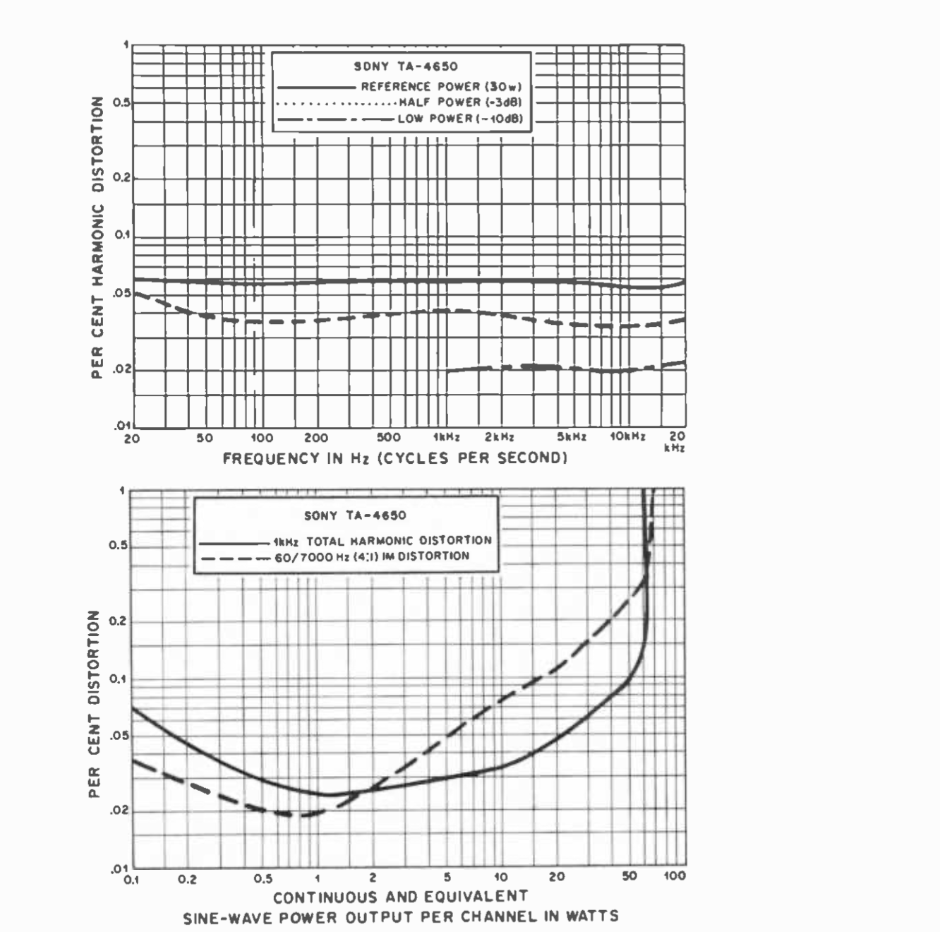

Just for fun, the measurements of the Sony TA4650 amp from the day. The article deemed it a 60w/ch amp in spite of 30w/ch rating:

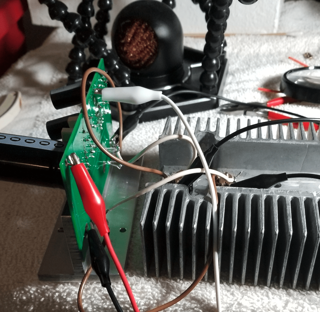

I will continue to bench test the single heat sink for two channels, but I suspect I will eventually use two heat sinks which will fit in the chassis when used vertically instead of horizontally. Question is if the single heat sink can dissipate the 90 watts of heat, which is just a maybe. The original heat sinks were designed with the transistors downward, with a heat chimney effect pulling air from the bottom space into and over the heat sinks. Specs on the TAN 8550 (which used these heat sinks) seem to indicate that the idling wattage was over 100 watts/ch per heat sink, so that would be within a 90 watt spec, but who knows what the variables are.

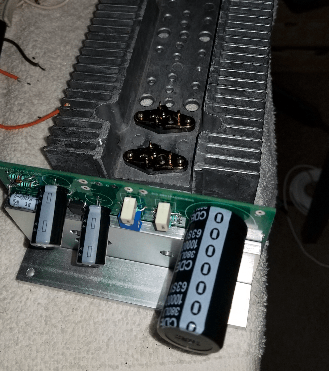

OK, it appears so far I have two working N channel cards assembled that bias to the 16v on the drain pin of the MOSFET on my bench rig. I pulled some major dumass boners that are a bit embarrassing to recite, but I will if somebody is interested. Fortunately, it did not result in the loss of any transistors or VFET (again, first amplifier build. I built Korg B preamp successfully a while ago, my first full DIY endeavor).
Having the MOSFET/VFET lashed to one end of the Sony TA 4650 heat sink, things on that end seem to stabilize temperature wise at about 120 F on the heat sink, maybe ten degrees hotter on the transistor cradle. I lifted the heat sink off of the towel so that it was surrounded by air and that seemed to reduce temp overall by about 10 F.
I can hold my finger on the adjacent heat sink for five to ten seconds. At the other end of the heat sink, it stabilizes at about 90-95 F.
I guess my next will be to continue testing heat sink on bench to see if I use two heat sinks or can get away with one, and hook up a source and speaker to a card to see what kind of noise it makes. If that goes well for two cards, the next will be how to decide to get the rig into the 4650 chassis. My present thought is to use the built in 4650 preamp to drive the amp units and decide on putting in the Bulwark cards later. I have no idea what the gain is of the built in preamp and it has a 3K ohm impedance output according to the literature. Maybe that could be a problem in impedance matching. However, the preamp section has lots of tone controls and inputs and is routed through its own output, with the power amp section accessed through its own input, easy to unplug.
