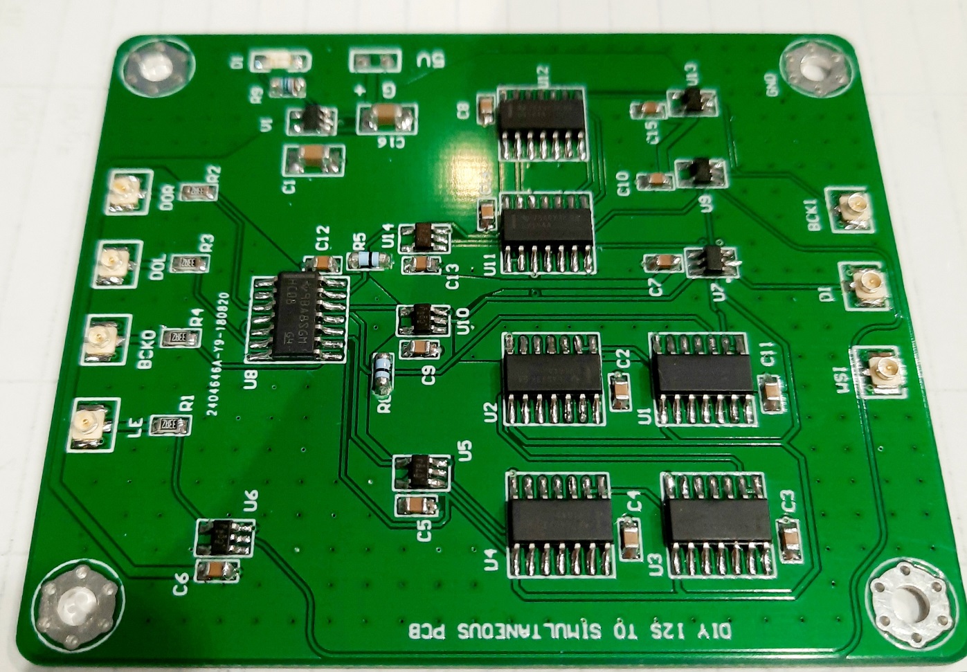

I see D3 setups with Ian's Fifopi directly to the D3 board and setups with the I2S to simultaneous converter board between the Fifopi and D3 board.
What is the benefit or downside of the setups?

Hi 3kes,
Simultaneous mode in my experience is a much more enjoyable listening experience with the TDA1541A. The sterreo imaging is much more refined and accurate, I also noticed an improvement in the accuracy of the bass.

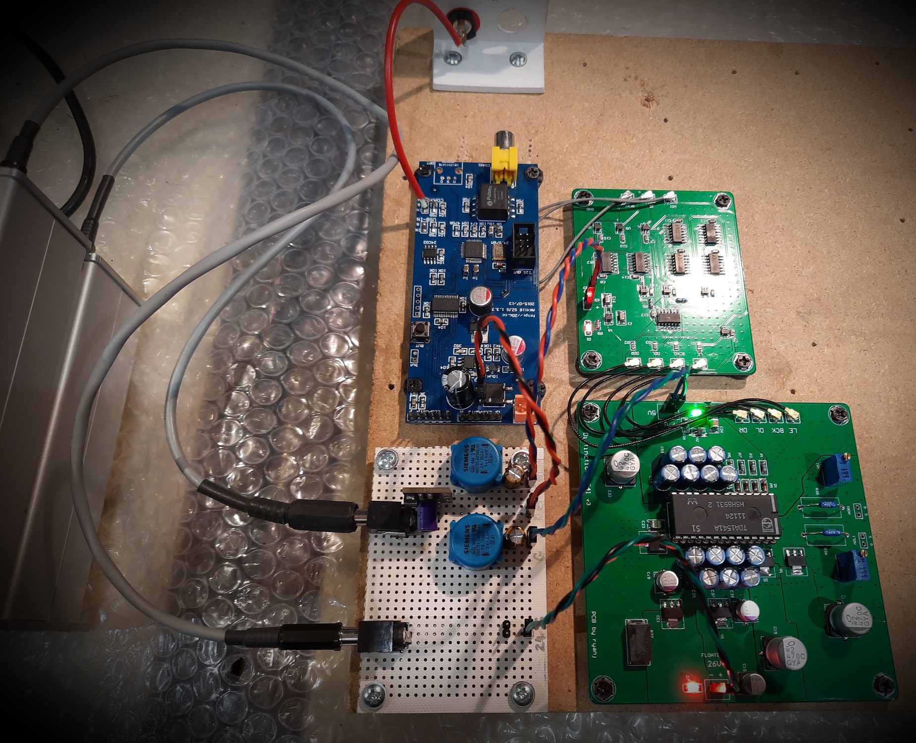

I finally had some time to finish my D3 build, look forward to it. But I run into a no sound issue... I suspect it is on the V1 i2s sim board.
My setup is:
RPI4 + Moode Audio (USB setting) (files play ok)
JLSounds V3; USB>I2S internal clock (internal clock, TDA1541A in I2S mode in 32-bit frame; jumpers on J2, J4 A2, B1, B3 closed) 32 bit means stereo I guess!
Dual external power supply setup
Ryan’s V1 board (I2S > Sim)
Ryan’s D3 board (in J2 simultaneous setting)
>> I/V 50R resistor for the moment
No shorts and such on the UF/L lines.
The D3 has correct power and I can get 0mV on the AOL / AOR once the RPI starts playing a song.
For those familiar with the jlsounds; Is the jlsounds jumper setting correct?, the 32 bit refers to 2x16 stereo channels I guess...
Next step would be troubleshooting the V1 board
Regards, Albert
Follow up on previous post.
Jlsounds needed the standard I2S setup (only B1 and B3), I2S SIM V1, D3 all ok
Very good sound on this test setup
Hear some cracks on some 16 bits sample rates, but ie 176k/16 plays fine

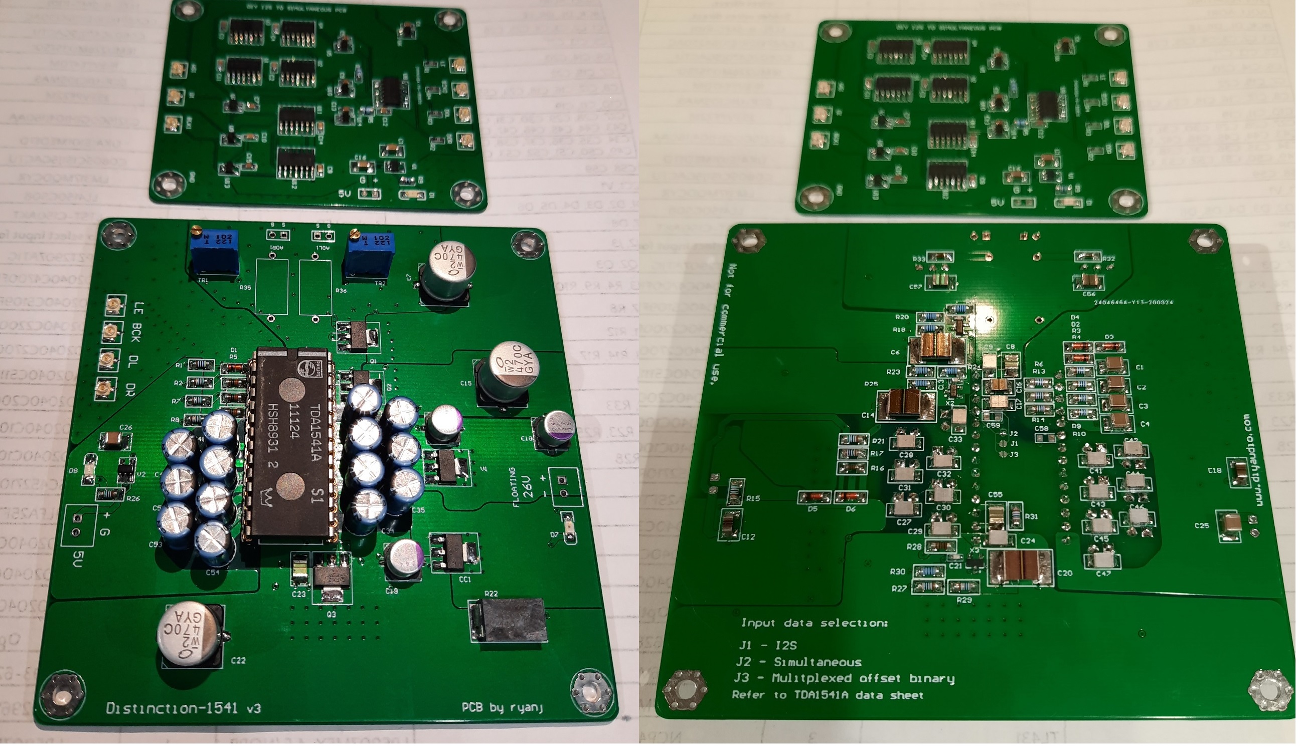

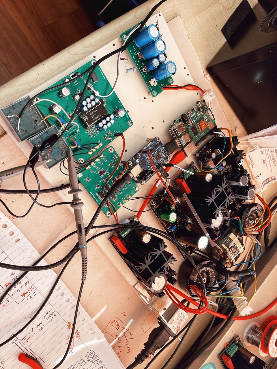

At the moment I have very little time because of 3 month old child, so i have to optimize my time. I am very sorry if this was already explained, i found some info but i am not sure if i explained it right to myselfe. I soldered my boards, connected them to 2 lifepo power supply, so 25,2V and 8,4V followed by tps7a4700 set to 5v. I measured voltages in expected region, just dc offset can not be set to 0V and i can"t measure any output signal with 50r i/v resistor. Here is my work. For the test i use piece of wood, later if sound will be promissing it wil be mounted into alu enclosure. Maybe some mistakes are vissible? I know, i should"t use S1 for testing but, i get A dac in one week and can"t wait another week 🙂 .

Is the 25.2V battery supply floating? its not referenced to ground?
You may also need music playing to get 0V on the outputs.

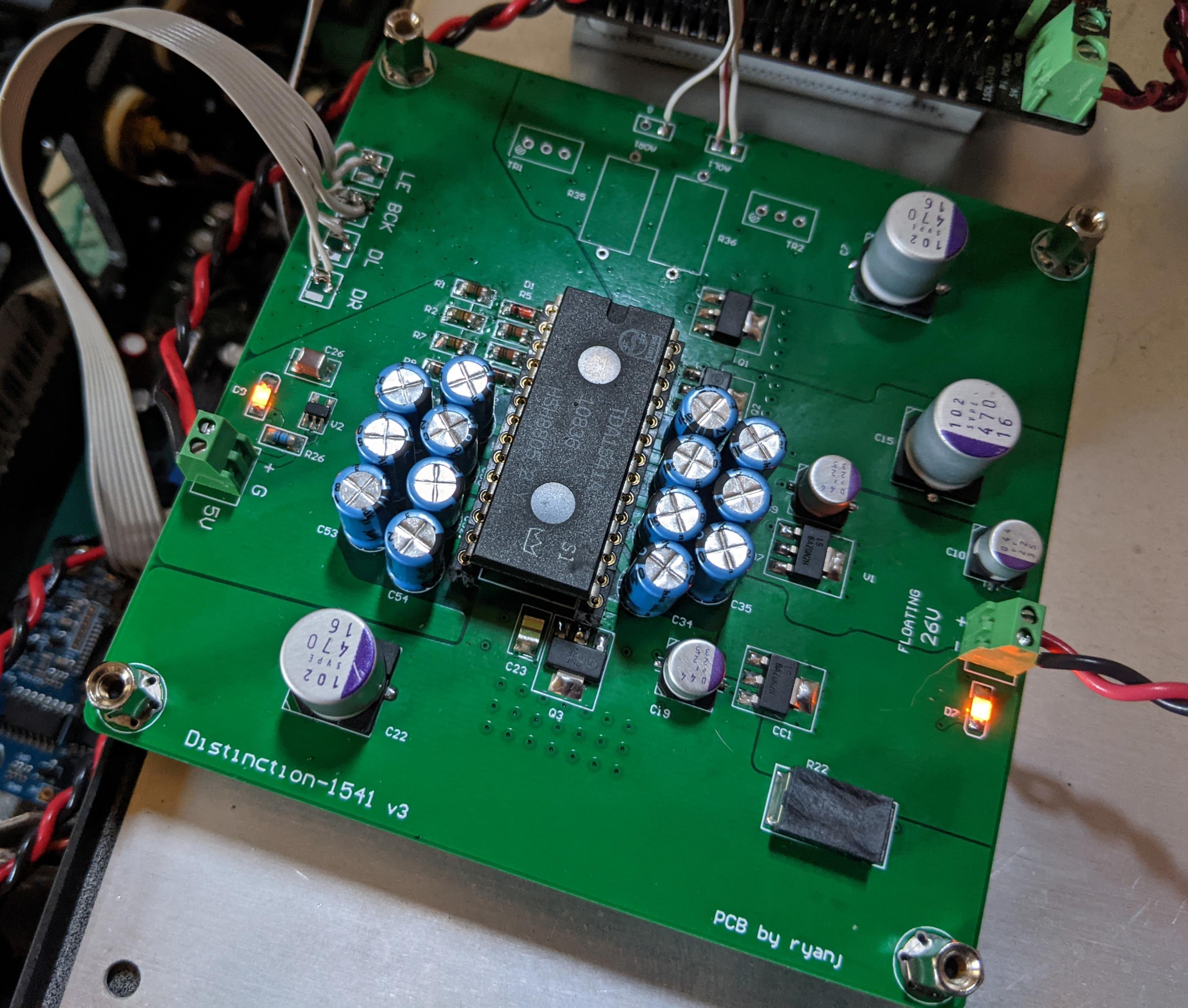

Up and Running
I got my D3 up and running today, it's a long story but I got massively sidetracked before returning to the TDA1541A fold 🙂.
I have Pedja Rogic's original AYA which I've been running without the digital receiver section and plumbing in I2S from a JL Sounds USB board. I've hacked the D3 with a super simple power supply onto Pedja's AD844 output stage just to see what kind of flavour I get. Even without it burning in, there is more of the good stuff: resolution, soundstage depth, bass definition and less of the bad stuff: grain and grit.
Thanks Ryan et all, time to get busy implementing!

Hi simon dart,
Good to here you have it all working!
Out of curiosity - What part of the D3 PSU did you take power from to power AD844?
Not sure of the specifics of your output stage but you may want to try the on board +2mA current injection - compared with other solutions it gives less glare and graininess giving a smoother more relaxed sound. Its a subtle change so it will depend on the rest of your system to how well you will hear it.
