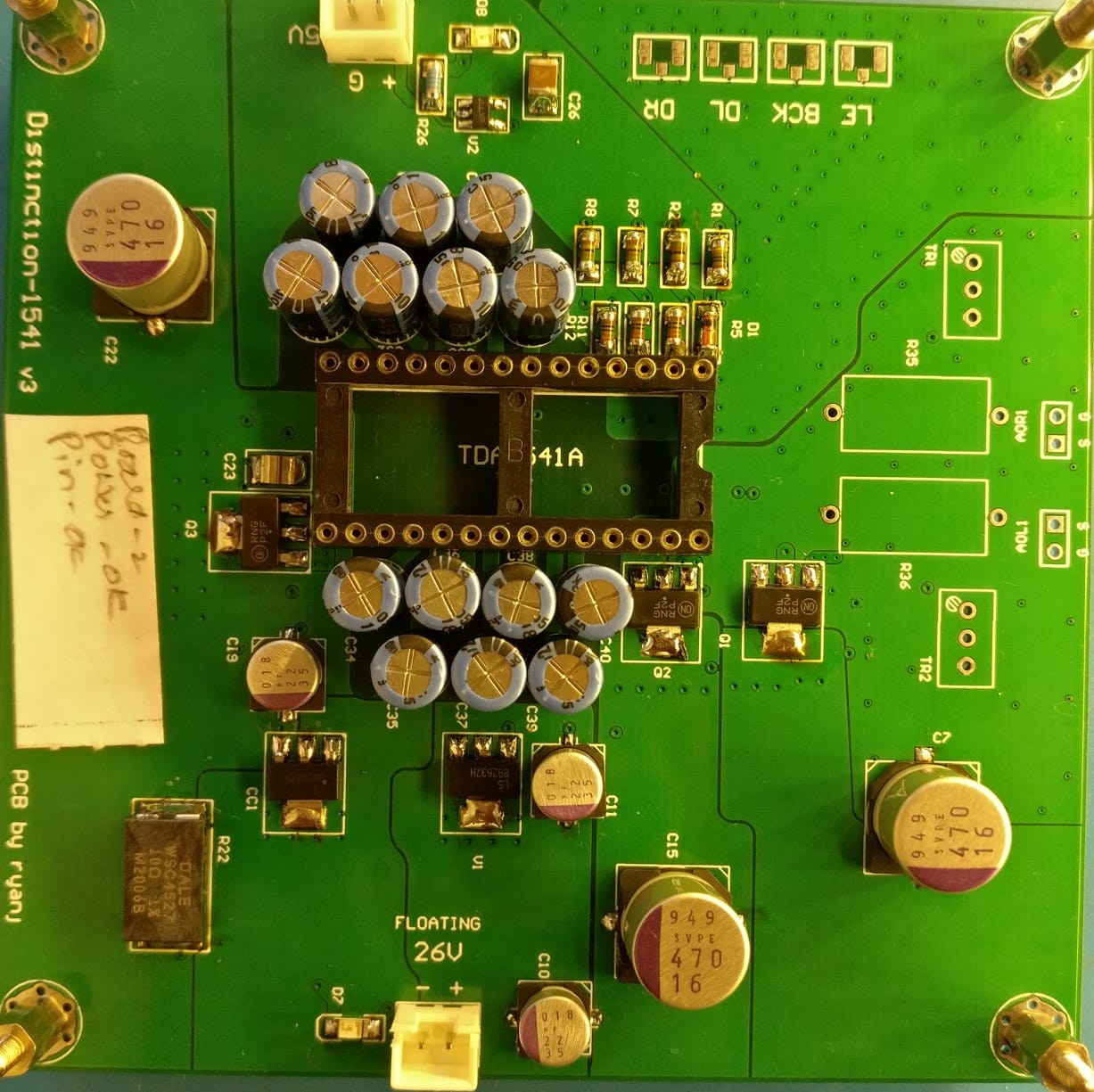

Thanks to the manual by Greg, i was able to power up the board and check voltages, they were within 0.25v of the spec.
As i am waiting for C6, C14 and C20 to be delivered, can we use - CGA6P1X7R1E106K250AC in these three locations ?
Yes, Sonics would not match to the 22uf Rubycon, but would it be fine for using till the caps arrive ?
Also attached is the pic of the board.

Hi Harsha,
You can use the D3 without C6, C14 and C20 installed, it will work without them but the output impedance in the bass region will be around 14 mohms instead of around 3 mohms - I would leave the pads clean until you get the correct caps.
.25V seems a little far out of spec, did you have a dummy load while testing?

Thanks for the response, Some more details, which may be essential.
Voltages were measured with only the bare minimum components as specified in the Guide (X1, X2, X3, C5, C13, C21, R19, R20, R18, R24, R23, R25, R28, R30, R27, R29, R21, R17,R16, Q3, Q2, Q1, CC1, V1, R22.)
Load resistors were added as per the Guide and voltage across them were measured.
I will again measure the voltages now, as there are all components soldered.
Regarding caps, I will proceed as suggested by you.

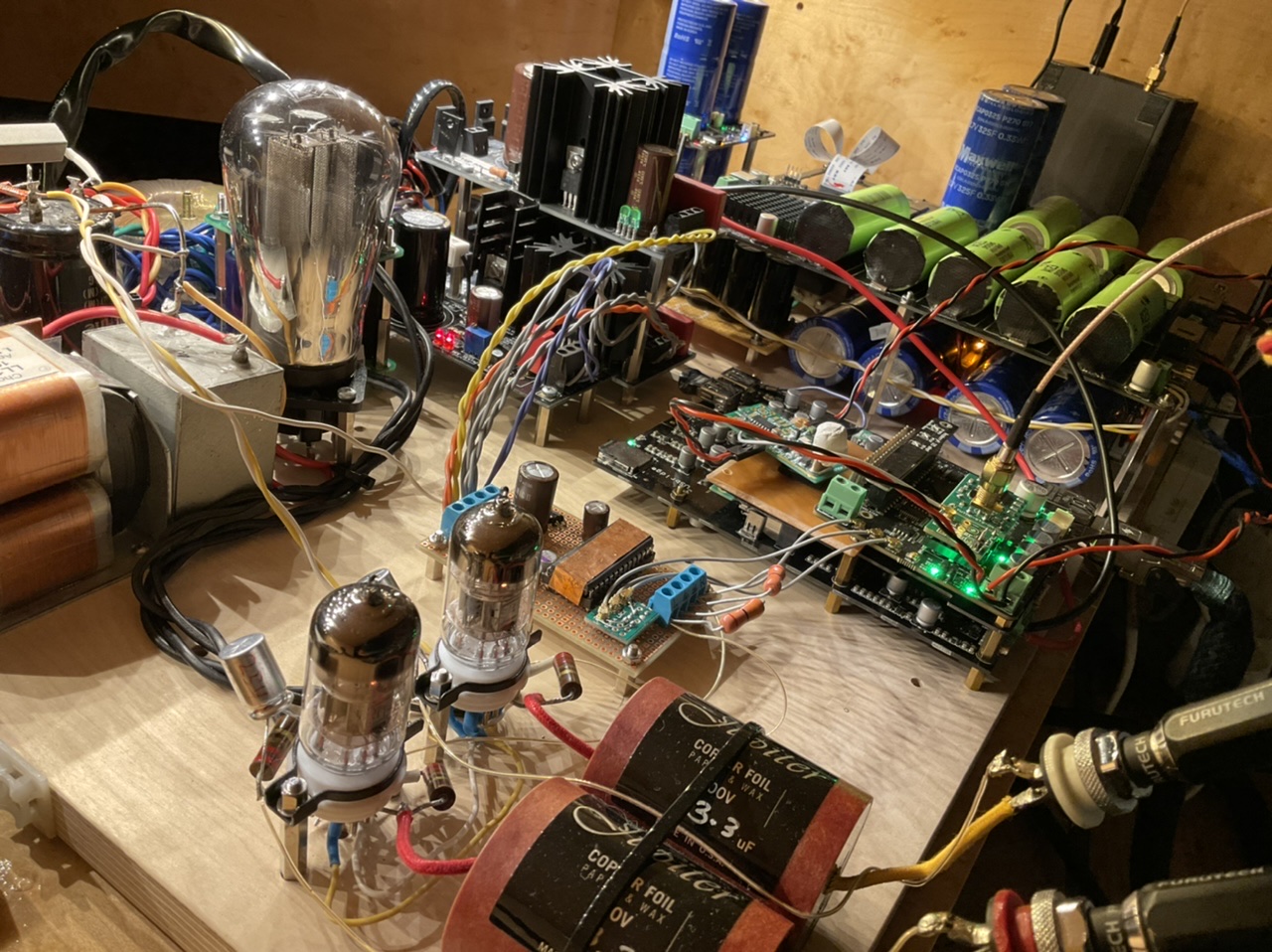

I have build the new Driscoll clock units from Andrea that I will use, together with the 50hz Dem I reckon it will be a very low jitter performance.

Currently I have the TDA dac running on a perf board in I2S with the 5,6mhz driscoll and it is very promising!
