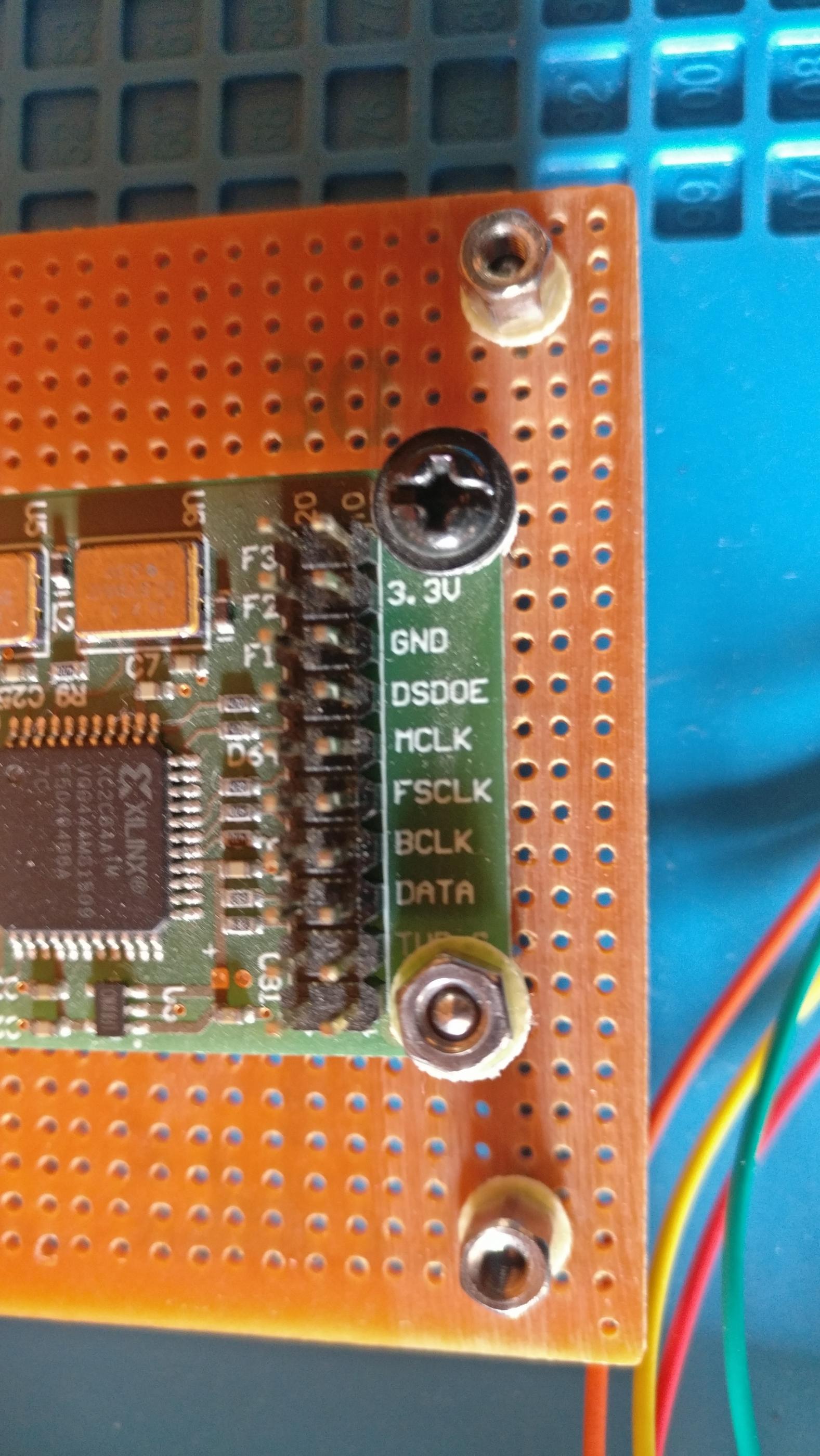

Ok, that makes sense now.
Went ahead and populated all components, measured the voltages again, they are within 0.2v of prescribed, that may very well be error in my Voltmeter.
Next is about connecting i2s lines, Can you pls guide the connection schema.
As of now, i have shorted Jumper J1 to use in i2s mode. Once it is tested, we can proceed to your i2s to sim module.
regarding IV stage, as of now only 120 ohm resistor is used in IV location.
once a sound test is made, planning for a simple IV. Would this work ?
Harsha

Hi Harsha,
Try connecting FSCLK to LE, BCK to BCK, and DATA to DL.
120R will be ok for testing but will give audible distortion, best to go with 60R or 70R.
The voltage may be an issue, maybe check with another voltmeter.
