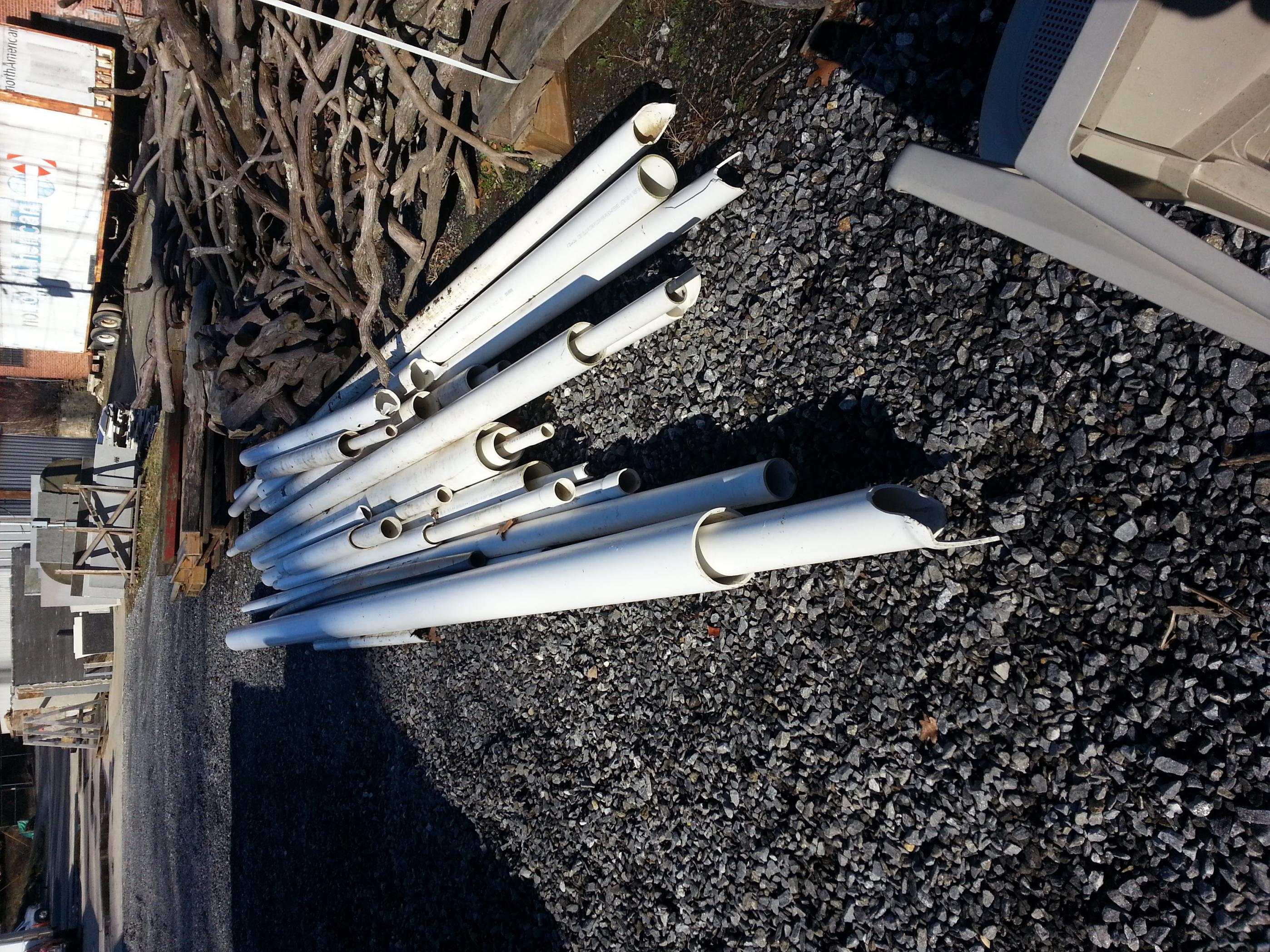

...and then there's moi, with my current 'score' of scrap PVC from the plumbing supply house next door that just closed shop...
