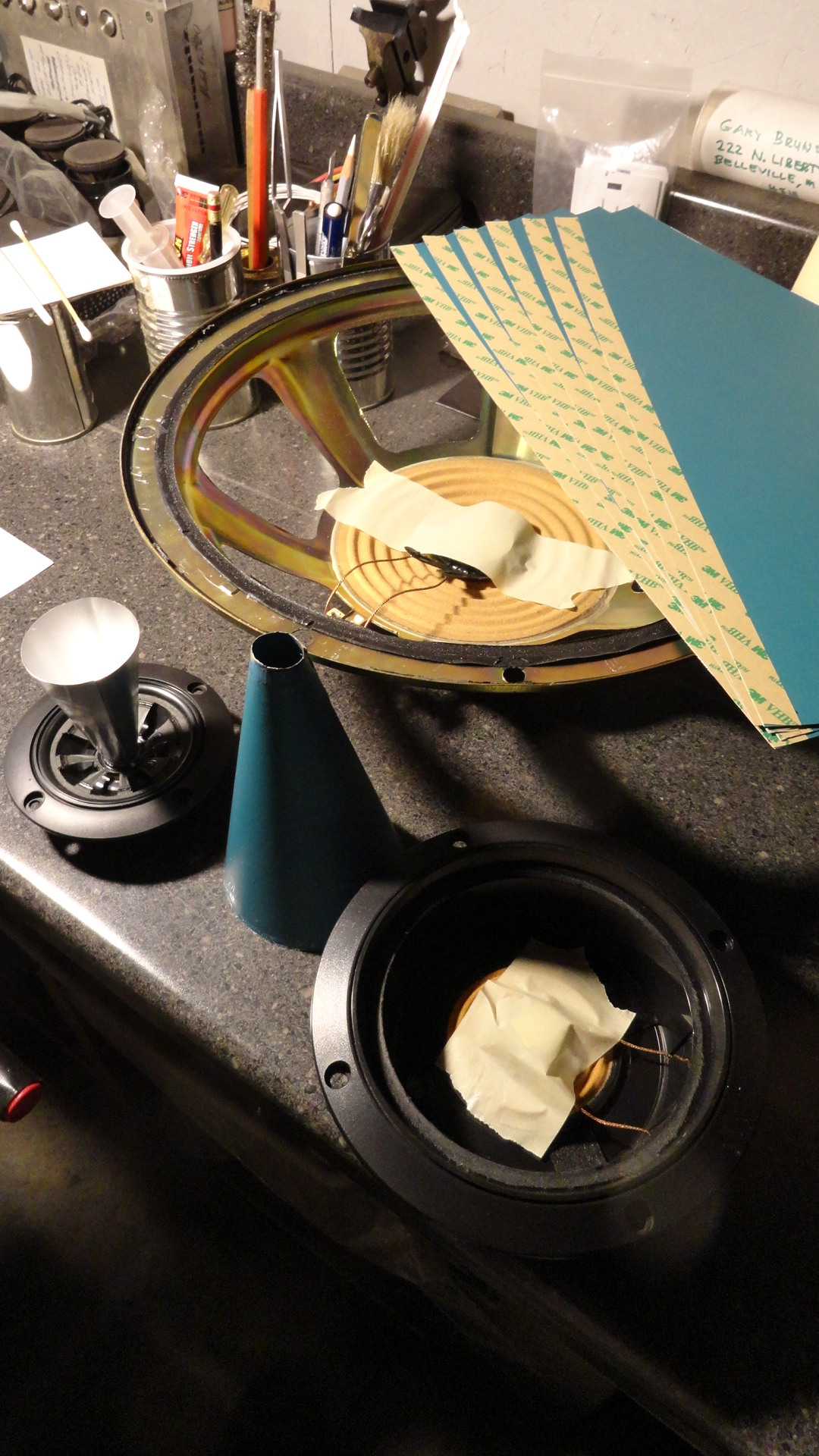

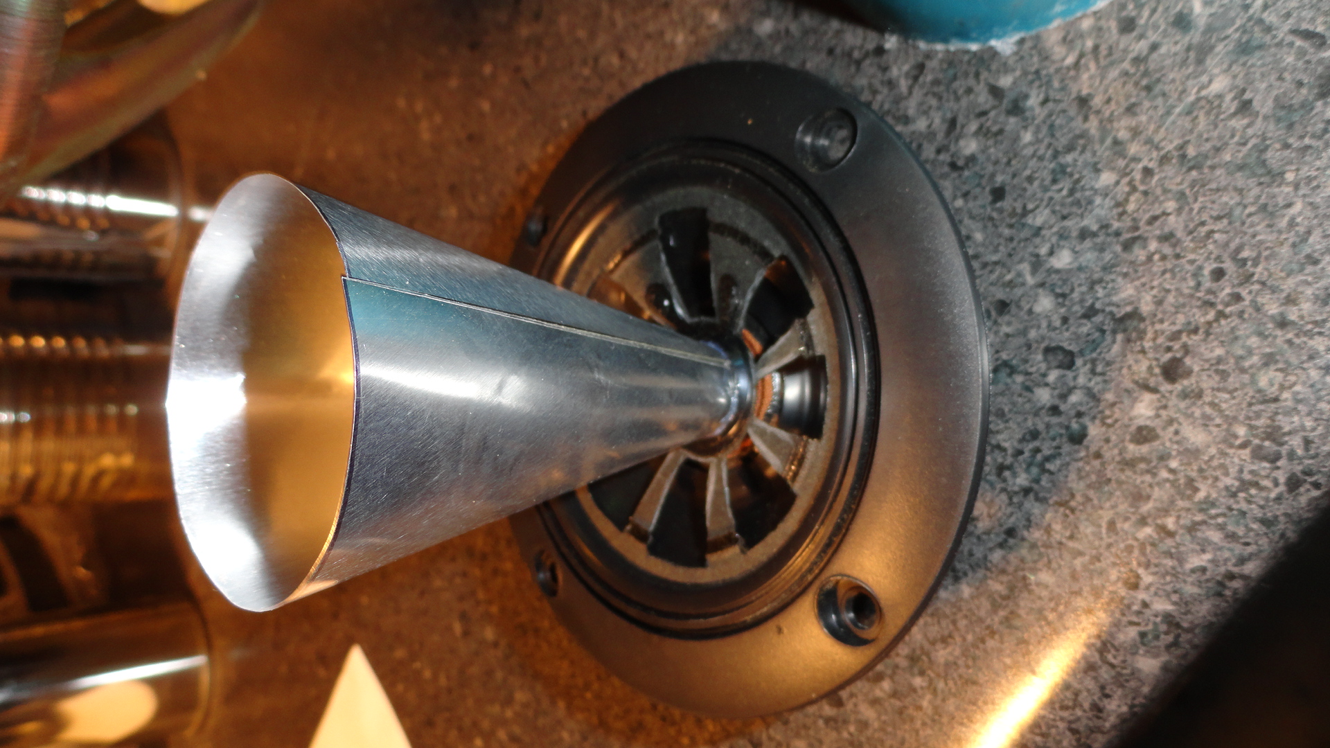

Been playing with those former Pioneer drivers...
The tweeters sprouted the recycled cones from the previous experiment and some fancy knife work on the former cones to keep the voice coils' aligned.
The mids (as well as the tweets) are closed back frames so they'll have a different 'look' then the previous versions. The mids get a pair of cones recycled from the v.1s because I'm just lazy enough and they happen to be sitting around unoccupied...
The woofers are an excursion into new territory. I've not attempted to make this large of a cone before, and the litho sheets aren't large enough to make the cones from a single piece. So, *tah dah*, a 3 piece cone with vertical seams. Ought to be interesting to see what happens; it'll either fly or flop.
The mids and woofers will need some base assemblies routed and glued up. This iteration will also have moi' paying better attention to v.c. alignment to avoid the 'tweak' I had to do with one of the v.3s' to get it to 'play nice'.
The original array was rated at 150w., so I'm hoping they'll respond to being 'pushed' a little harder. The woofers with the new cones will need a push; the cones will likely be heavier than they're used to...
Since I salvaged the xovers, this gives rise to answering another curiosity I've had:
What would a vertically aligned 3 way Walsh array sound like?
A 'bargain basement' MBL? Or just really strange? *L* Guess I'll just have to find out.... 😉
(...and the tweeter pic Refuses to stand upright...*sigh*)
We'll call this batch v.5/3, just for grins...more as it develops

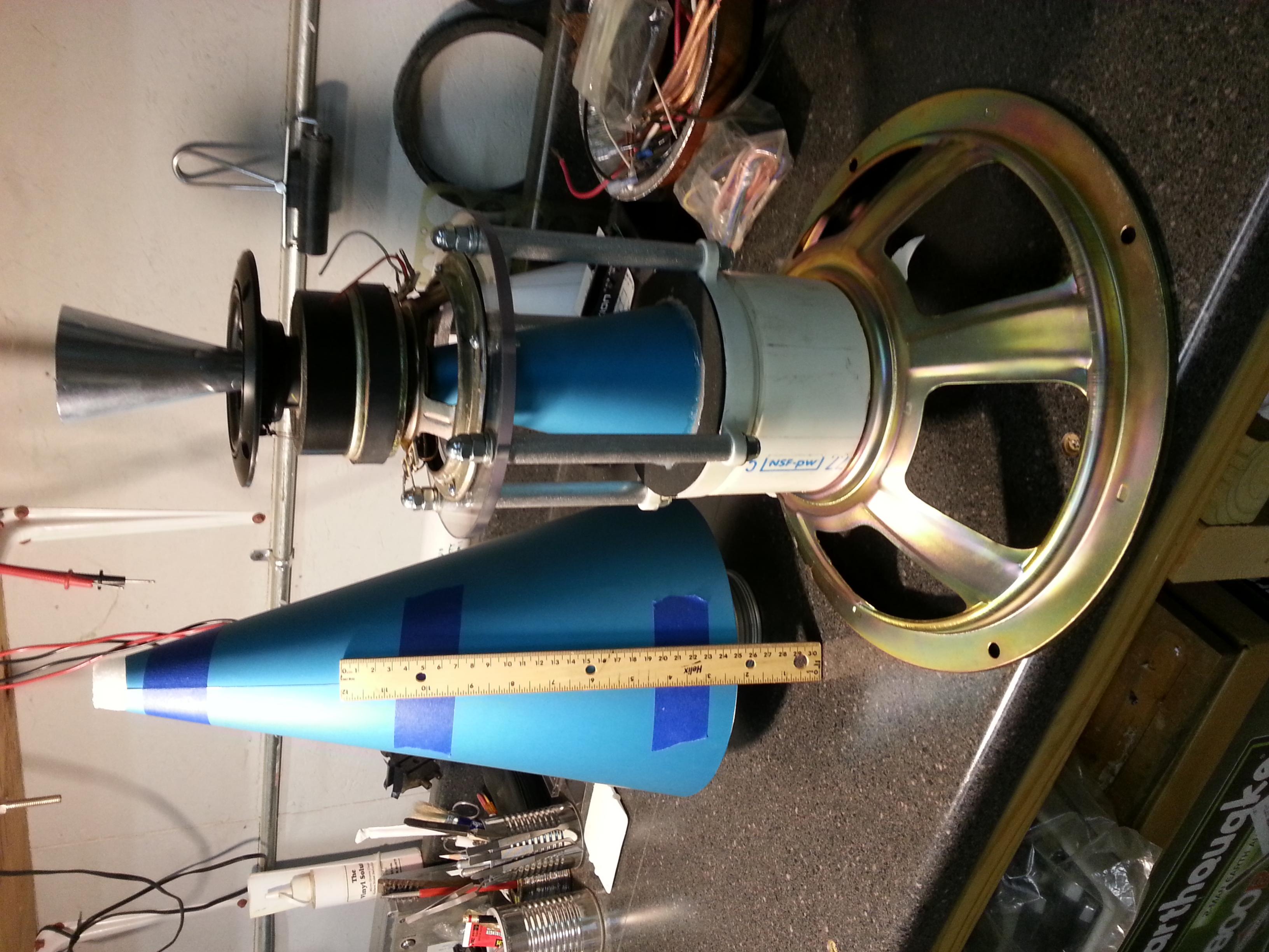

The diversion continues...
Yes, they're big cones...lighter than they look, too.
Next to is the stack they'll go under. The mids will be a little different (that's a v.2 'standing in'), but essentially the same.
Bases and structure next...*S*

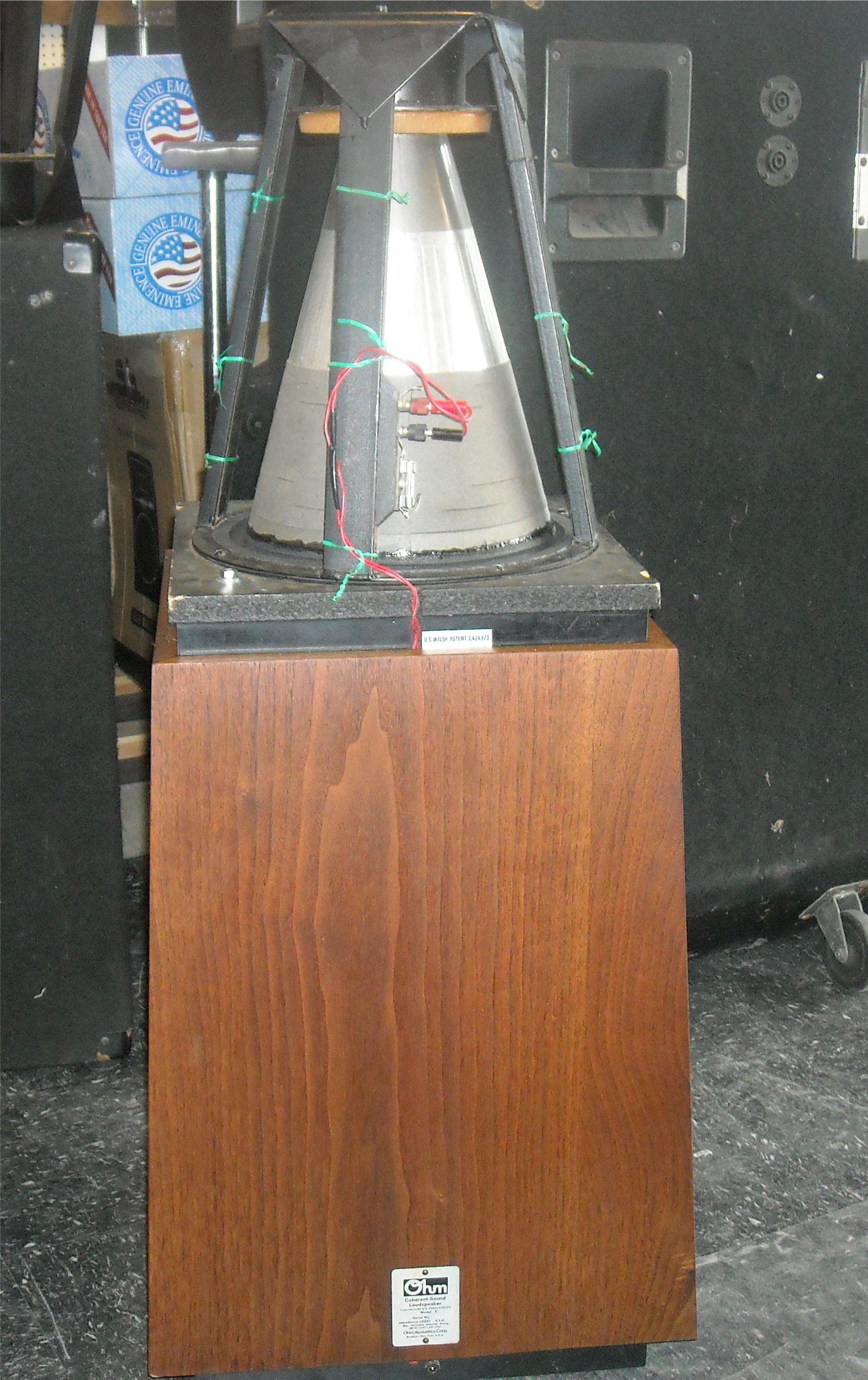

On a more appropo note for 'here', I stumbled into this pic. Now I don't feel the need to apologize for my 'build quality' on my little toys...
Now, given the age of the unit and its' unknown hegira over its' life, I can understand 'wear'....but tack welds, rough fillet welds at the spar bases? The glue line at the cone base? *Ick* The cone itself looks smooth, but even it has some roughness at it's seams. At least I don't resort to 'twist ties'...how tacky Is That?!. *L*
I've read discussions about the build quality that came out of Apogee when those units have been opened up for repair. I'm really happy to see båndsei using a 'puter driven cutter to make his foils for his AMT DIY project, using a 'downscaled' bit of tech that's not expensive anymore, is incredibly appropo and is accurate enough that his 'toys' are rivaling the measurements of the ESS AMTs'. I can only hope to do so well. If they (mine) get good enough to make you pause, turn your head, and see your eyes widen...I'd be one happy-tushed camper. *G*
