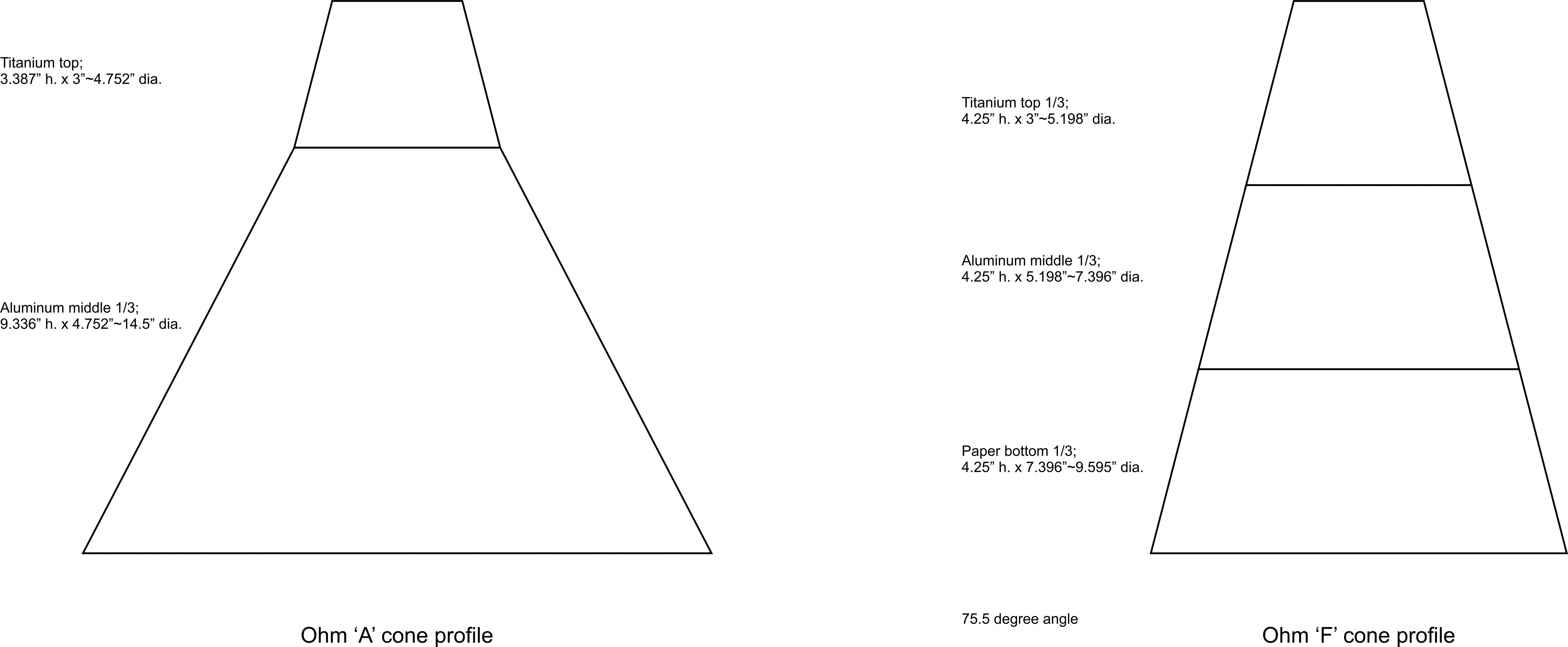

I think Harder's white paper gives the thicknesses of the metals in the "a". Something like .002 for the Ti and .003 for the Al. Too bad they don't use Al plates for small page offset printing anymore- I had pretty good luck with them in my experiments, although it might pay to make friends with a pressman at your local newspaper- they recycle the plates.

Glo, here's a quick 'sketch' of the cone profiles per Harder's descriptions. Perhaps, if your bud is still breathing and in possession, you might only verify these dims.
