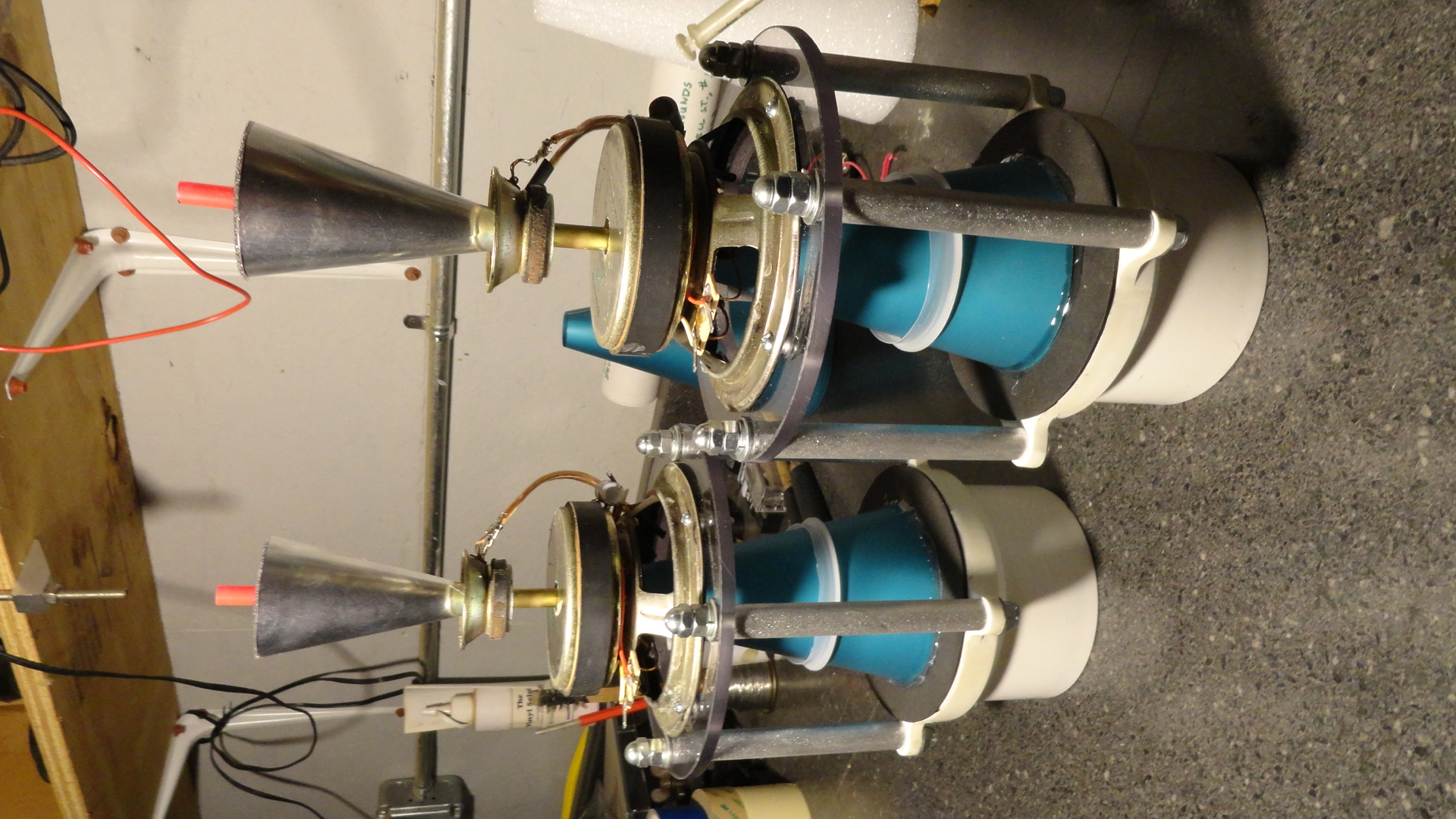

Part of the attraction of 'rolling (literally) your own' of these is that you get to 'play with it'. Since I shot that vid, I've swapped out the tweeters on top to a different pair. Replaced because they had an annoying *screech* at this one narrow frequency that popped up Occasionally...
Banished.
'New' one's...Much Better. Better match.
The units Finally got off the car stereo/small sub in the center, my 'test' rig.
The units you listened to are driven @ 100 a side. The Polk sub behind the
'test' set is the bass that you can't hear....at all.
It's so much better that...REALLY. I can play them quite loud for a 3" cone on a 1" voice coil of a previous 4" 3way. I resist turning them higher by remembering "...it's only a 1" vc..."... And I rather not blow them up.
....and it does So Well with that piano...
And I've not tried any serious eq....yet...*G*

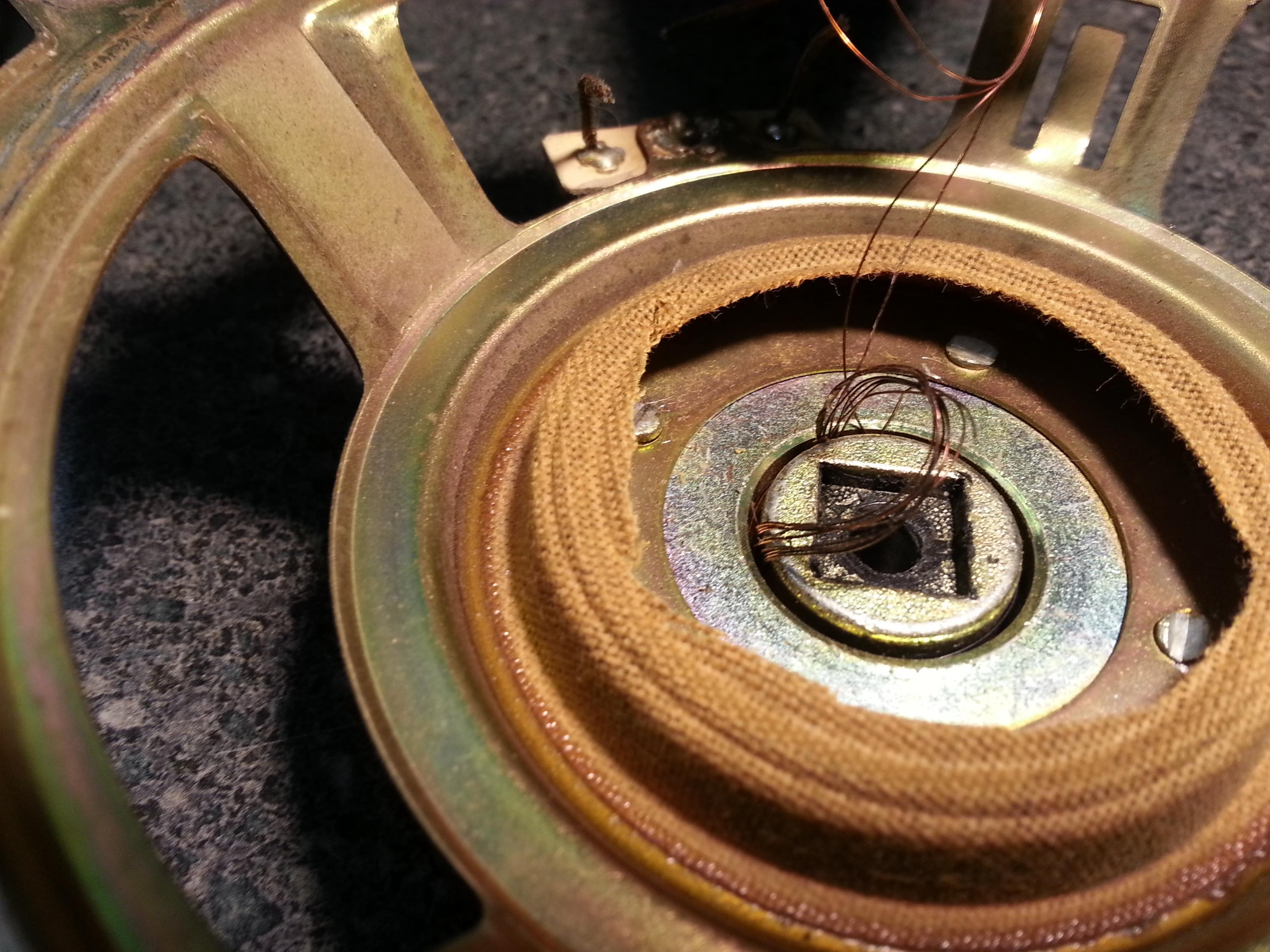

I wonder if there's a way of determining which voice coil/spider/magnet combination would work best with the needs and limitations that seem to be inherent in the design of a Walsh.
Instead of a 'motor' that can move volumes of air by pushing a larger relatively compliant cone, here we have a restrained cone (since the bottom edge needs damping) that has to be strong enough to generate the waveforms in the cone.
This restraint and resistance limits the movement of the voice coil, which seems to me to be a great way of inducing 'voice coil heat death'.
Which has just occurred for me, but it was expected. But it does indicate something to me, which is that a Walsh requires a voice coil that can create a lot of energy within a very limited range of movement.
Or, go with the 'standard model' of voice coil and deal with the surround/damping of the cone bottom edge, absorbing movement while absorbing waveforms....
An interesting conundrum. Since I don't see buying anything at this time to test this theory, I'll go with the 'standard model' and allow move movement with a different form of damping. And save the alternative for future consideration...

There are certain voice coils and spider/magnet combinations that will suit the walsh driver. There are no limitations but actually what makes the driver special. Though it does have limitations outside of these parameters. A voice coil that creates alot of energy in a short range is miss worded I believe. I believe you are looking for high bl factor. which is necessary in a walsh type driver for other reasons. I allowing move movement directly contradicts walsh type behavior you will end up with a weird piston driver. You do not absorb wave forms but the time till dead will shorten with any given material. Look up how to do this. There are several materials on this and I have a little library of this information. If anything I way is wrong or miss worded please correct I know I am just an amateur like the rest of some of us.
*L* Well, in this situation you're Definitely more knowledgeable about the subject than I am, believe me. And I likely have misstated exactly what I was attempting to describe. In fact, I don't have a great grasp of the parameters of speakers; a 'high bl factor' at least gives me a big hint as to what I should be looking for in the future when I make the 'great leap forward' and actually buy something specific to modify. At this point, I'm still in the learning curve of how to make these in a relatively repeatable fashion that yields at least a pair of drivers that sound reasonably the same.

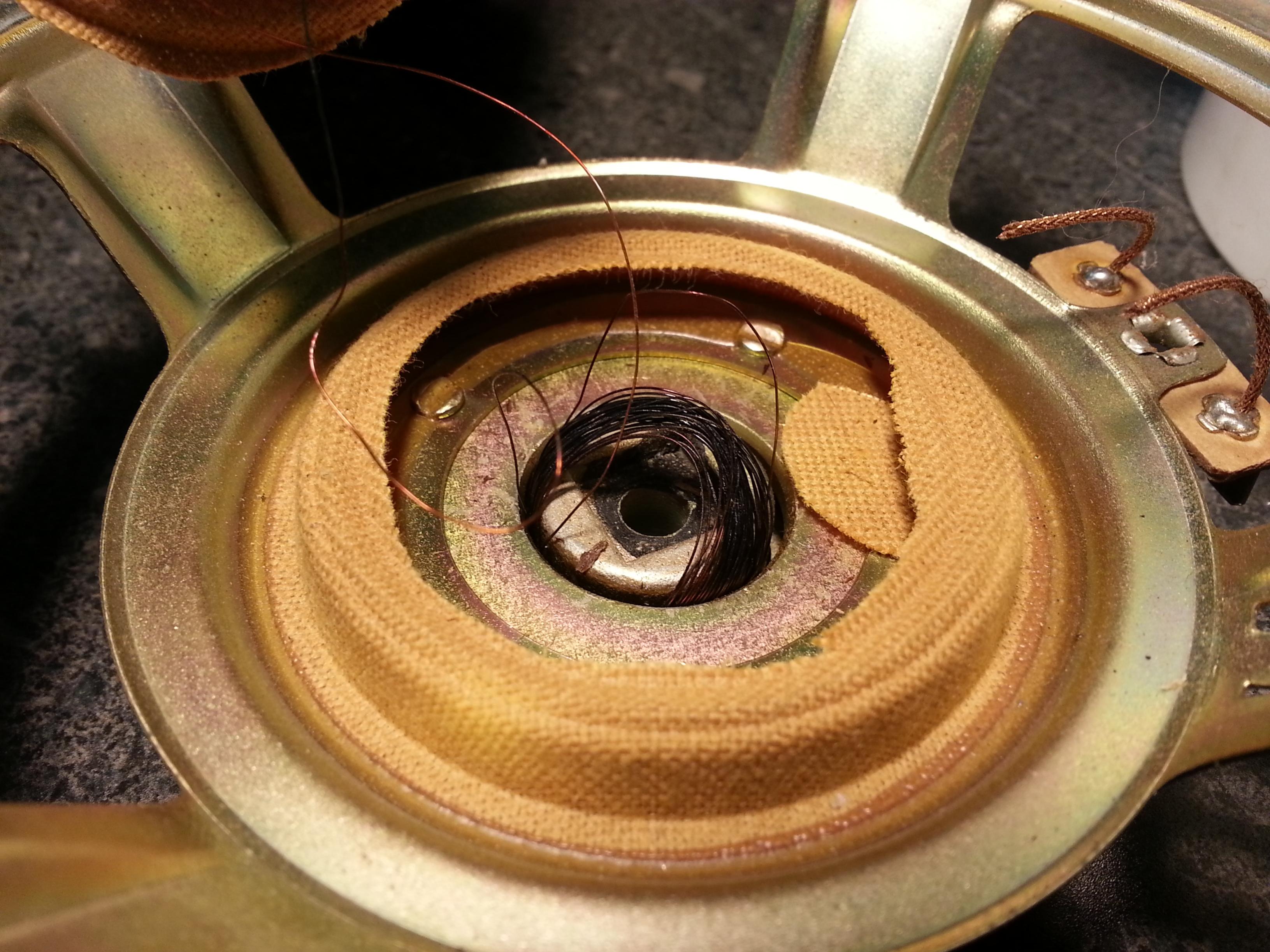

Blowing up some cheap drivers' voice coils was more or less expected. I was pleased that they did what they did for as long as they did being slightly abused in the process.
I really do appreciate your thoughts and observations, Mags. There are gaps in my knowledge of what I'm doing that would likely astound you, and I think I'm standing on the edge of one of those chasms.
...and I will go educate self on 'high bl factor' so I can begin a more intelligent approach on this little adventure. What will become of it? I've got no expectations other than documenting what I'm doing, what I'm learning, and the 'whys' involved so perhaps that anyone who'd care to try this would have a guide to go by. If anything else occurs, I'll give it some consideration.

V2...
In 24 hours I'll know what hath been wrought. And yes, those are straws in the tops of the tweets, centering the foam damping at the edge only...which I'll swap out with EVA for comparison....
...if they work...
V3 cones in the background, even if they don't.
