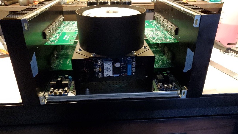

The 4 pair board is 347mm long, which essentially means the entire usable area of a 400mm heat sink will be used. Making the decision between the 3 pair or 4 pair configuration gets down to what your goals are. It's easy enough to use 200W outputs on the 3 pair board and you'll have a very powerful amp capable of doing whatever you want within reason. If you're intrigued with the thought of a bi-amp configuration for your speakers, as I am, then the 3 pair is the only way to go, if you want to use a single chassis. I simply mounted the boards perpendicular to the heat sink. Using the 5U box provides just enough room to accommodate the 3 pair boards, speaker protection, PSU, etc.Looks like a 3 output version will fit on 300mm deep heatsinks, but the 4 output version will not. What height would work best? I am using 4U x 300 heatsinks for most of my builds.
![5U quad wolverine.jpg 5U quad wolverine.jpg](https://www.diyaudio.com/community/data/attachments/922/922910-9c8969256012b26c0d59654475756e5b.jpg)
I'm hoping to build a lower-powered EF3-3 version in a 3U / 300mm chassis for my parents. The chassis would need to house a preamp as well (probably a BA2018, but maybe just a simple diamond buffer instead). I'm hoping that with 50V rails the 3U heatsinks will be adequate. My parents tend to listen to music all day long, so this project may be doomed from the very get-go. Their speakers are about 87 dB / 1 watt efficient.
SRMcGee, the 3U300m at 50V will be more than adequate and barely warm at all day listening levels with those speakers. A teenage party might be quite a lot warmer. Those 3U heatsinks combined with the case ventilation are very effective. Its just that some of us need/want the bigger case to stuff more things inside.

I want to inform you that a 3U chassis is acceptable only if you place the bord in 90° configuration against heatsink.
