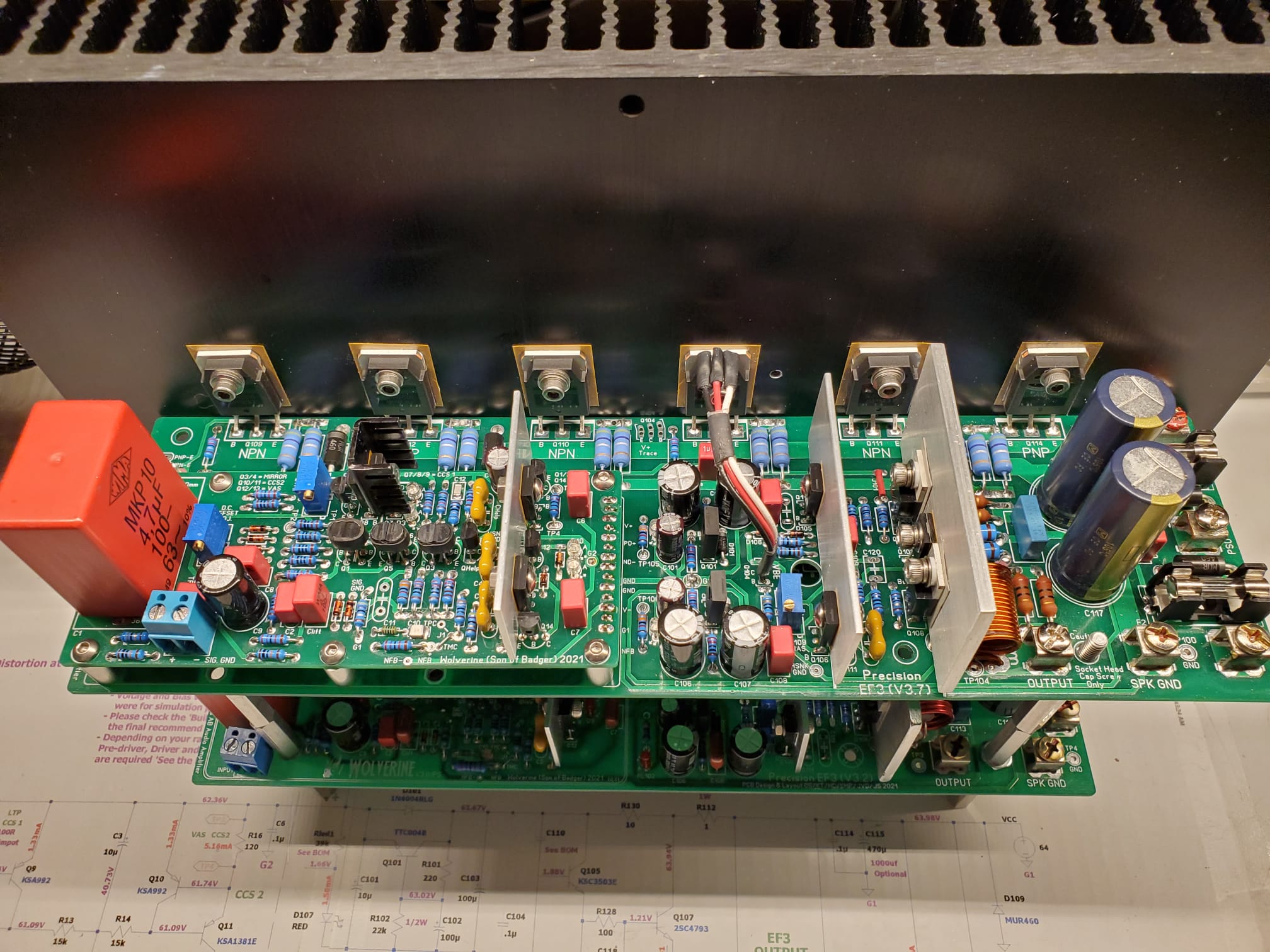

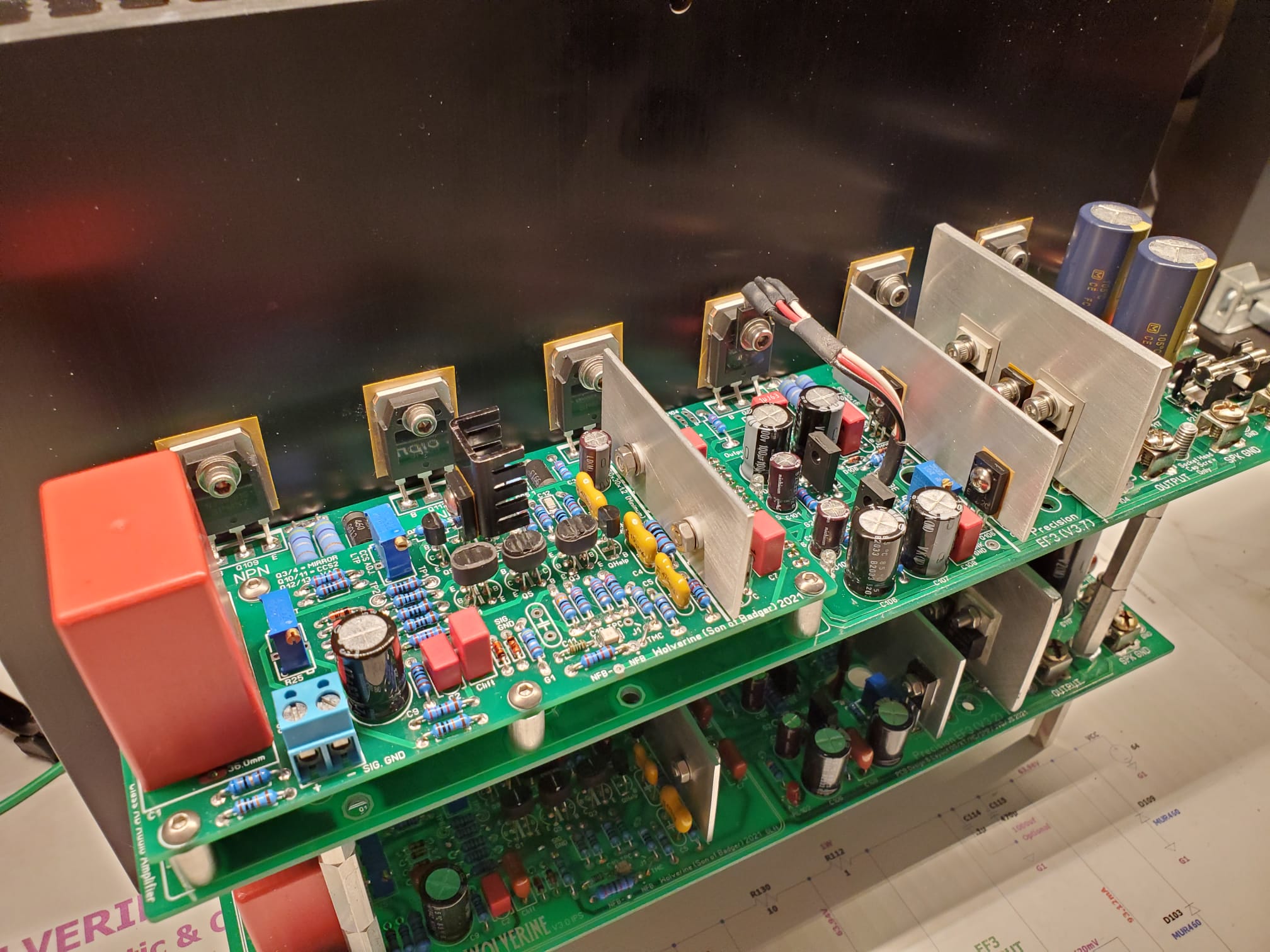

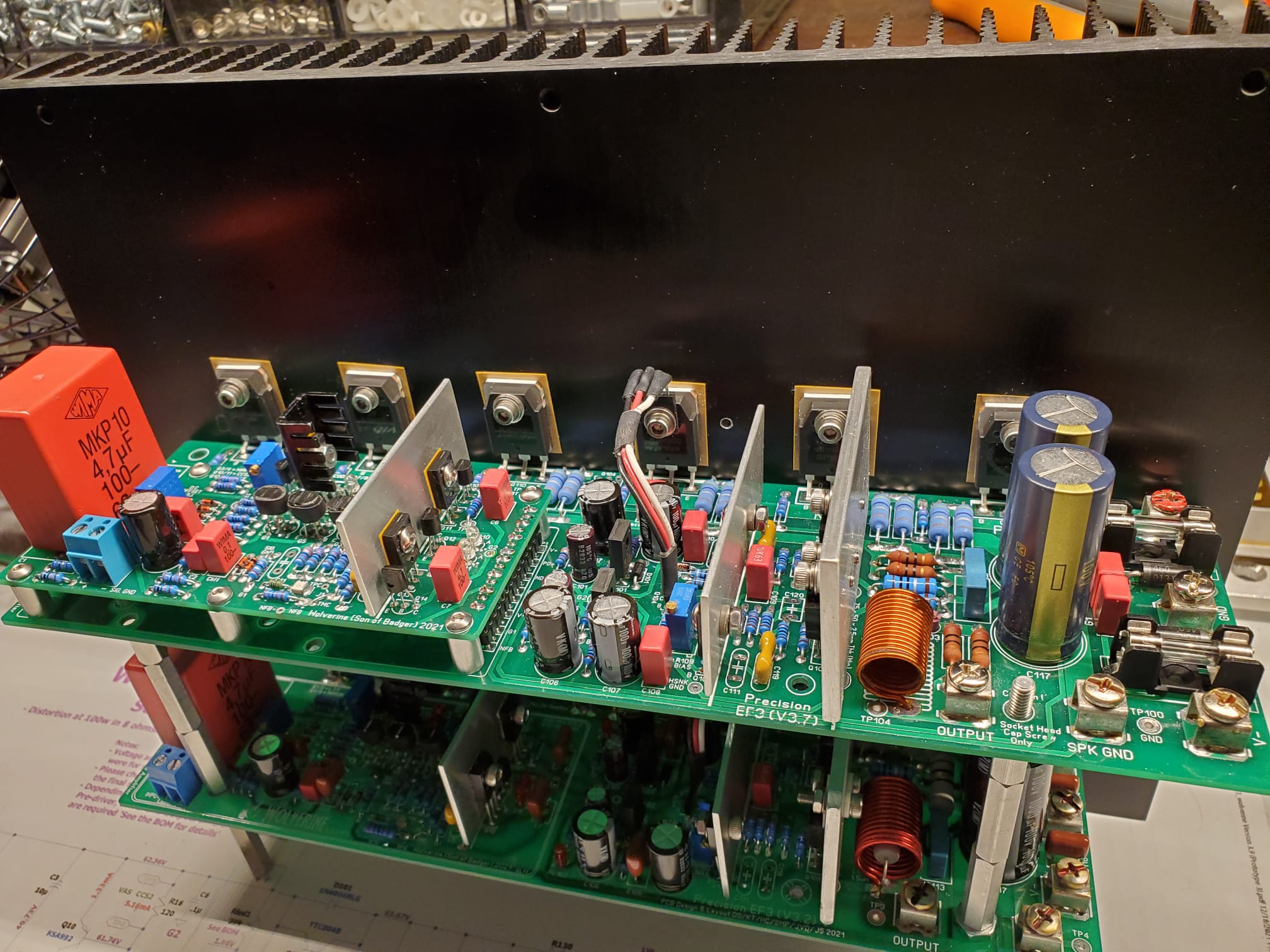

Hi Guy’s.
After some 9 months of development, I’m very happy to announce that the build and verification of the prototype 3 PCB was a success.
Neil kindly built the Prototype 3 for us and followed the build guide to the letter to ensure all the DiyAudio Members that build this amplifier have relevant & clear information on:
Please note that Prototype 3 is on top and Prototype 2 is on the bottom in the attached images.
I can also share some of our distortion measurements with you all.
These measurements were taken on prototype 2 using the QA-401 together with Bob Cordell’s distortion magnifier.
This particular build of prototype 2 did not used matched transistors.
1Khz, 80Wrms, 8 ohm load 0.00006%
10Khz, 80Wrms, 8 ohm load 0.00035%
Neil, has also told me that the amplifier went together effortlessly and just worked. This build provided the opportunity to test and edit the build guide for accuracy and it worked out extremely well. The guide was written to reflect a logical sequence of steps to make the build and power-up trouble free. We also included some technical detail that we thought would be helpful to the less experienced builders.
Although Pete Vogel (Ostripper, OS) was not part of our small team, his initial work and project goals helped to keep us all motivated and focused over the past 6 months.
I would like to make mention and thank the people on this team for all the unpaid time and effort they have put into this project. The names of the members are Keantoken, JJS (Jeremy), Harry3 (Harry), Neilshop (Neil), Johno (John), thompsontechs (Jim), Thimios (Thimios) & Brettn56 (Brett).
Without them this project would not have been completed, researched and tested to such a high standard.
We will spend a few more days verifying the board to ensure.
Please note.
You have all been so very patient and supportive as this development process has taken place.
I wish you all a happy new year and we will update you all once the final boards are ready to order.
Enjoy the images of the Wolverine IPS and the Precision EF3 Board.
- What to consider prior to building this amplifier.
- How to build this amplifier.
- How to setup & test this amplifier.
