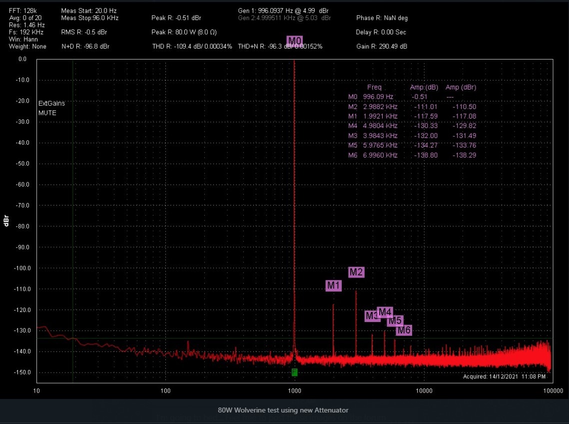

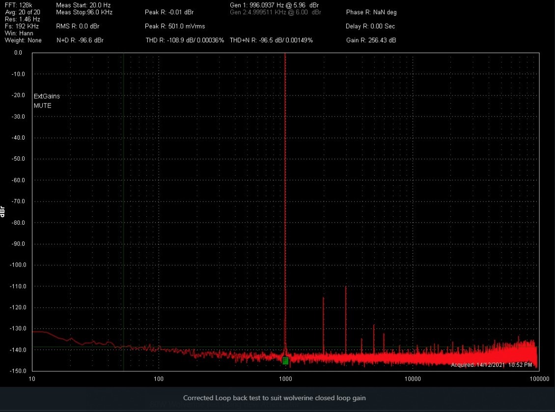

Note: The floor is under our loop in this test, so we really don't know what the figures will be until we build a magnifier and test again. What we do know, is this amp is very quite. Once the next version is built, I will do a tough love review of what I hear. If it's good you will know that, if it's not you will know that too.

The design and test team would like everyone to know that we believe we are there! This has been quite a journey, one that has been compounded by parts availability and the variables/challenges that occur as a result. The team was not willing to compromise on the performance goals, so numerous tests were conducted to optimize performance under a variety of circumstances. The input stage, various driver combinations, as well as amplifier performance using several different output devices required testing. It was necessary to evaluate the various combinations in order to understand the different needs of the various builds and create a BOM with enough flexibility and guidance for everyone to be successful with their builds.
Now that we feel that the board design is complete, before we make a substantial order for boards, we have ordered a couple of “final” version test boards to validate the final version. If all goes to plan, we’ll have the boards before Christmas, in which I will quickly build and test one to validate the layout. No surprises expected, but the team wants to put the seal of approval on it. All that said, if you’re interested in building a Wolverine, now is the time to speak up.
