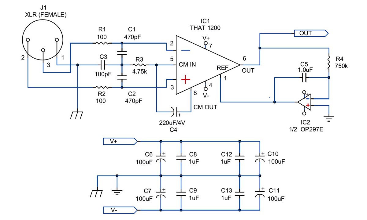

I use this module for BAL to UNBAL
https://photos.app.goo.gl/gvK8meJmGi47osvz7

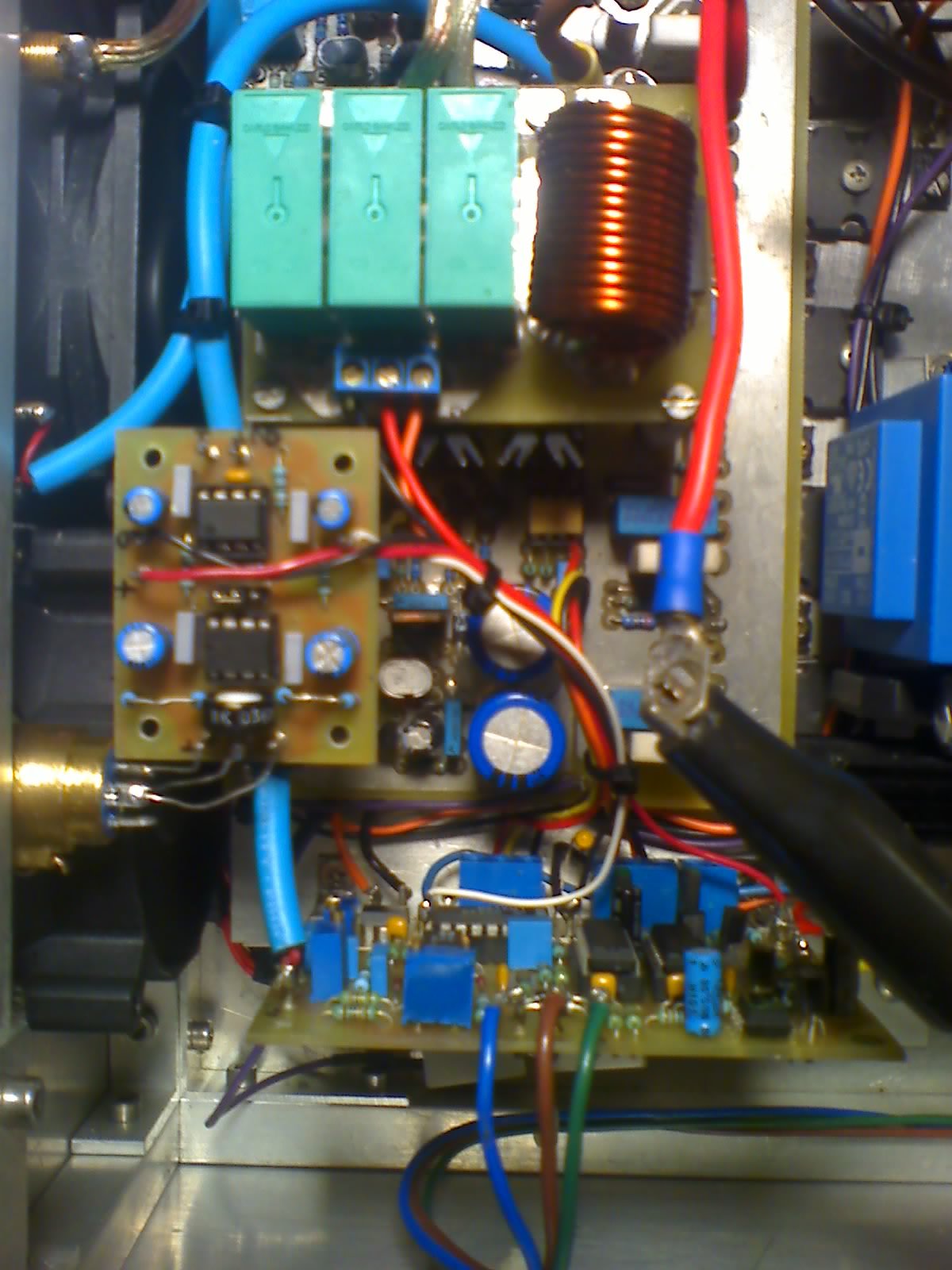

LKA has the grounding done correctly. Pin 1 goes to chassis along with the RF filter. The chassis loop breaker is providing the ground reference for the amplifier and converter, not pin 1. We did the same with our THAT 1206 converter. No need to worry how the source is connected when done this way normally. As an added twist some sources are now being wired incorrectly and the pin 1 to chassis connection at the amp is causing the source to hum.

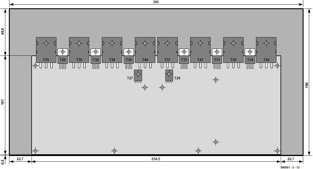

I have a question about the EF3-4 board. I know you can use it with only 3 pair, but can the board be trimmed down to fit a 300mm deep chassis if run with only 3 pairs? I ask because I am on the fence about my chassis size and my goals for this build.

Unfortunately in your case the EF3-4 board can not be trimmed down to suit the EF3-3 footprint.I have a question about the EF3-4 board. I know you can use it with only 3 pair, but can the board be trimmed down to fit a 300mm deep chassis if run with only 3 pairs? I ask because I am on the fence about my chassis size and my goals for this build.

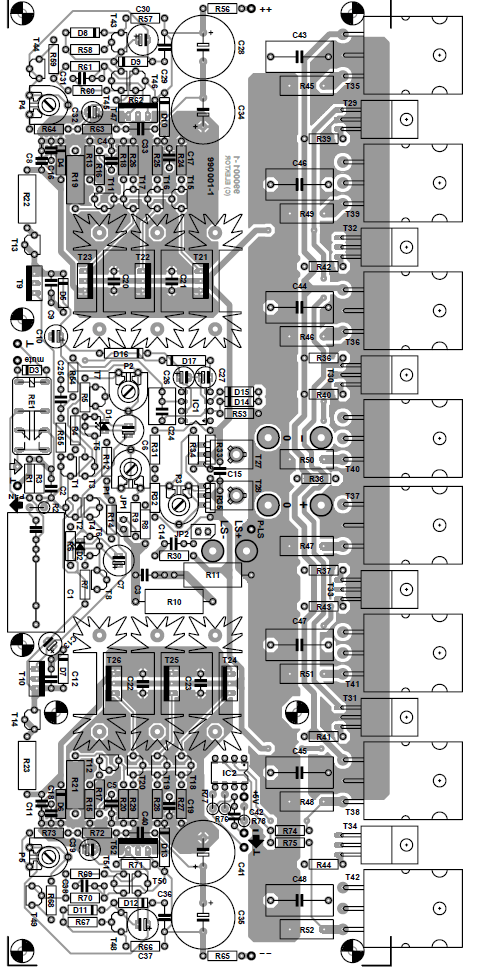

I was also interested in a 4-pair board but I was disappointed by its length. I think that in the board of 3 pairs, 4 pairs of transistors fit with a little work ...look the board of TITAN 2000 4 pairs and drivers ONLY 260mm.
No prolem if they send me the file...Go for it Nikos, its just a little bit of work, as you say, start your own thread and let us know how it goes

Hi Nikos,I was also interested in a 4-pair board but I was disappointed by its length. I think that in the board of 3 pairs, 4 pairs of transistors fit with a little work ...look the board of TITAN 2000 4 pairs and drivers ONLY 260mm.
The Titan 2000 design uses a different shape of heatsink and was designed for use with forced cooling (fans)
The layout of the Wolverine EF3-4 is more suitable for passive cooling (no fans) and the distance between devices will actually help distribute the heat evenly across the heatsink.

I would just like a board with 4 pairs to be more compact only that.....

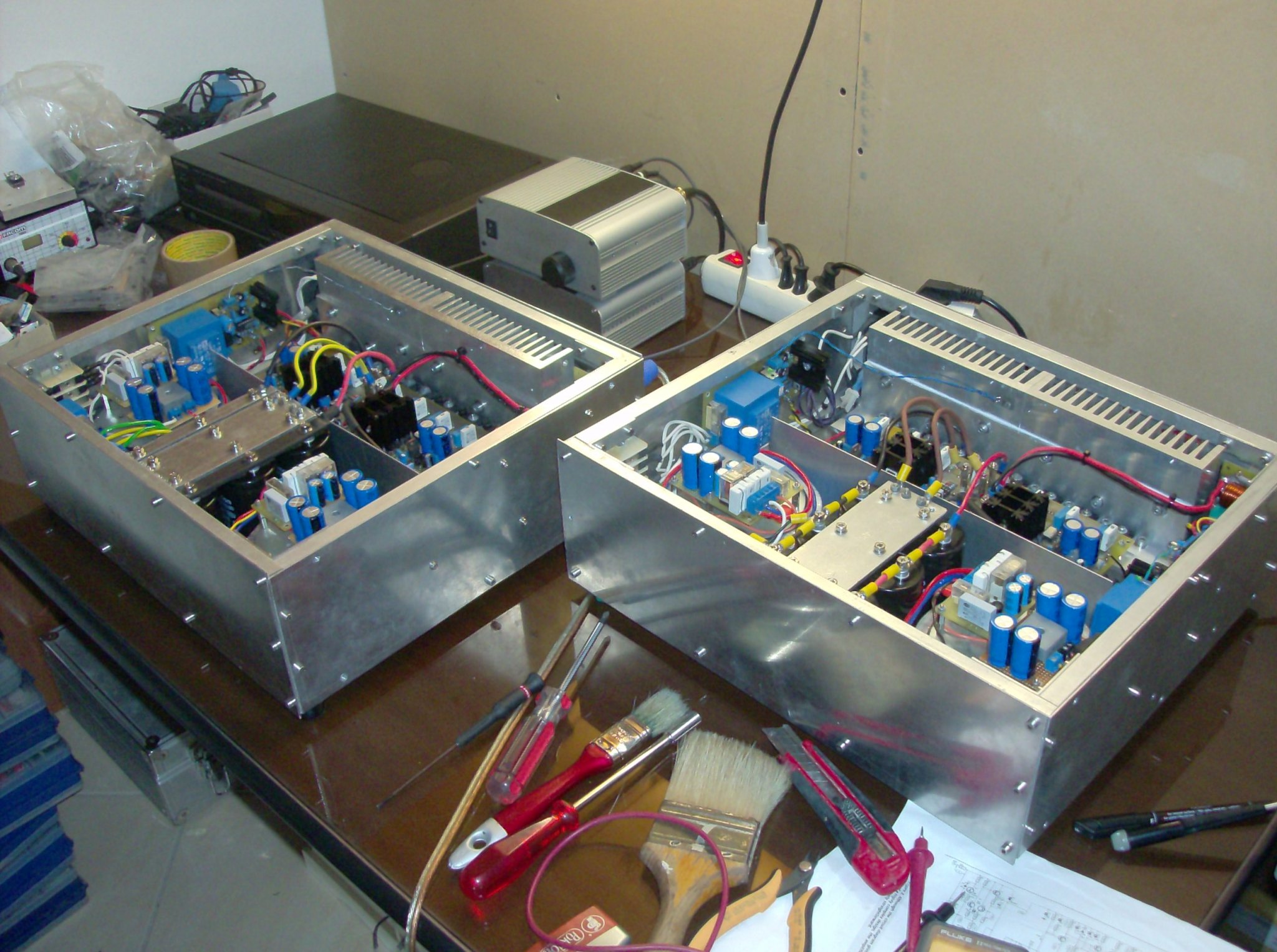

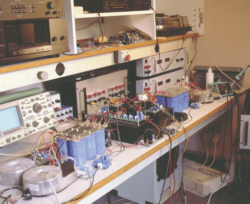

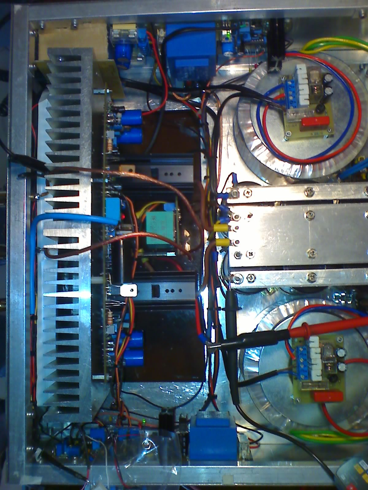

Some pcs 2005-2006 now this amp does not exist anymore....all by hands pcb....
Last pic from Elektor lab...
Yes I remember reading the magazine at the time.Υes my friend of course and your explanation helps
Quite good performance at relatively high power.
