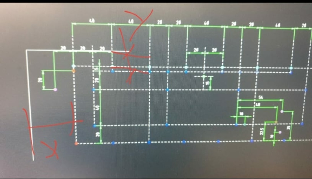

Please supply the following information as I have no heatsinks to measure.Like I said, we are not using the already existing drawing for the UMS heatsink since we are drilling new heatsinks from scratch and because of that we need the outlines
1. Name of chassis
2. Size of heatsink or heatsinks
3. Dimensions from a datum edge to an existing hole that you drill now in the x axis.
4. Dimensions from a datum edge to an existing hole that you drill now in the y axis.
5. A basic sketch showing the other holes relieve to the datum hole so I can ensure my drawing is orientated correctly.
1. Name of chassis

stuartmp and Gianluca:
If you're going through this exercise, please map out the Wolverine hole pattern (in my case, EF3-3) for use on a 3U 400mm Dissipante chassis. I want to build a relatively compact integrated amplifier.
Thank you,
Scott
I've also adapted the UMS layout to the 3U 400 heatsinks to throw our friend Scott a bone in case you want to add the Wolverine hole pattern to this one as well @stuartmp
Can you please consider also 4U 400 heatsinks? Caro Gianluca, vorrei usare il Dissipante 4U 400mm...Sure, this file should help!
Gaetano.
Gaetano.
Yes, here is the file. It's the same one we use for the MonoBlock heatsinks.

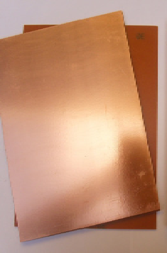

hello please could you print.lay6 of 4 pairs wolverine🙏🙏
I plan to do it manually. with the thoner method and double layer ironing
You will never meet the creepage and clearance requirements. You will spend so much time on this is simply not worth it.
If by some miracle you manage to get a working board that doesn't have traces that short due to the high voltage.
Then you'll need to put hundreds of dollars of components on the boards and when its all finished you will wonder is this a good as the real thing. Please don't waste your time.
Put your name down for the next group buy.
ok, where do I write down my name, how do I sign upWhat you are planning is impossible.
