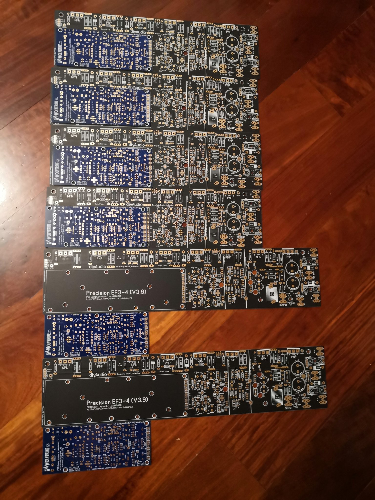

Hello Stuartmp, today well received your pcb, it is packed very safe and high quality made.
However I report my order EF3-4 front-end board, seems you wrong packed EF3-3 for me. Pls chk my posted image and carify 🙏

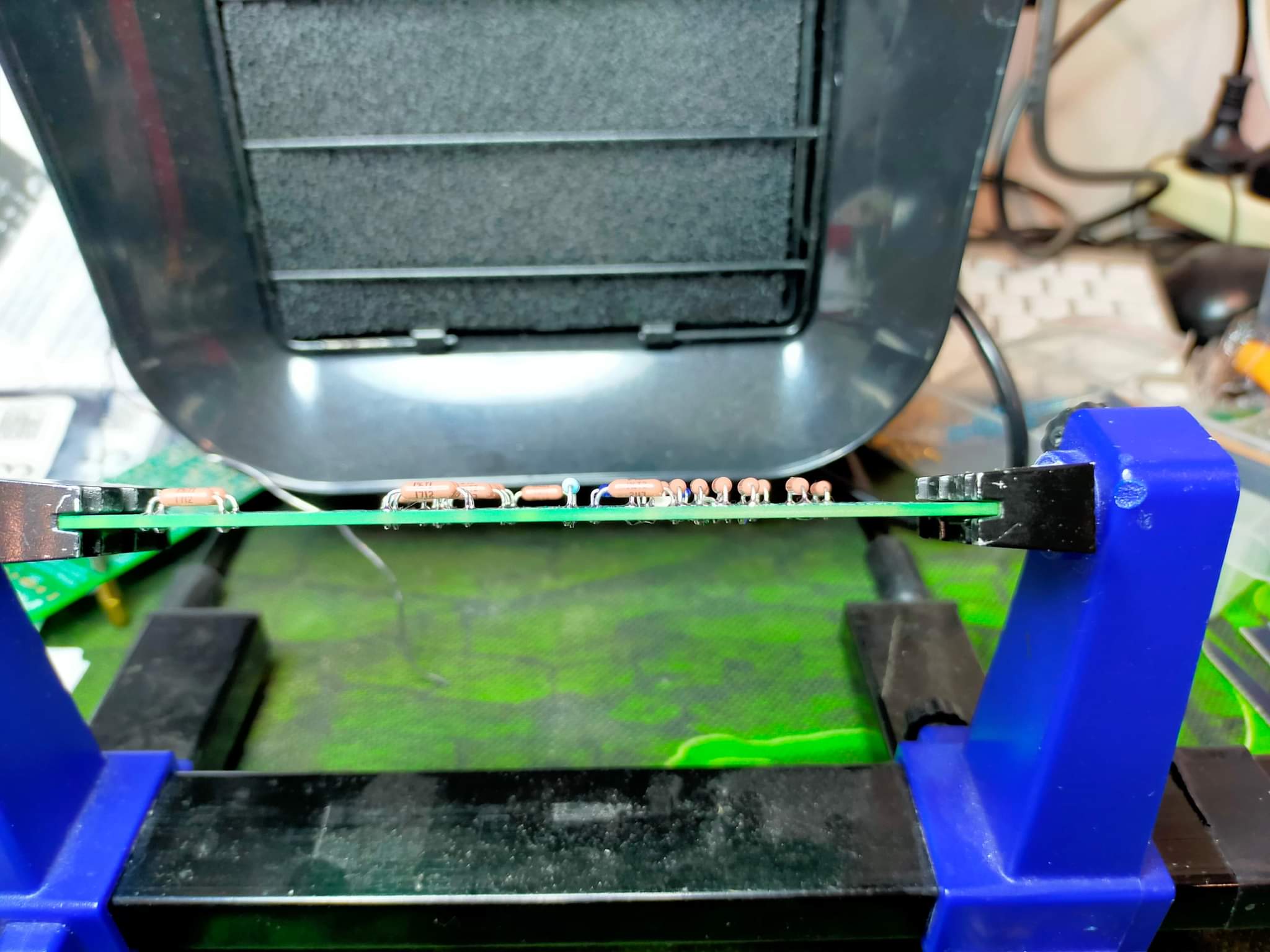

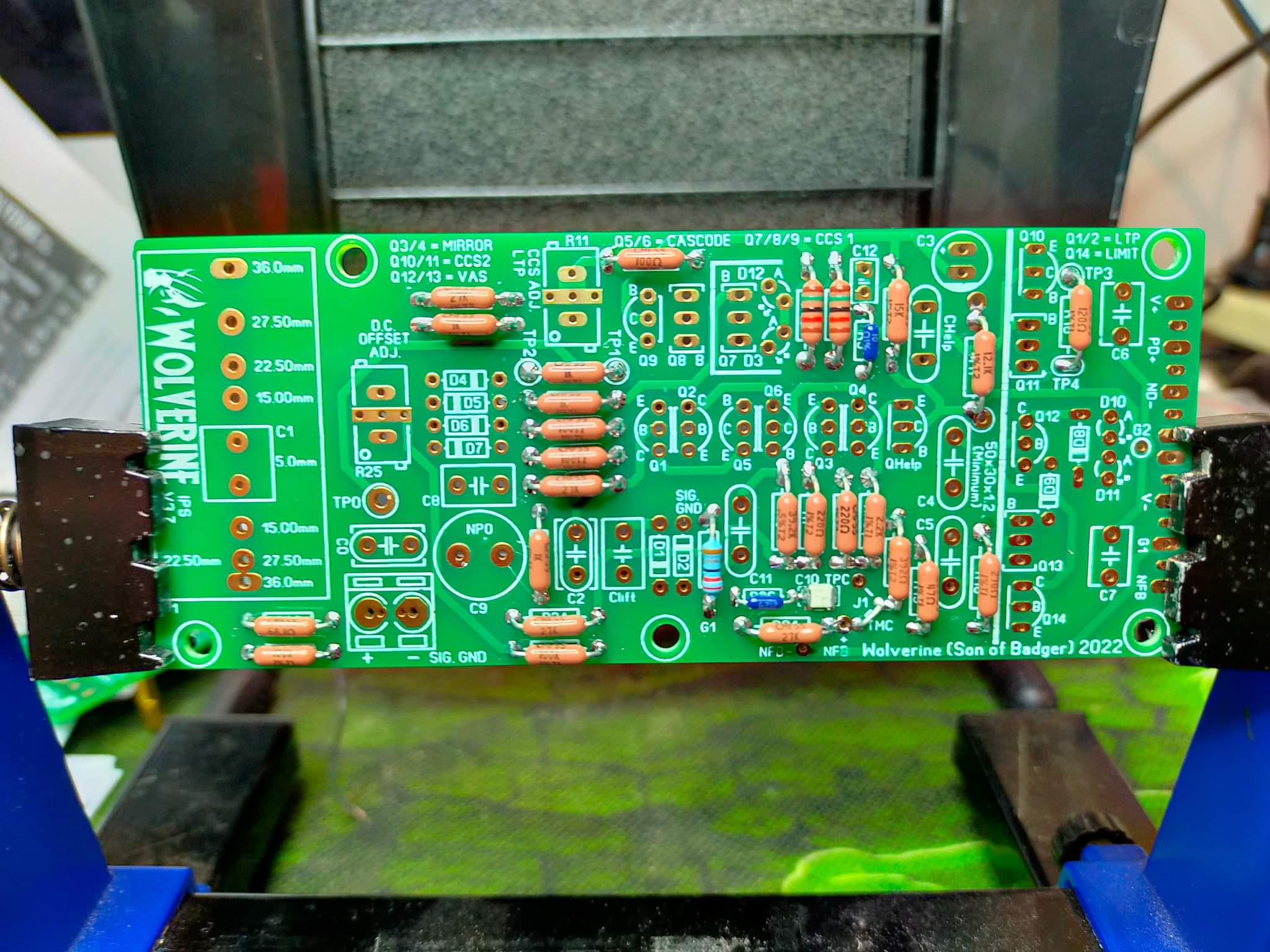

And the build begins!😊
Starting with one small input board.
Took me like 4 hours to measure and match everything and cross and double check values and solder them in. Haven't cleaned the board yet since the initial blank pcb wash, will do the diodes next and give it a good clean then the transistors and another clean before caps etc.
