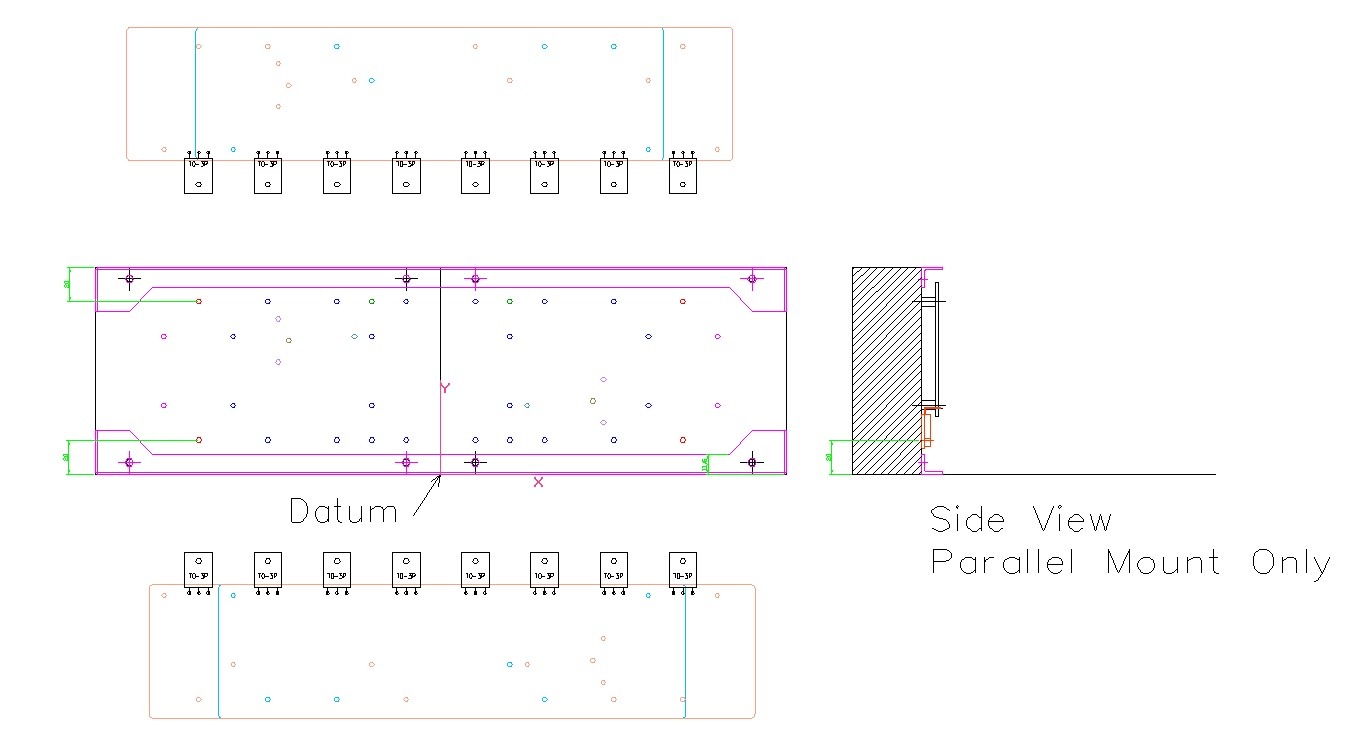

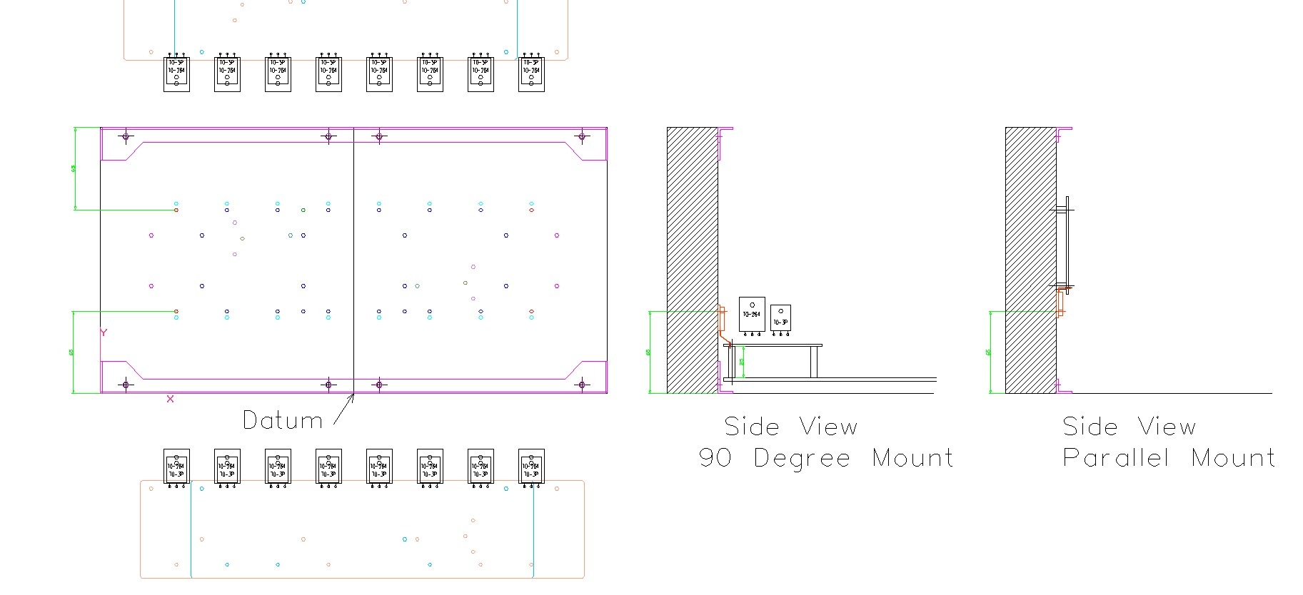

After working for some time with @stuartmp we've finally come up with the final layout for the 5U 400 and the 3U 400 heatsinks which includes both the holes for the UMS template and the Wolverine board! These can already be purchased by those who may need them
@reddish75 @SRMcGee
