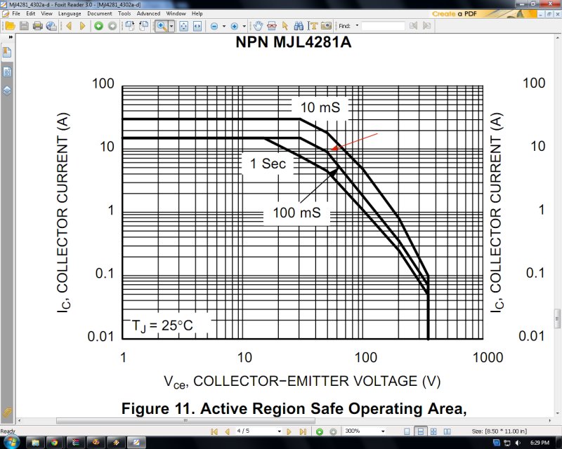

The answer would be in amperes.Question:
For a Honey Badger monobloc with 3xMJL3281, 3XMJL1302, and a load of 2.6DCR, then what what is the maximum transformer (in amperes) that will safety throttle before the outputs could be harmed? Specifically, I'm looking for the "maximized power" figure, such as 45+45vac in case of 8 ohm speakers, but need an answer in amperes to hold back the power in the case of 4 ohm speakers so that output device SOA cannot be exceeded. Assume worst case, music production use (digital organ, 32' stop, young caffeinated organist). How many amperes transformer is safe in these conditions?
Replacing the fuses each time the organist touches a bass pedal would be unsuccessful in a music production environment. If either fuses or outputs blow, the concert is ruined. Same question, different language: Given a monobloc with 45+45vac transformer and a 4 ohm speaker, what amperage transformer can protect the fuses via transformer throttling?Dan -The fuses "throttle" the outputs.

On fuses....
For a electronic organ (instrument amp) ,A Slo-blow fuse is often used.
They also fuse the speakers (audiophiles hate this).
EDIT - they also use breakers ...
For the 100ms SOA of the Badger outputs, a fast blow is used. Coincidentally, these fuses have the same .1 second T as the outputs SOA. If this fuse was 7 amps (I use this for my 4 OP device badger -"the prototype") , then it would pass 14 amps for 100ms. This point depends on the I2T of the fuse (time to melt) .
If one did use a Badger for extended Synth/Organ usage , just a small increase in fuse rating (fast blow- 8A)along with lower rail voltages 40-0-40Vac would make for an OP with 24A @100ms SOA (see chart below -mjl4281) and for 35-0-35vac trafo the 100ms SOA would be 30A! Of course , the fuses would blow at [rating X 2 - I2T] .... 16a , therefore saving the outputs.
For your EXACT question: This is what the OEM's do ! They use an "anemic" trafo that will cause the rails to drop to a lower voltage, therefore entering into a better region of the SOA (below - red arrow/ 50Vdc). An Antec 300VA at 45Vac will "sag" to 38-40vac at 10A (an estimate-based on antek's PDF). At this point you might blow the 7A or 8A fuse as well.
My final recommendation for a Badger "swiss army knife" would be the Antek as-3440 or as-4440 http://www.antekinc.com/pdf/AS-4440.pdf + the MJL outputs.

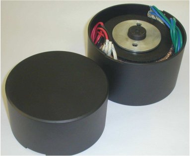

Toroid: Electrostatic screen or GOSS band?
Hi
After looking at toroids for this project I have a couple of questions.
Does it need and electrostatic band?
or a GOSS band, I know it reduces stray fields but does it need it in this amp? Or does it depend on where I place the toroid?

Not absolutely required (a band) ... but , why not ? (below) - http://www.antekinc.com/pdf/CA-xxx.pdf
These look real cool , as well.

Transformer
Bigger amperage capacity transformer might help give you clearer low bass.
