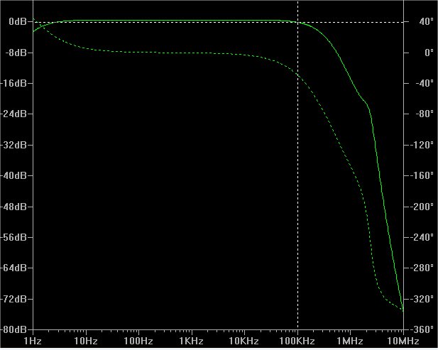

I'm looking at building an amp for my system, and this could be ideal. Have there been any reviews yet or any frequency plots?
Thanks!
Frequency response is (below 1) 5hz-100k+ -flat .
Noise is better than -115db according to my sound card's spectrum analyzer.
I can't hear any hiss from this amp with full gain and an ear to the tweeter.
Much better than any mid priced home theater system amp setup.
Gain should be exactly 41.25db - any source should drive it to clipping.
A few builders have described it here in this thread. I think it is very neutral and reflects exactly what it sees at it's input.
