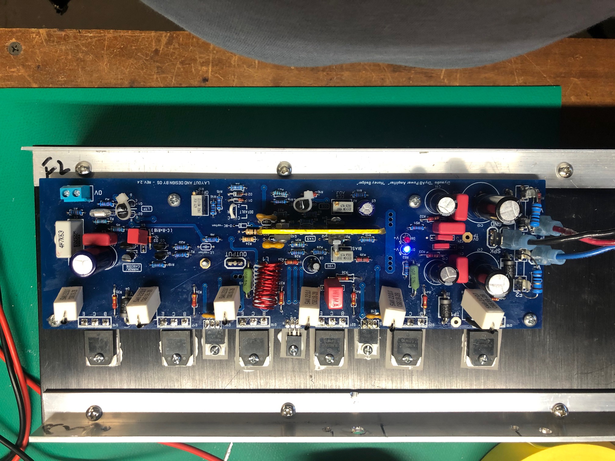

Lost one channel on power up today after 8 weeks no issue
Honey Badger was running really well sounding very good, for over a month , this afternoon I powered it up and I got a pop, opened it up lost the left Chanel , blew one fuse on the v+ side F1 and took out the resistor r53 bias was set at 25 on both channels with no issues prior to this fault!, Need some advice on what to look for and troubleshooting I haven’t replaced the resistor, I am hopping the speaker protection worked I would really be bummed out if I blew my speakers.
Suggestions are greatly appreciated!
Checked all the parts suggested.
Ok so I checked for shorts on all power trans none, and checked the Diodes suggested all look good no shorts, replaced the resistor that went up in smoke R53 That did burn.
Checked for shorts from transistor's to heat sink all good there.
replaced the fuses with 10 ohm resistors, checked the power going in on both rails looks good at 58+ 0 58- on current limited bulb tester, powered the one board back up. I got voltage going into the v- side, and v+ side, the led on the Negative side lights up the positive LEDD6 does NOT light up, check to make sure it was ok and it is.
I have + v on the R 32 on the input power rail side, nothing going out on the other side of the resistor. R32 calls for a 22r value in circuit I get running value, I will have to pull it to measure it. The caps look ok,
Q5 and Q6 Q3 and Q4 Need to be pulled to see if they are OK? Or do i need to look else where??

hard to tell with the info given....i will check the output trannies on the b+ side for schorted collector emitter junctions, an open re resistors can be a giveaway..

Update On trouble
Ok I replaced the R32 it measured open out of circuit repowered the board and I have the + Led back ,
So the question what would have caused this to fail is there something up stream or down stream I need to look at?
I haven't done a full power up just yet looking for other suspects.
