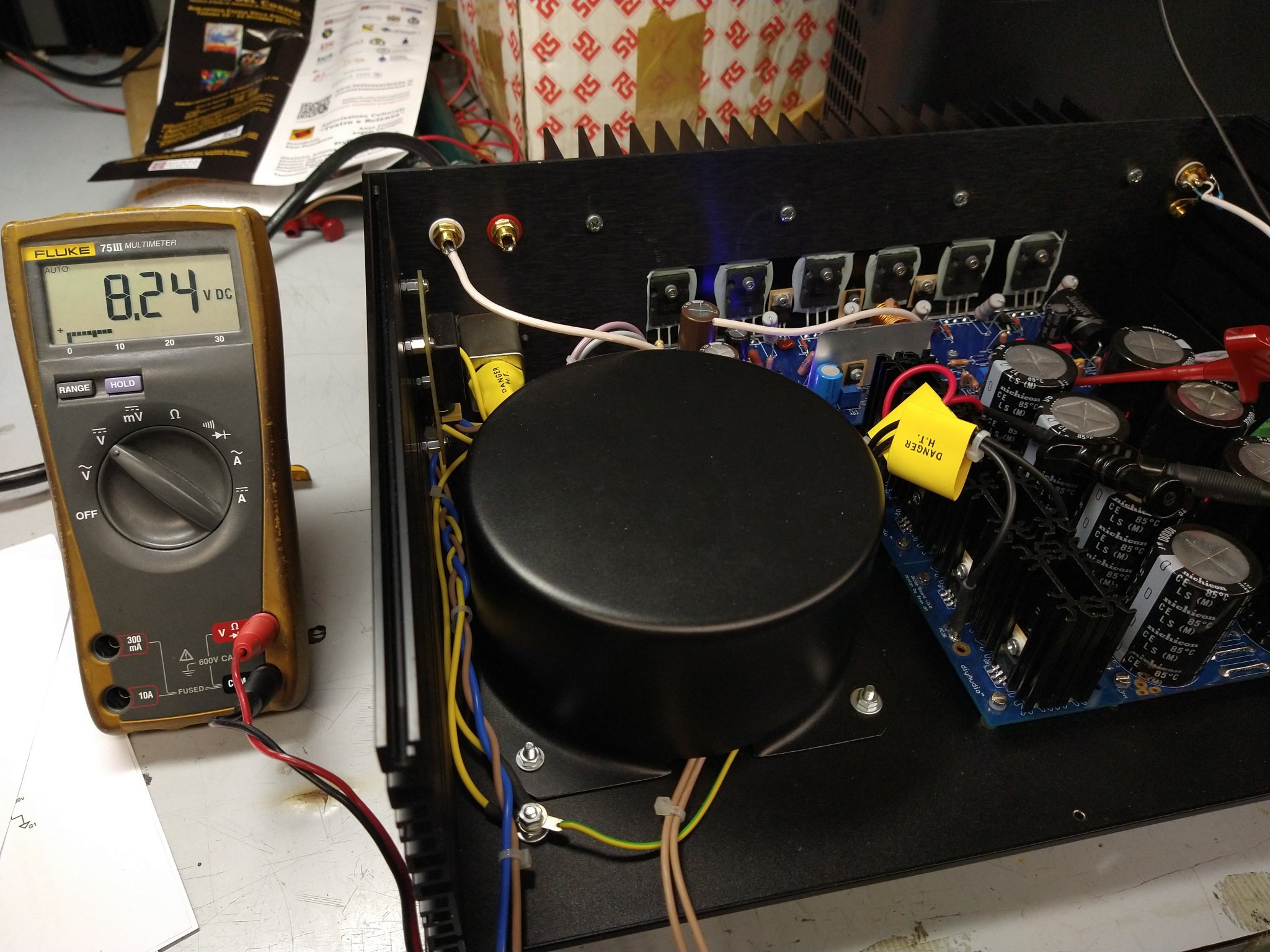

Please change the zener diode to the one I recommend. R19 is 1watt. I mounted it under the pcbThanks for all the feed back everyone. I went back and checked everything and found that Q13 was measuring 55Mohms to the chassis. It turns out Kapton tape did not work as a great insulator. I also found that the fuse in the negative rail measured 1k ohms even though it was not blown and did not show any discoloration. After properly insulating Q13 from the chassis and replacing the fuse the amp fires up again and was able to set the bias, DC offset and R14 voltage.
I still have the speaker hum at idle and my next step is to Pull C6 and test, before change R19.
I have a question regarding grounding, since there seems to be so many differing opinions. Should I connect the signal ground to the chassis ground (120Vac plug ground), or should the audio reference voltage never connect to the mains ground?
Thanks again for all your help everyone.
There are photos in the thread.
Thanks Stuart. I ordered the recommended BZX55B15-TAP and the 15Kohm 1W resistor. Hopefully they will be here this week. In your schematic, are you replacing R19 with a 15kohm or are you putting it in parallel? Same question for R18 and C6.The Honey Badger has is own built in hum breaking resistor R4 4.7R.
Both RCA grounds tabs should be bonded together and connected to the chassis through a 1nf cap. See page 52 (81-RDER73A102K2M1H3A)
The connection of your main earth safety ground is connected to you amplifier PSU zero volt rail via a ground lift circuit.
There should be no connection from the PSU ground to the signal ground terminal. This is taken care of internally on the PCB through the R4.
All there details are in the document above.
Currently the whole amplifier is broken out on the bench and nothing is stuffed into the box. For my input source, I have a signal generator going straight into the input terminal block.Are your input jacks insulated from the chassis? Usually signal ground is connected to chassis ground through a ground breaker. Take a look at the attached document, it contains a lot of information that should fix your hum issues.
While waiting for new parts, I used a bridge rectifier to create the ground lifter indicated in the "how to wire an amplifier" document that was posted. There was no change in noise, so I added the resistor and capacitor suggested on Elliot Sound Products website. Still no change. With my scope hooked up to the output, and the signal generator disconnected, the scope shows a nice flat 0V signal. I have the signal generator turned off, and the amplifier powered off (power supply), but as soon as I connect the turned off signal generator, my scope shows 400 mVpp noise on the output. Disconnecting the signal generator wires at the input causes the noise goes away. It seems like my signal generator is somehow injecting noise, even while being turned off?
I guess the next path is to connect an MP3 player or a different device to the input.
They are not in parallel.Thanks Stuart. I ordered the recommended BZX55B15-TAP and the 15Kohm 1W resistor. Hopefully they will be here this week. In your schematic, are you replacing R19 with a 15kohm or are you putting it in parallel? Same question for R18 and C6.

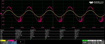

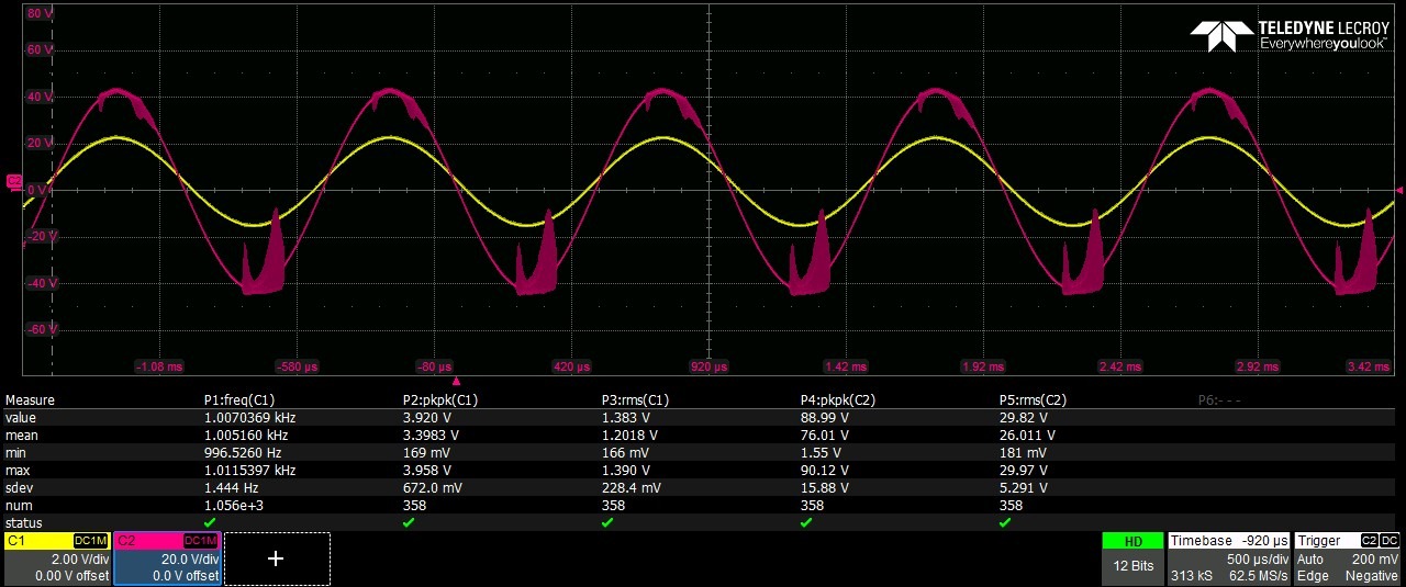

Looks like output stage parasitic oscillation. I doubt more bulk capacitance will remedy that.It seems that 4 x 10000 uF per rail are not enough to give more than 180 W (continous) on 4 ohm! (mono implementation) I will try to add more filter cap close to the PSU board, to see how much it needs
More caps doesn't give you more power. More voltage gives you more power. What size power supply are you running?It seems that 4 x 10000 uF per rail are not enough to give more than 180 W (continous) on 4 ohm! (mono implementation) I will try to add more filter cap close to the PSU board, to see how much it needs
Voltage and VA Rating
Yes! These are inductors with deliberately increased DC resistance

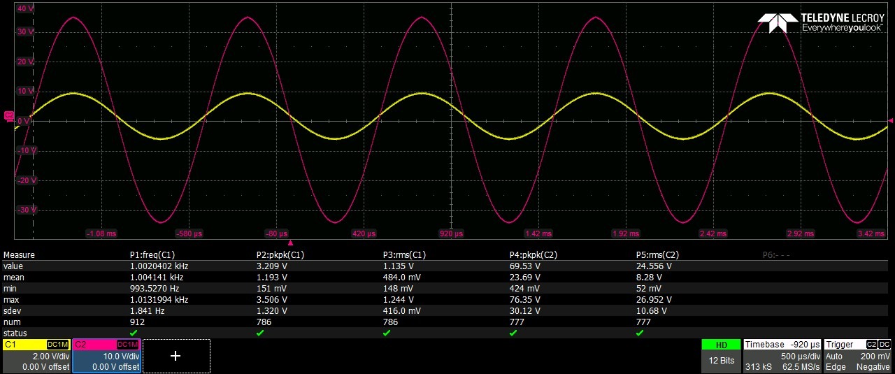

As others yet said, your PSU isn't the first culprit (40 mF filter capacitance per rail is more than sufficient), as isn't the amp itself. You said the supply voltages sag when you observe these oscillations, didn't you? Well, the cause is vice versa: Due to these oscillations the amp draws much more current.
Best regards!
Best regards!
I Agree the power supply is probably not the cause or the oscillation but I believe that the VA rating is a little low.

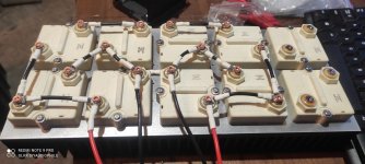

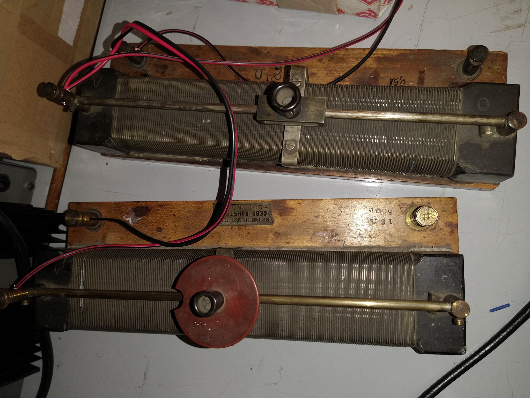

Are you able to test with another load?
These are the best non inductive resistors.
I've attached a table that my help you.
