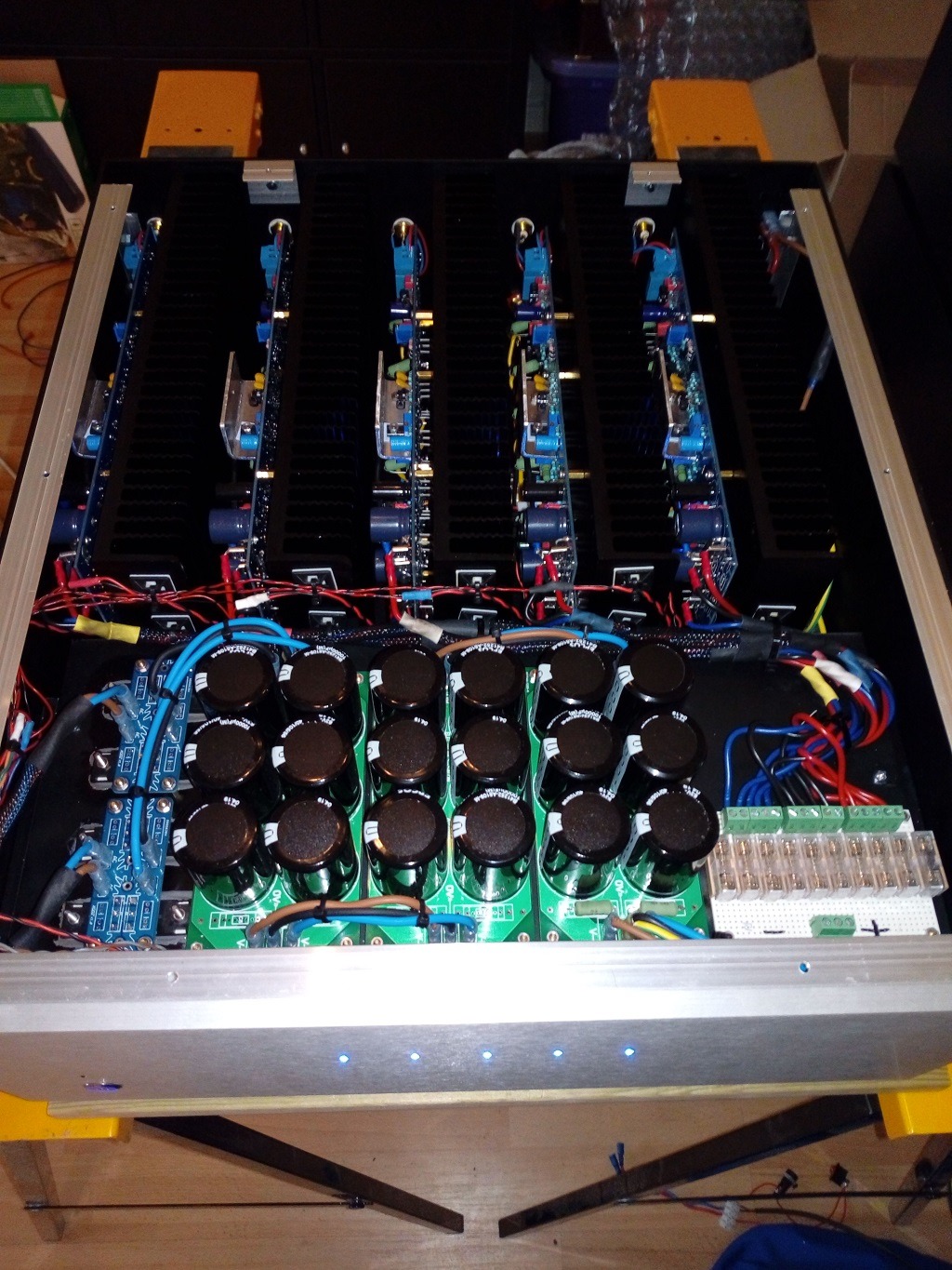

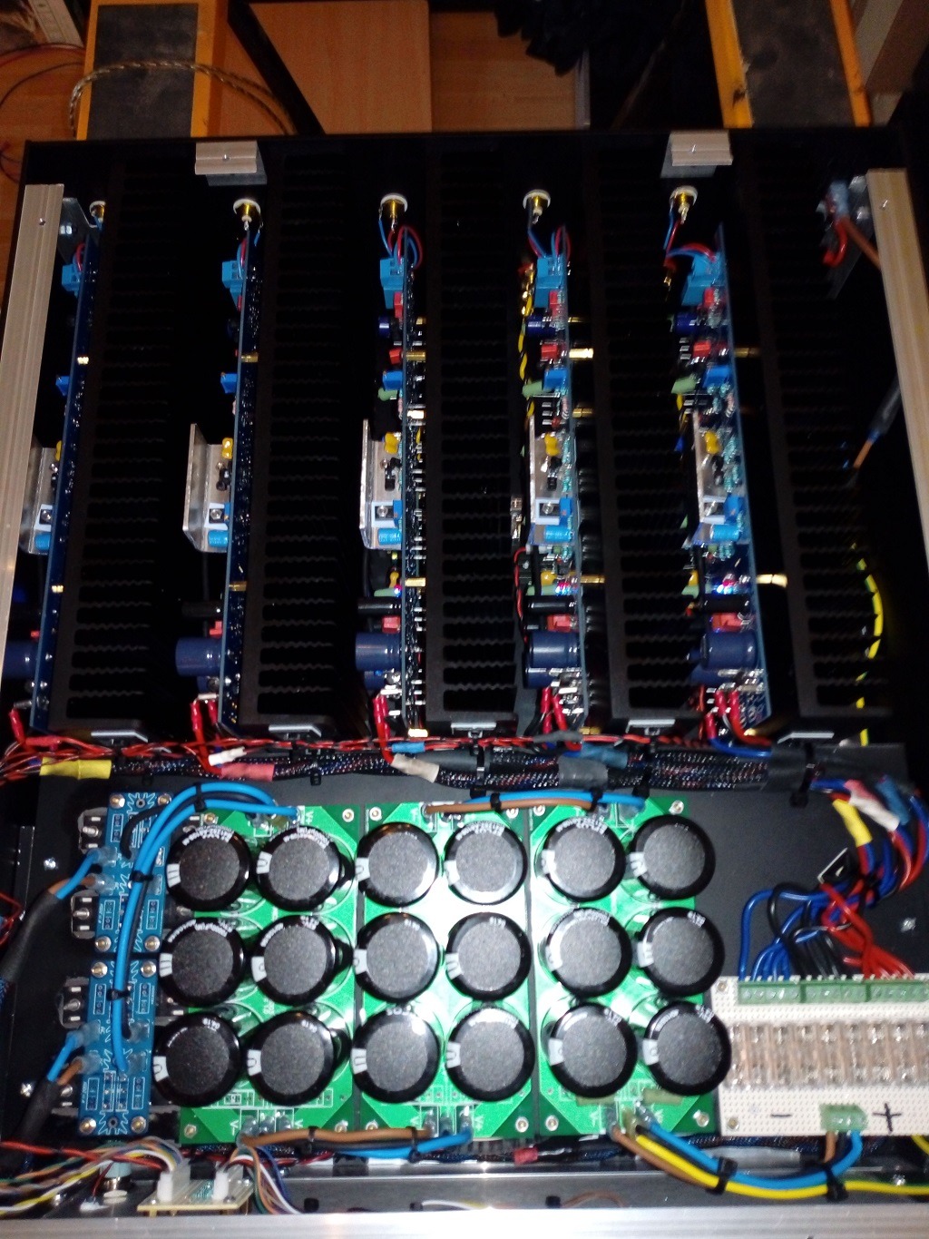

Very inspirational! Have been contemplating a 4 ch build for a pair of lx mini's.Hope you enjoy and get som inspiration![]()
Thanks AudioSan 👌
Glad to help. a four ch yoy say. bass and mid? or mid and tweeter. anyway. i would take a close looke at what ypu dont see. the bottom is cut out for each ch, and the top is only cut out for i bit of that. that creaties a natrual forced convection. more air is fprced /pusced in to the chassis then the air that leaves the chassis. you get å turbulent air between the channels. hat actually takes care of most of the heat.
