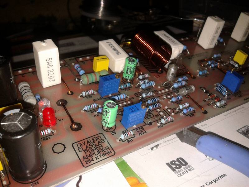

Have just tested this amp with a 2pf mica cap installed as an LC cap. This made sound worse than when using no LC cap which it is now reverted too. I found there to be too much high frequency noise with the LC installed. Without it there is more bass and a better rounded sound.

thanks for information regarding LC Cap.Have just tested this amp with a 2pf mica cap installed as an LC cap. This made sound worse than when using no LC cap which it is now reverted too. I found there to be too much high frequency noise with the LC installed. Without it there is more bass and a better rounded sound.

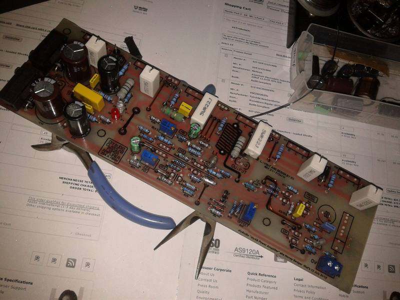

Mouser Parts
For reference, here's a link to the BOM
See if I made the correct selections?

Howabout right now?Is there an ETA on getting BOMS with Mouser part #s?
