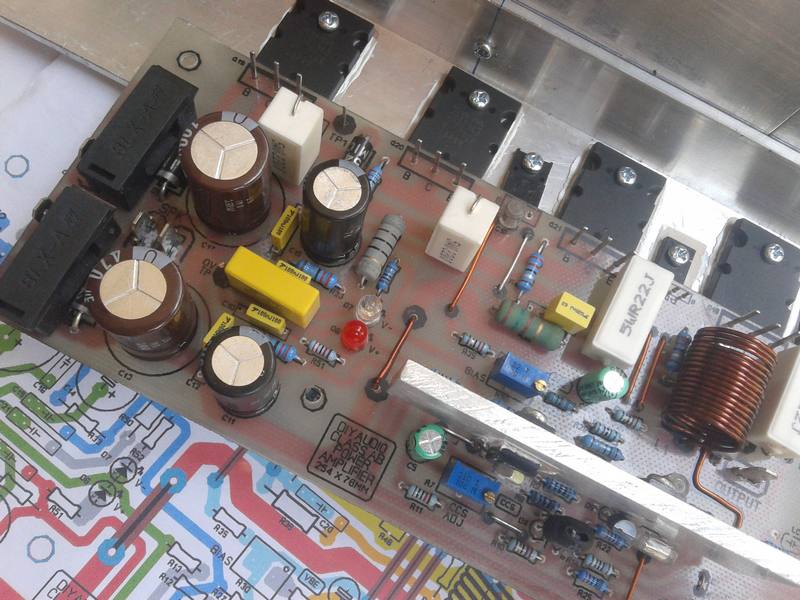

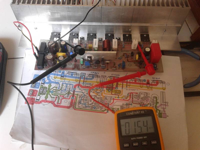

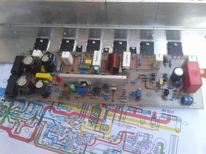

my first channel HoneyBadger ...
it glow! it stable and it sing very good
it glow!
it stable and
it sing very good
What more could anyone want from an amp!

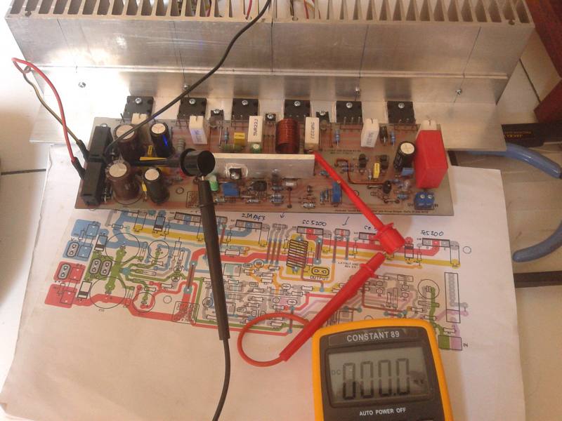

well done mas Naf, this is 0.0mV DC offset
very good building skill you have...
I'm waiting your complete amp...
If possible change mounting position on heatsink so that more solid & better heat transfer
Please tell me the sound review latter okay?
