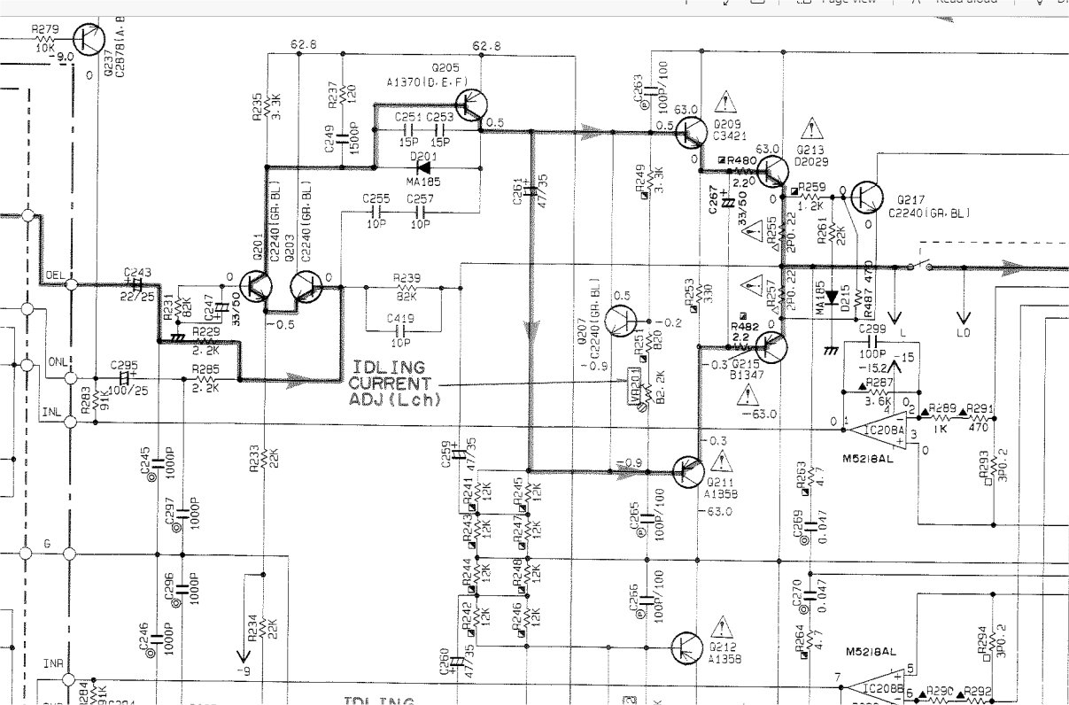

What limits this design? A high beta EF2 is quite adequate for 8R. This design was discussed to the limit.
The PCB IS ideal for what this amp was intended for. Grounding is star based, signal also goes to that star.
Yes , you could make improvements .... maybe 5db hum/noise or a few
PPM THD - so what ?
As jwilhelm mentions , there is the slewmaster. But ... one would find it hard to distinguish a badger from a wolverine.
Compared to this (below) - a "natural sound" Yamaha , the Badger is quite advanced. Yamaha uses the -9V aux and a resistor as the current source (ha).
They based 15 years of receivers and amps on this simple design. Sure sounds nice !! You would not believe the jumpers on the yamaha , they
even run the right channel LTP all the way across a 9" board (across the left channel circuit).
PS - A optimized design WAS discussed , but DIYA wanted this PCB to be compatable with the heatsinks and cases in the store.

Hi OS,What limits this design? A high beta EF2 is quite adequate for 8R. This design was discussed to the limit.
PPM THD - so what ?
