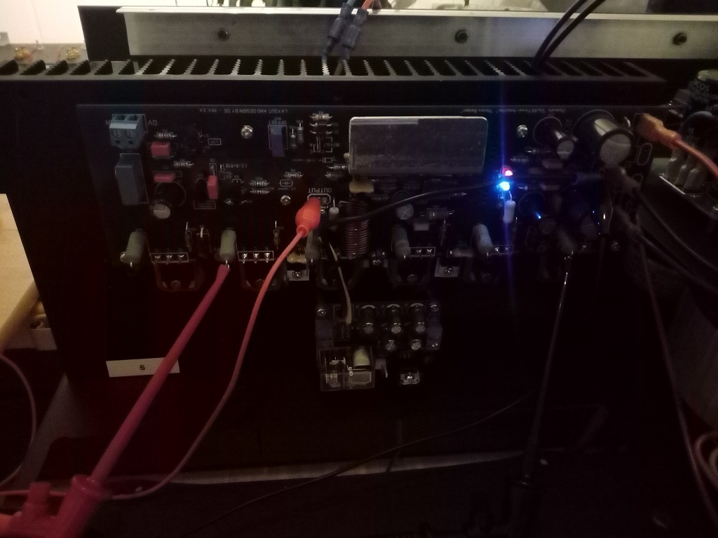

This amp is pretty darn robust. It will take a real beating. I have driven my poor 5ch honey badger hard and beound a lot over the past year. It just smiles and gives me a bloody kick in the face 🙂
(all this given it is build kind of right)

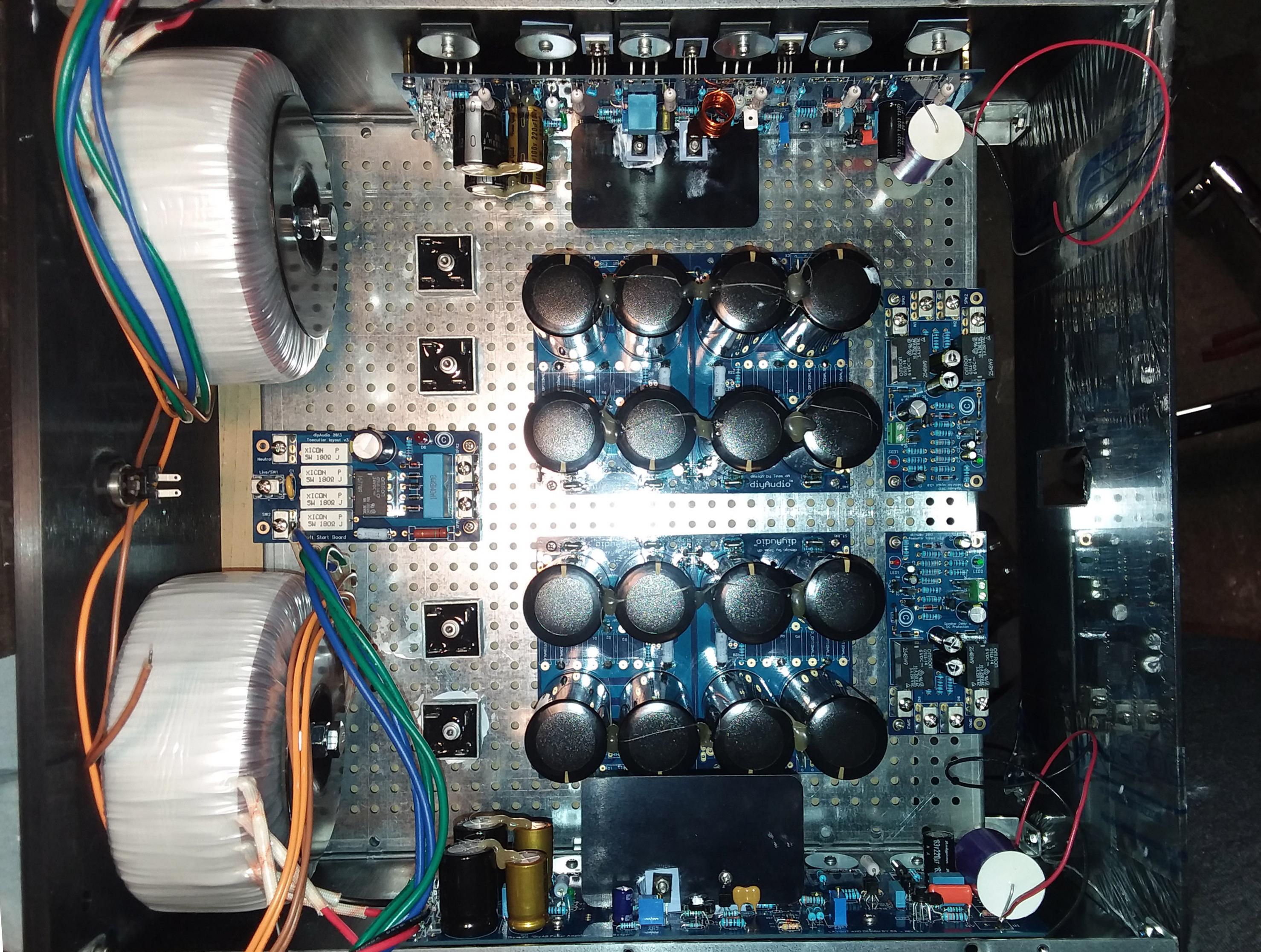

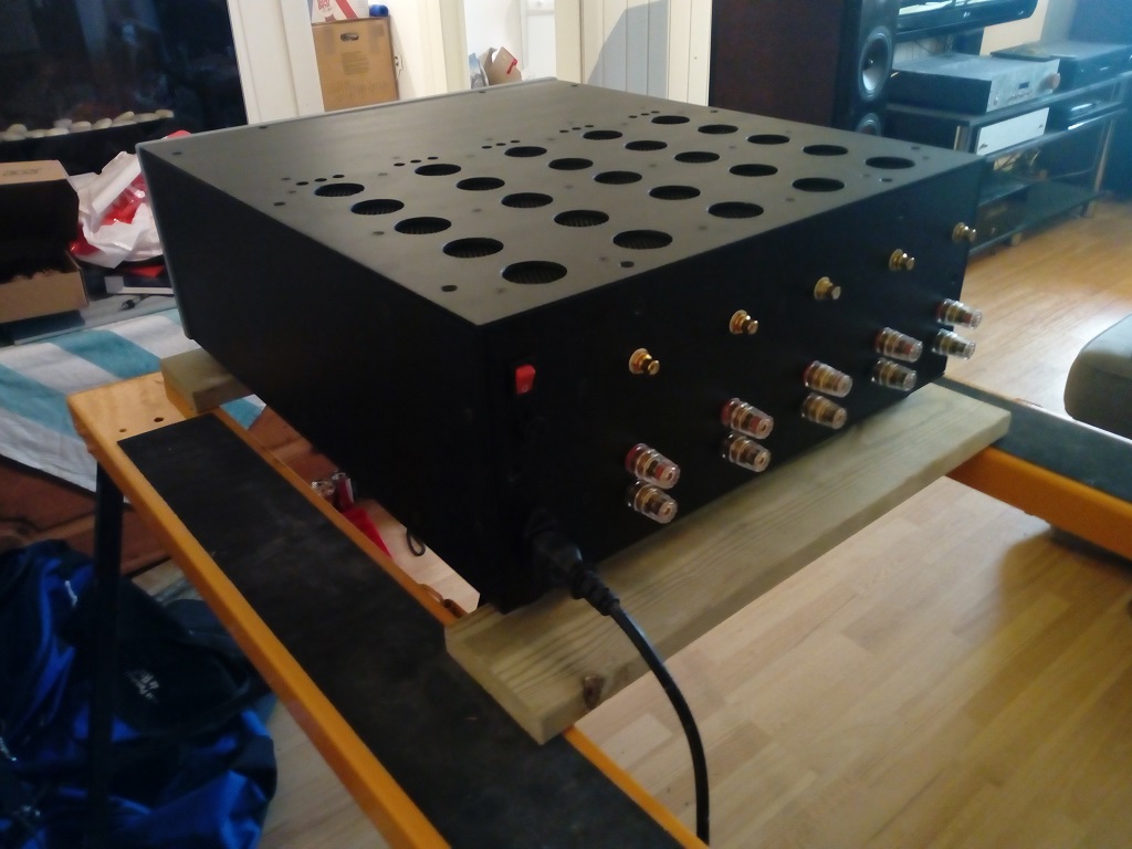

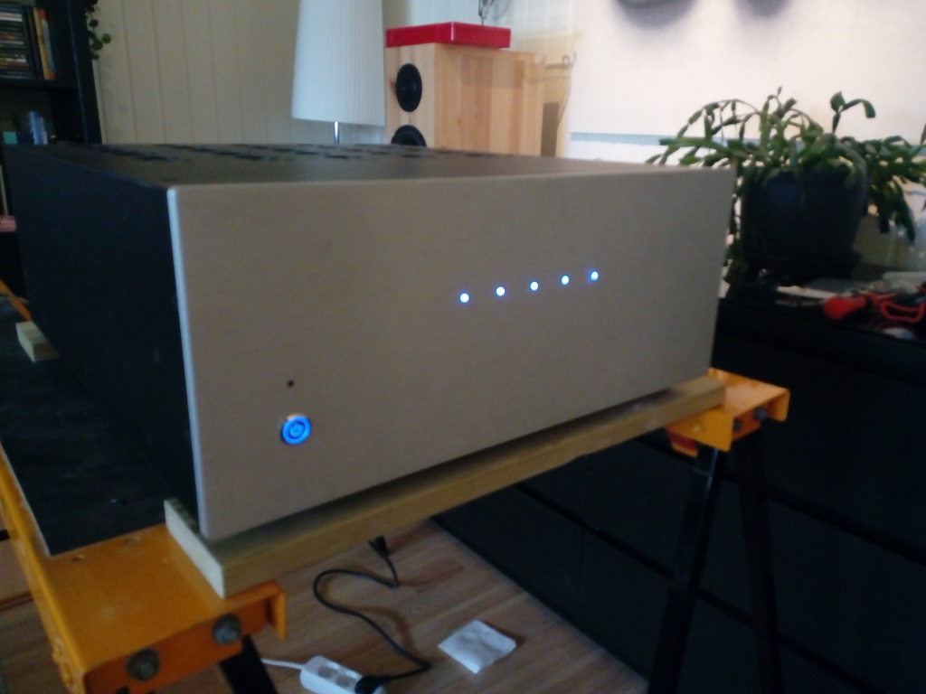

Getting the Badger together.... This will be a dual mono version obviously, the LEDs for the power will be the badgers eyes. I found a cool little decal, I think it's going to work nicely. I almost didn't use it as some of the stuff can get kinda puerile, but "What's up Doc?' 😛
The speaker boards are just there for place holder, I'm going to swap them out for another design.
