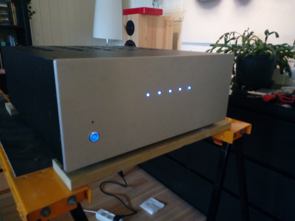

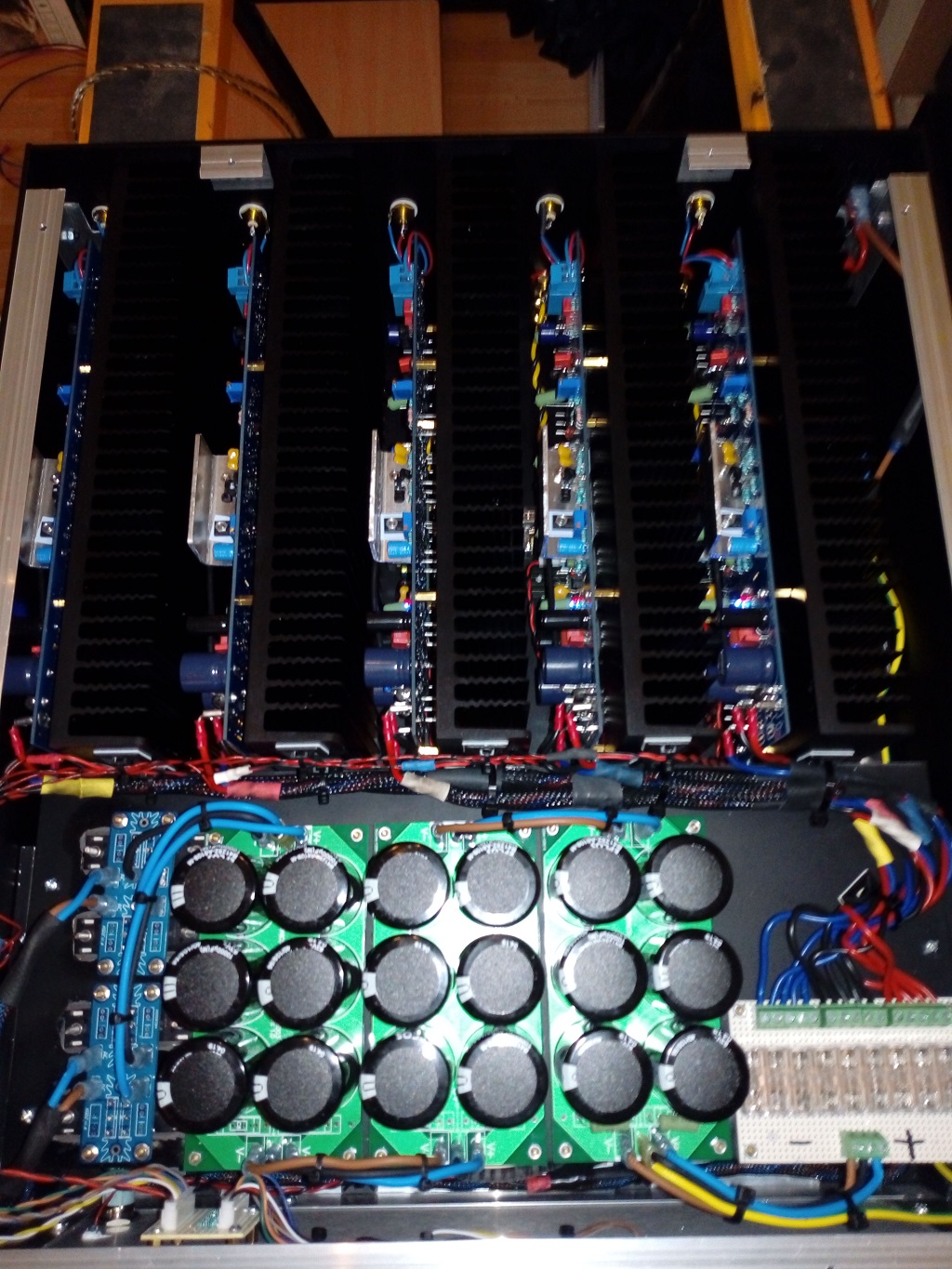

I've build a 5ch of the V2.4. With nothing more then schematics and BOM and the guide from the store. The C2 270pF is a little pain to get a hold of.
