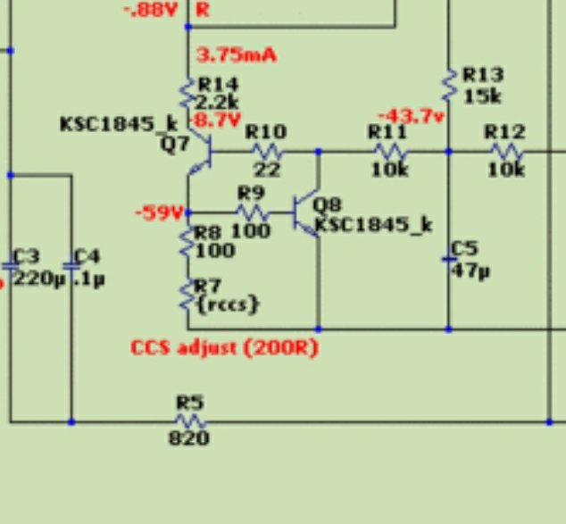

The voltage drop across the base emitter Junction of Q8 causes the same voltage drop across R7, R8 then just use ohms law to calculate current Screenshot_20201020-182914_Dropbox.jpg
Hello Everyone,
I'm just starting this project, but firstly I simulate it. I have question about current source on the IPS. Could you explain why current on R14 is 3.75 mA? Is there any forum/video which explain in detail honey badger amplifier?
Thank you
Jérôme

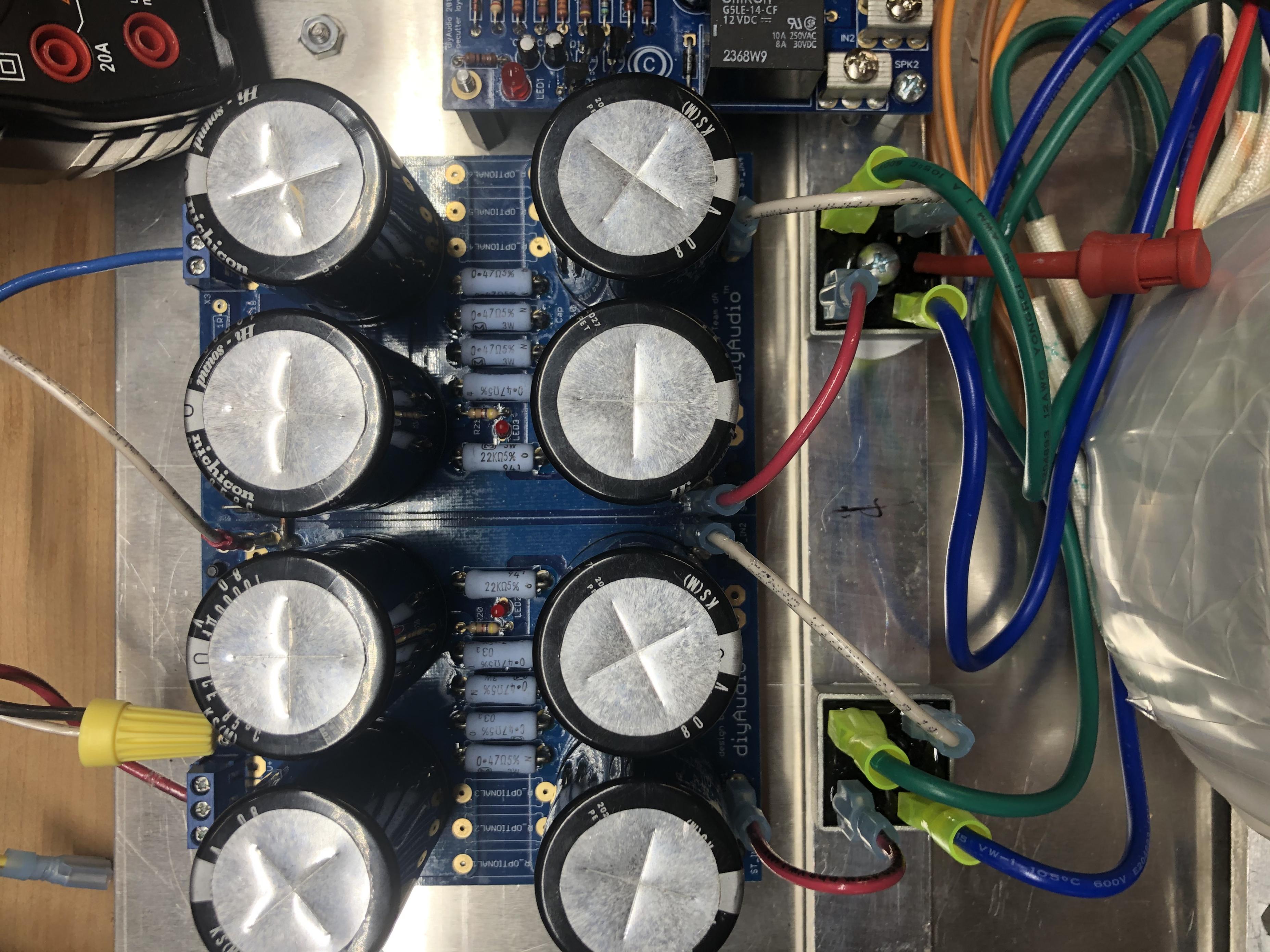

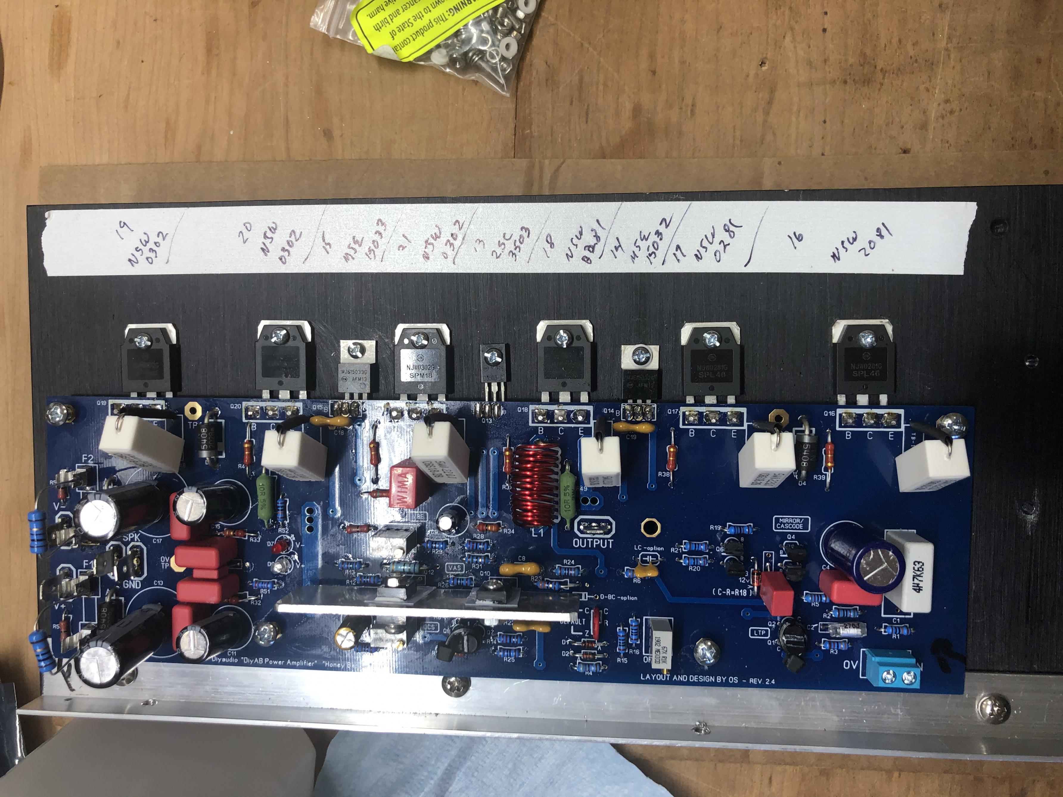

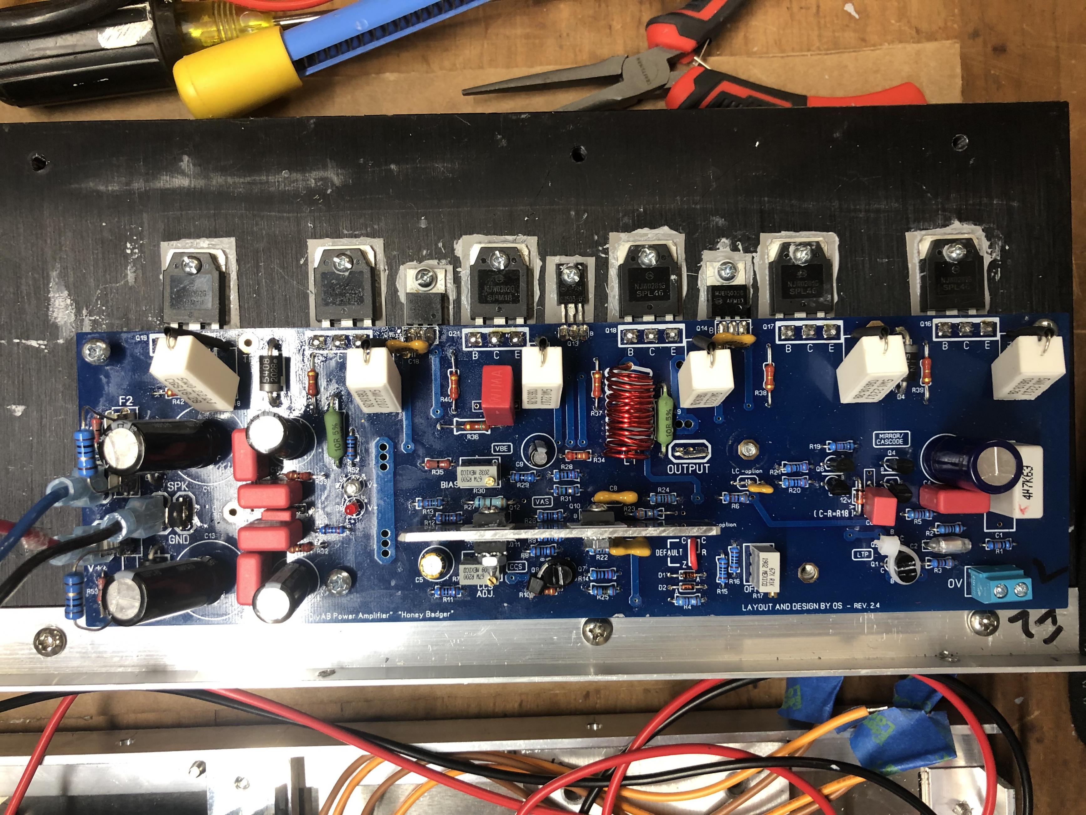

Hi folks I have read the complete thread here at DYI, a ton of experience and information. Very thankful for all your experience. I have built a few amps in my time, however I am no way any shape an expert at electronics, its a great hobby for me.
I am having issues with the Build I have the new boards 2.4 from the Dyi store bought all the parts from Mouser or DigiKey. I have double check triple checked the placement of the parts, but to no avail I have something messed up and I cant figure what it is.
When I power it up with a bulb tester, the bulb does not glow, the two leds light up. And my voltage on the 10 ohm instead of fuses goes up past 1 volt quickly, the Tp1 and Tp2 millivolts low to zero or negative.
DC offset reading from the Speaker output to ground voltage goes up as I increase the voltage from the variac, and the bulb will light as I increase the variac, but goes out as the caps charge and no adjustment will change it. When and I can start to smell a burning so I turned it off quickly.
I used all the parts from the BOM listed on the Dyi audio store site. The BOM is confusing due to the age of it in relation to the newest Sch dated 12/22/2016, some of the resistors are different there.
PSU is Dyi Audio board 3 with Antek 10445 dual transformer, NTE35 amp rectifiers Dual, All caps are from DigiKey 80v 10,000uf. The PSU checks out fine with the rails being 63v 0v -63v.
I must have a transistor installed incorrect, I have check all these and double check the components. I built both boards at the same time installing the components per location on each board after verifying the part. Both boards do the same thing. The leads me to believe I must have the same misplacement but I can't seam to find it no mater how many times I check it. I did have to use MPSA18 instead of SS-9014 I saw some folks with issues there.
Any suggestions on where and what to look at would be greatly appreciated.

I notice the aluminum plate heatsink is quite a bit wider than recommended. Not an issue, but I do know the legs of the transistors and the passive components close by have very little clearance even with the thin aluminum plate. Double check nothing is shorting against the plate.
What I meant is the thickness of the plate is quite a bit thicker. I think the OP used a .040 to .060 inch thickness, yours looks to be about 1/8 or thicker. 1/8 would be .125 inch.
I used 3mm or 0.12" on my 5ch. that's no problem. I did have to check the clerance tho.
Misterwinefine:
And i belive the problem is with Q9. check Q3-6 and Q9-10. Make sure it is right transistors at the right place. And check if they are all okei.
