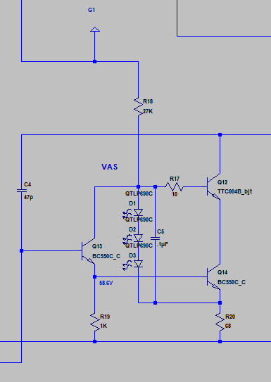

OS
-R18 is dissipating .25W, we can cut that in half if we change it to 27k and tie it to ground instead of the positive rail.
-Add a .1uF bypass cap across the LEDS D1-D3, this will lower distortion just before the onset of clipping at 20kHz from ~150ppm to ~50ppm.
-Maybe add a 2.2-10ohm base resistor on Q12 in case of parasitic oscillation.

OS
1. Ground reference decreases 500hz and down PSRR by 15db+.
2.I like this one , it increases local FB to the cascode.
3.I also like this one , good call.
I mentioned you in the Slewmaster thread as the "unknown member" 😀 .

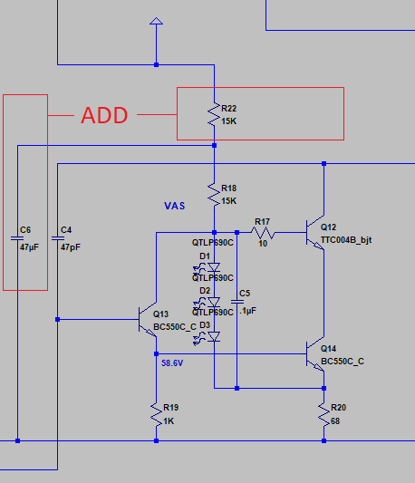

1. Bummer... as far as decreasing PSRR. I'm fine with tying R18 to the positive rail but if you still want to entertain lowering the dissipation, what about doing this to keep R18 current constant? Also what is your method of measuring PSRR in LTspice?
HaHa I've read a lot on diyAudio but I've never posted before.
