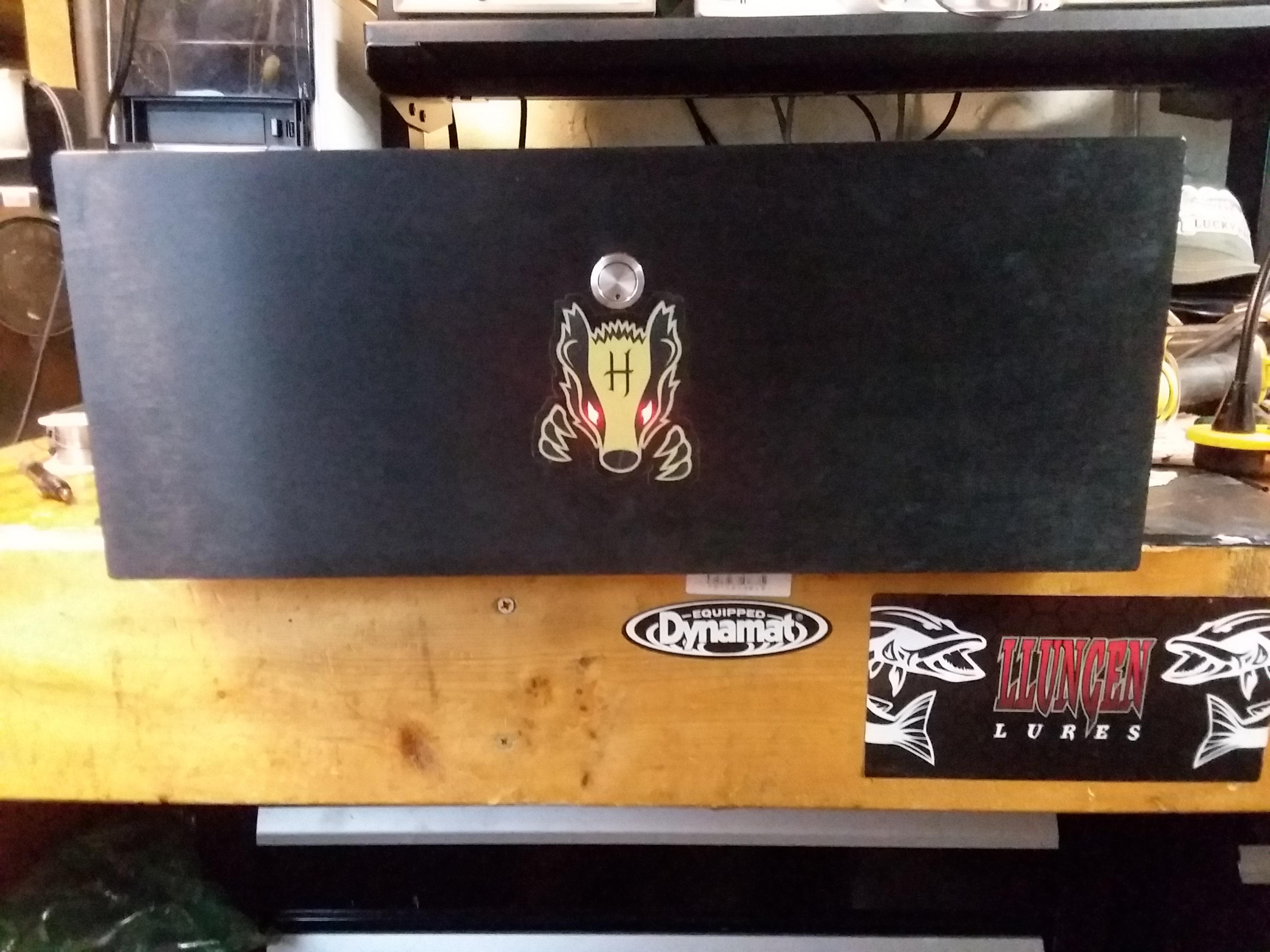

Okay, she's running both channels. Still on the cheap test speakers for a few day, but the control is pretty nice. The poor lab speakers can only handle a fraction without starting to buckle.
I've been using amps under 30 watts for so long I forgot how good something with power to spare can be. I usually don't listen to loud, but when I do I can hear the lack of spare power.
This will be an amp that I crank up when I feel like making the walls breath. 🙂

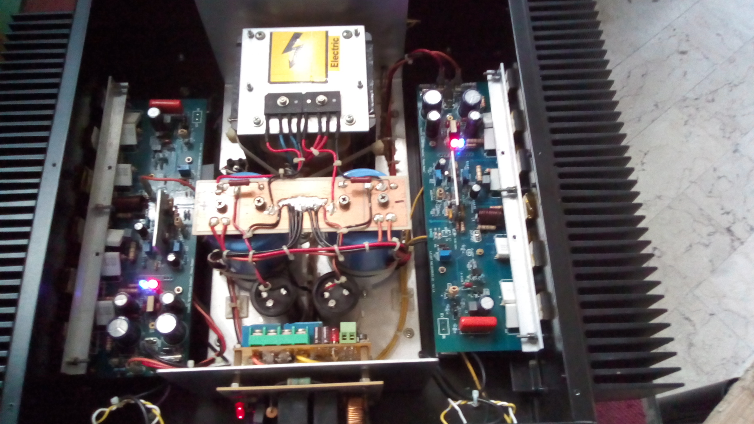

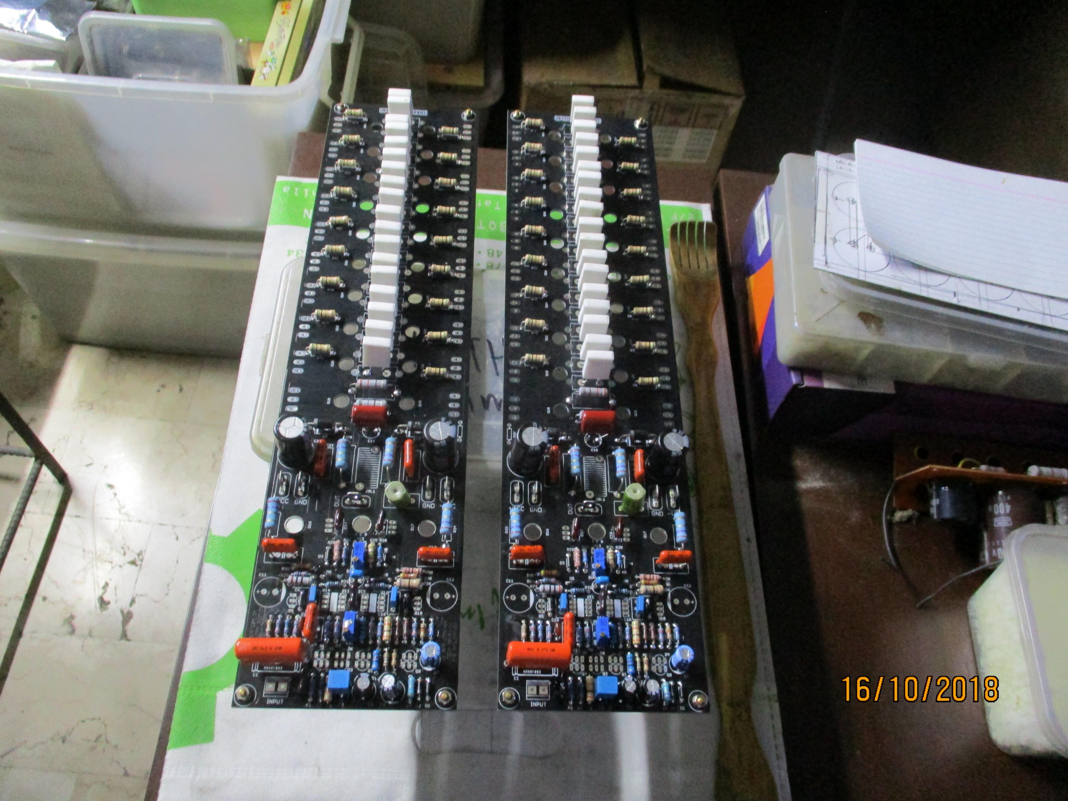

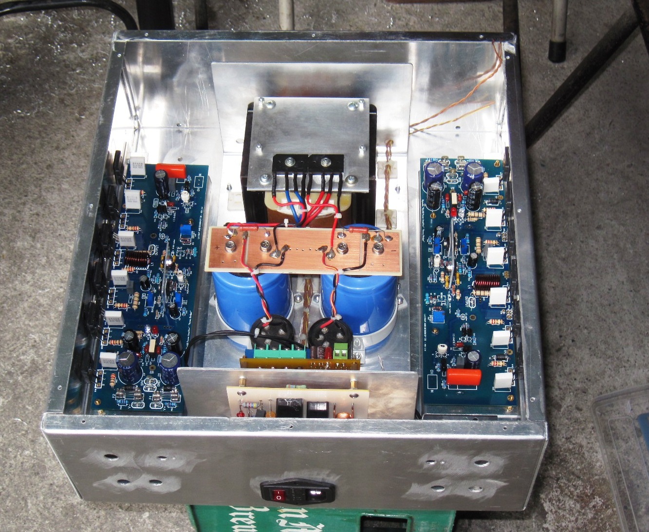

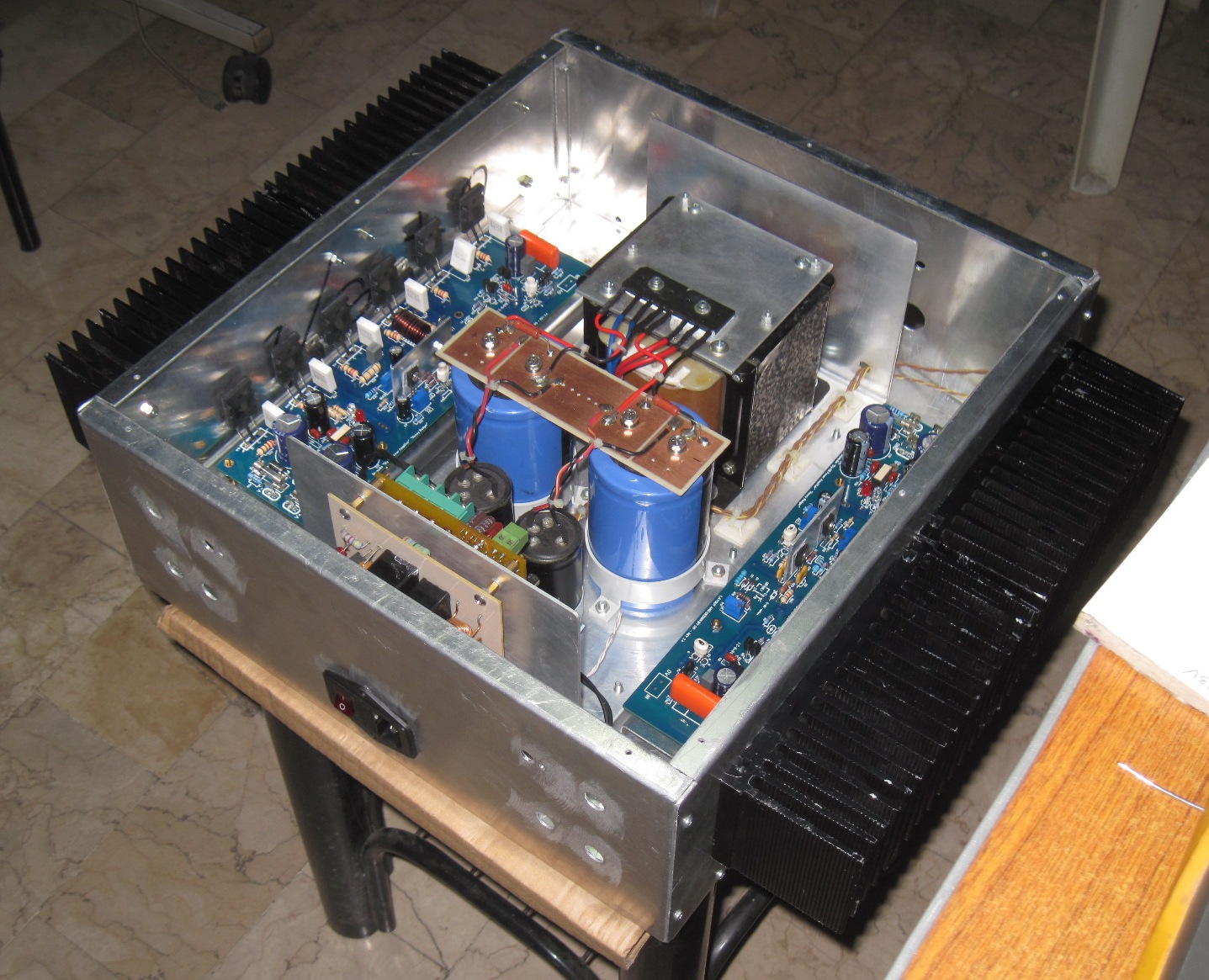

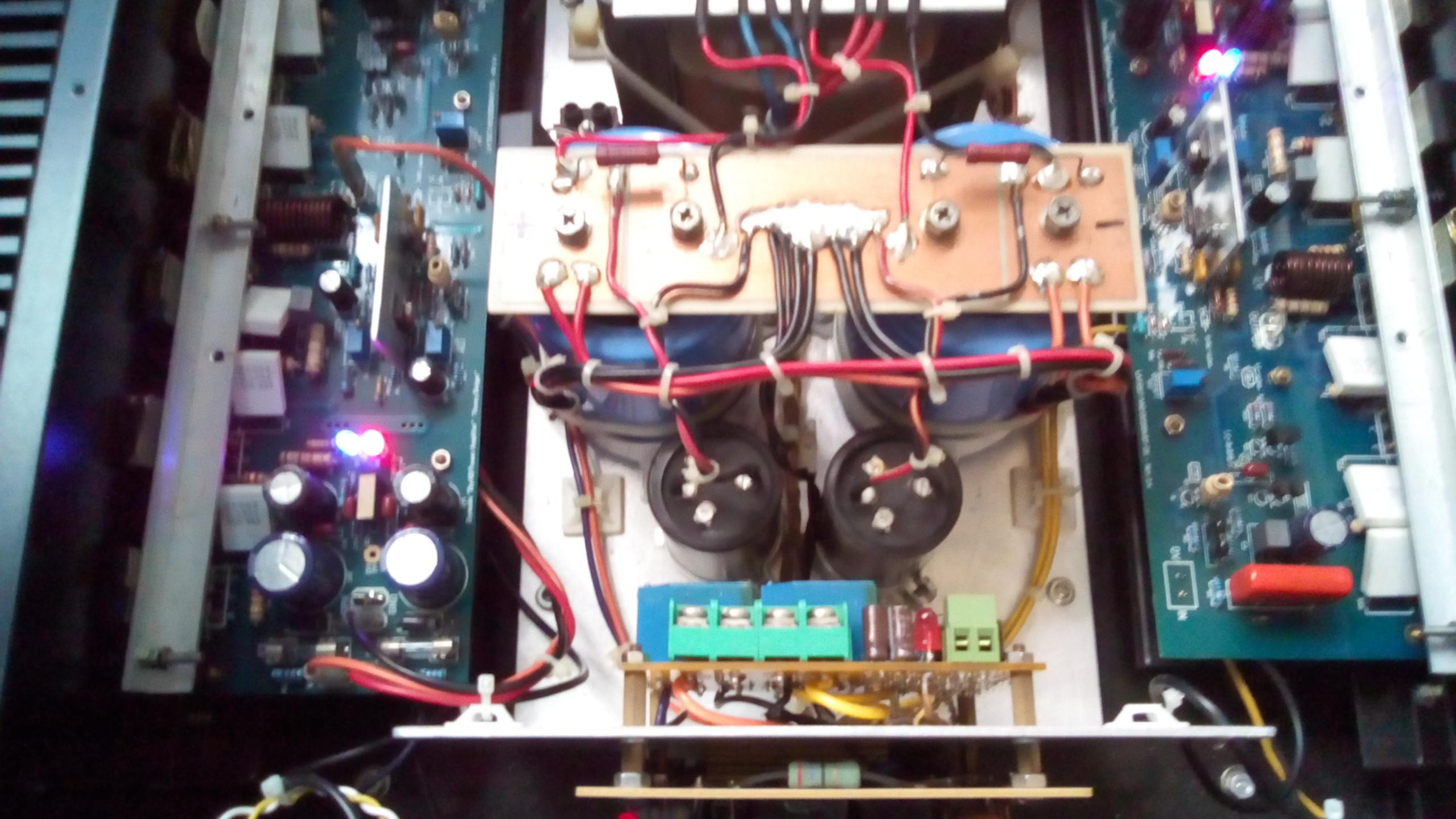

EDIT: One thing I like to see in any design is boards that I can mount the same way on both sides... The Badger doesn't do this... say I want both input section at the rear of the sink, I have to mount one of the boards upside down, which crested a hole other set of problems. I like to keep my input runs short, so I want both to the rear of the case. I don't want to run and input 14 inches tot the board, ya'll know why. So let's make them so I can keep the same orientation from left to right and the in/outs are se-metrical. PLEASE!
this is how i mounted boards in my amp....
Ya, I know, one or the other input will have to run 10 inches or more inside the case. With all the stuff I have in mine this is less than optimal. In fact, I have had great results with amps people say need special care for shielding and other measures which were not needed, by keeping the layout as clean as possible.
There is no reason the boards can'r be designed, so that they are oriented the same way.
It's not a deal breaker, but if you think about it, it makes sense from many directions and simplifies the layout....
Just sayn
