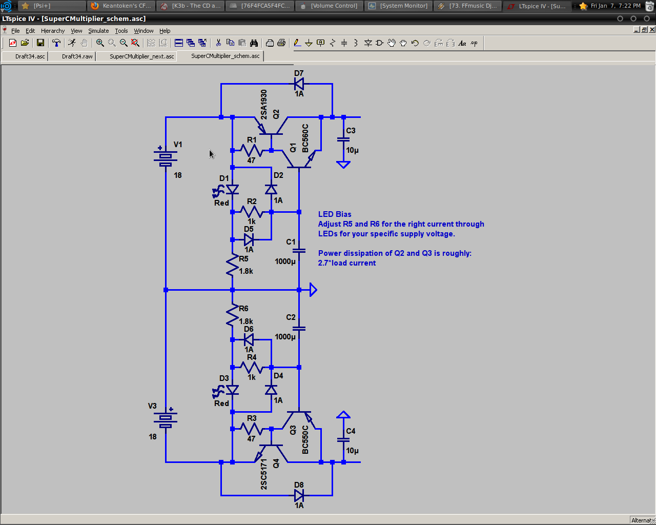

Cool,
If for eg. more than 150 - 250mA would be needed which semis would You recommend to be most appropriate in Yours particularly circuit ?
If R5 & R6 will be changed for trimmers, than fine tuning of Op. Voltage would be possible and after fine adj. under working condition than can be replaced with fixed R value for each trimmer?

The K-multiplier is just like a cap multiplier; it doesn't regulate voltage, just filters it. So fine adjustment of output voltage would not mean anything.
In most cases there is little reason to not use BC550C/560C for the drivers. The output transistor should be as fast as possible, and it's Hfe high enough that at max expected current draw, the driver won't see more than 20mA. In the past I recommended 2SC5171/A1930, but these are much slower than the datasheet specifies (unless the pair Syn08 got are fakes). For currents up to 100mA I recommend the 2SC4793/A1830. For currents over that I recommend the MJE180/170. These should work for the currents you specify.
For most cases heatsinking should not be necessary.
Attached is the schematic I recommend for this amp. The LED should be treated as a voltage source, and should be increased so that the ripple from the rails does not regularly clip the regulator. Two things can be changed due to the low current draw; the output transistor can be a BC550C/560C, and R2/R4 can be 10k, so a smaller filter cap can be used. R1/R3 should be through testing to determine the best value; I suggest to start with 390R.
