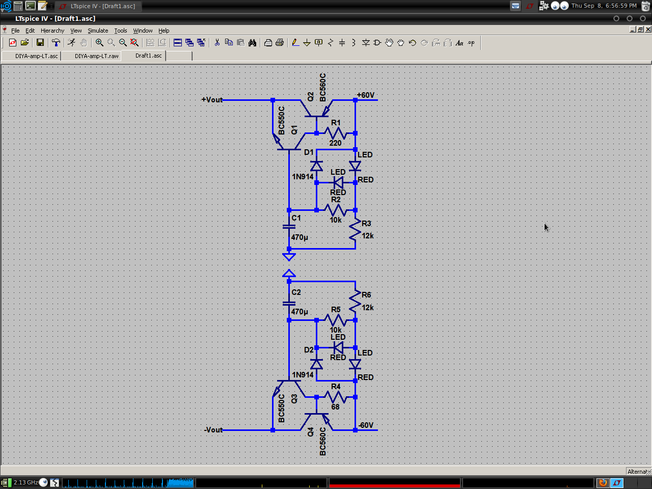

There are a few different options for the K-filter.
We could use no bias resistor, and use the k-multiplier only as a filter, and add lytic+film decoupling as usual. This is analogous to using the K-multiplier in place of a simple C-multiplier as OS has done on his previous amps.
We could also use 2SC4793/A1830 outputs, and draw an extra 100mA, for very low output impedance, and hang a 1u film off the output. This has the potential to work as well or better than lytic/film decoupling, but the idle dissipation cost is high. Could be an option. MJE180/170 outputs would allow higher bias for output impedance likely exceeding most lytics.
For the first option, here is the schematic I suggest. On the positive rail, the slave transistor takes 10mA of the final current, so it won't switch off in case the VAS current goes to 0. On the negative rail, since there is little danger of AC currents here, the master takes most of the bias current, which will give a lower output impedance.
LEDs are chosen for higher on voltage, so hopefully no diodes are in conduction during normal supply ripple. On music peaks which threaten to saturate the filter, the diodes should conduct momentarily to keep the filter in a normal operating range. Perhaps the filter should be tested on a real model of the amplifier, to find the best combination of time constants as a compromise between filtering and diode conduction on music peaks.
- keantoken
- keantoken

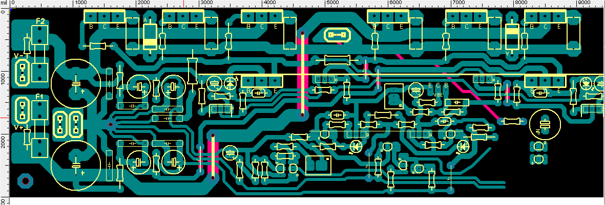

I looked at the design package (post #188) and have to commend ostripper for his hard labour! It's a ton of work to do up schematic, simulation, BoM, PCB and construction notes for the community
I believe he's offline (moving) right now?
Possibly a few minor corrections; on the PCB (Rev 2.1) some designators are swapped but do not affect operation:
Q19, Q20, Q15/C18, Q21 - Q13 - Q18, Q14/C19, Q17, Q16 (pcb along heatsink edge)
Q21, Q20, Q15/C19, Q19 - Q13 - Q16, Q14/C18, Q17, Q18 (should read)

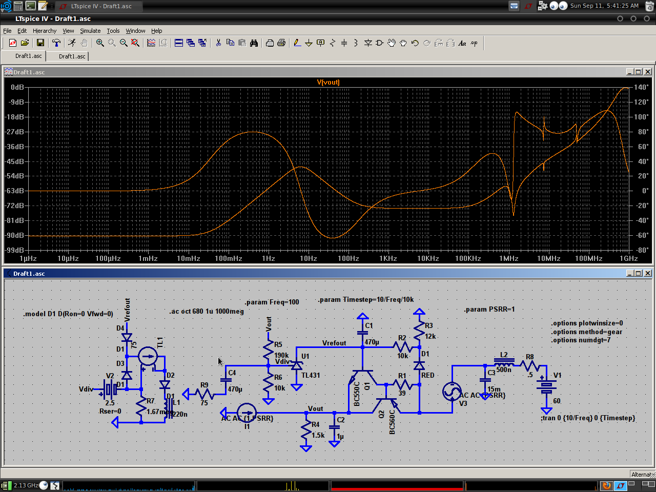

I haven't tried it, but I could put a TL431 at the output to adjust the output voltage slowly. However one reason the Kmultiplier works like it does is that the output voltage at DC depends on the input voltage; thus the voltage drop across the transistors will mostly be constant, for guaranteed low dissipation. When you add a regulator you must worry about the transistor dissipation and be careful not to exceed input voltage.
Something like the attached could work. The network C4 and R9 is necessary to reduce TL431 gain at HF so it doesn't clip into the 470uF filter cap (R9 is needed to damped a bass resonance). Simulated input filtering is plotted. This is with Cordell's models and a TL431 model I created to be very accurate to the datasheet. Output voltage is held at 50V, though I realize I'm exceeding the TL431's voltage specs (maybe a simple series R is good enough?).
Tomorrow I may make another simulation with the C4793 output and shunt bias resistor.
- keantoken

2 power failures.... I will look at these discrepancies and report back on 9/19 (no internet currently).
The PCB should be good to etch as these are just labeling errors .

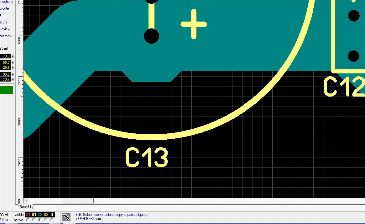

C13 is easily readable (image 1), especially if screened by a good manufacturer.

C2/C3 - please add one more hole to allow for 5.0 mm LS.
C5/C9 - I suggest that an 8.0 mm diameter cap will work, after checking with a vernier on a scale printout.
C13/C17 - please add an extra pair of holes to allow for 10.0 mm LS.
Also,
C20 - please add 2 more holes to allow for 15.0 mm, 20.0 mm LS (required for polypro caps)... unless polypro caps offer no advantages vs polyester caps in this application.
C12/C16 - if you can move C11/C15 to the right a little bit, please do; a 5mm thick cap will be a tight squeeze here.
C10/C14/C21 - can you add a little more space between these caps? 5mm thickness caps will not fit here... you might have to move R32 and C11 to allow that, though.
