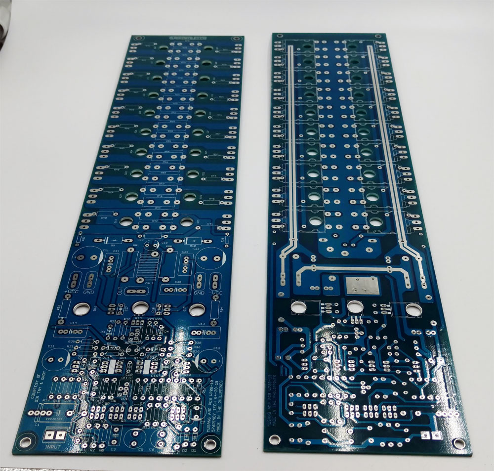

After corresponding with Variac on the present layout of the DIY case they will offer and the diyAudio heatsinks drilling pattern, I have ported the well known TMC LIN amp to a 75mm X 250mm PCB (below 1).
Some doubt the level of fidelity a circuit such as this can reproduce , but I aim to show them that simplicity can be good.
The design goals ( correct me if I'm wrong) are :
- 150W/8R - 250+W/4R , 3 pair easily obtained BJT output devices run in a Self EF2 configuration. (to-3p or to- 247)
- "All in one" construction - A pair of Apex Jr. 8200uf's , or just about any 10mm or 22mm 4 pin snap-in capacitor can be mounted on the main board. I looked up the panasonic line of 35mm caps and one could even grace this amp with 22,000uf X 2 @ 63V. :cool:
- To avoid some of the layout "issues" in common with some DIYA amps. Grounding will be fully starred with voltage stage/input stage "lifted" and brought to the star at center point. I could also implement separate or "boosted" supply points which could be used if desired. Output feedback take off point and speaker tap are also "dead center". All semi's will be thermally coupled for almost "military" reliability.
- Compensation and other aspects of the basic design will be user defined (miller - tmc - 2 pole) , I have tried all 3 with success. The basic design is quite documented already in both D. Self and B. Cordell's books. My oldest DIY amp is similar and has been used for 2 1/2 years.
-Cost , this would be up to DIYA - There are no "exotic parts" , all are readily sourced. Even as this is so , the amp generally will have -110db noise , 1-2mv offset , and near PPM distortions with 80V/us slew.
Any comments or suggestions , the base circuit is (below 2). Any valid idea's on either the circuit or layout welcome. I am at the voltage stage / input stage layout now - I think the output stage will be free from any errata - I've used this "style" before :) .
PS - the board will be double sided with the option of a single sided full DIY etch (no jumpers).

You "hit the nail on the head". I hate the standard EF3 , harder to thermally and electrically stabilize with modern High Ft semi's.The Cordell DBT triple is quite superior , but too complicated. The EF2 can be good if the VAS Ic is high and the driver/output beta's are high. 3 OP pairs also work very well with an EF2.
The "tradeoffs" here are:
-Larger onboard capacitance vs. design sophistication.
-Project had to be ported to an existing Class A chassis with preset parameters.
-A real world assessment of what projects members are actually building , and what skill level these projects are at.
-Just how "bulletproof" to make the project. I really feel the protection should be offboard , PIC or ta7317 based - with PMA's HEXFET ultrafast SS relay. Onboard VI sucks , except for a "road amp" , relays don't always work - unless you get the 100A/ 20$ platinum edition. :D
The Leach amp was good for first time constructors as it used slow devices .My present triple would not tolerate the stray inductances (wires) that you see on the typical leach build. I do know how to mitigate this , but with extra local bypass circuitry , L/R coupling. In my opinion , the leach is too hard for the first time constructor. For every leach build , 10 buy an ebay kit and 10 build a DX.
After I perfect the luxman/DBT (finish any R/D , give it the torture test) , it might be "round 2" as a boardstore kit.
