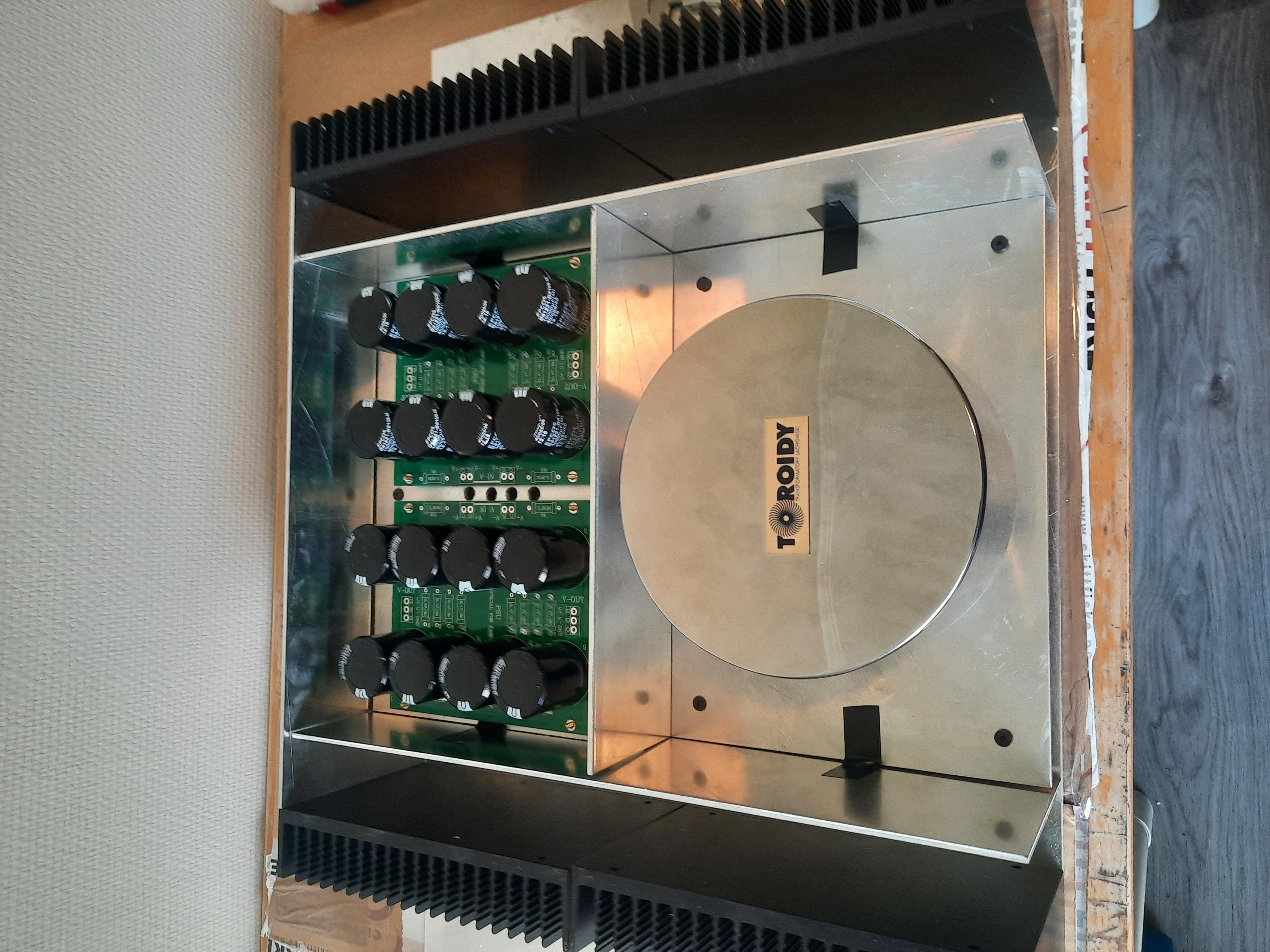

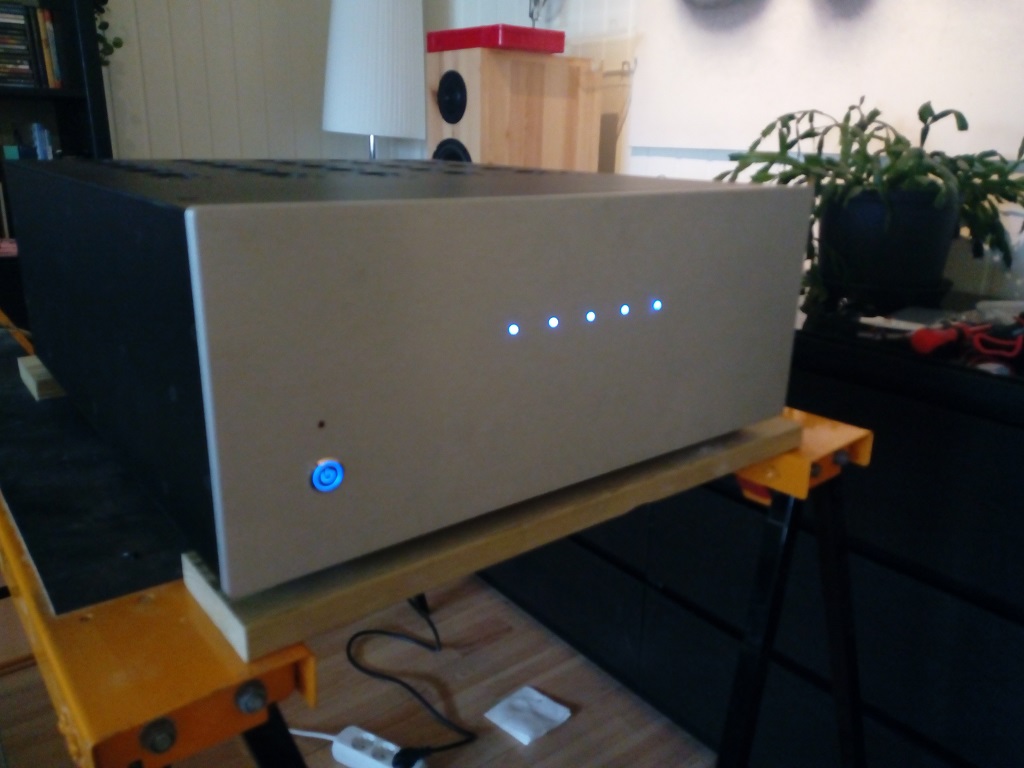

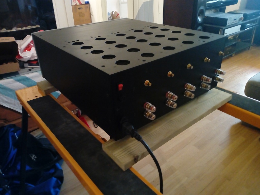

Yes, it's hard to look at the numbers. I have approx. $2500 CAD into mine, and I'm still going. But it will be worth every penny when it's all said and done!
This is the same advice you gave me a few years back, and it makes the process much more enjoyableOne of the secrets to enjoying this hobby is to never add up the costs to build an amp.

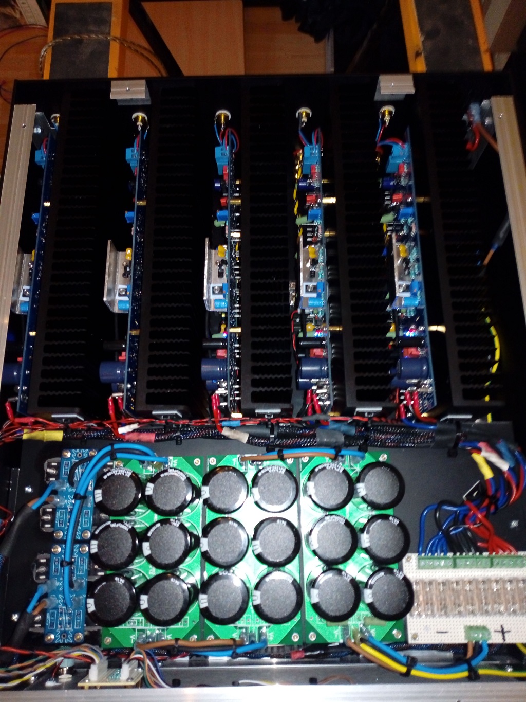

I've got around $2000 US invested in my Honey Badger. That is with a home made chassis. But it's a 5 ch amp. Now i'm building a 2 ch Honey Badger, and that one will cost around $1400 US. That one is also with home made chassis.
AudioSan,
Very nice build!
My Badger is a 2 channel system(with MJL4281/4302 outputs) , with a very smart protection system in the works.
I opted for the 5U deluxe chassis, as it looks great, and I don't have access to material for building my own. I'm a little bit behind schedule, but I am shooting for it to be finished before Christmas.

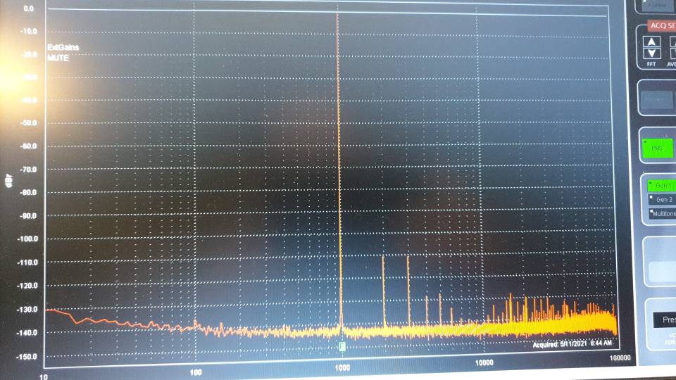

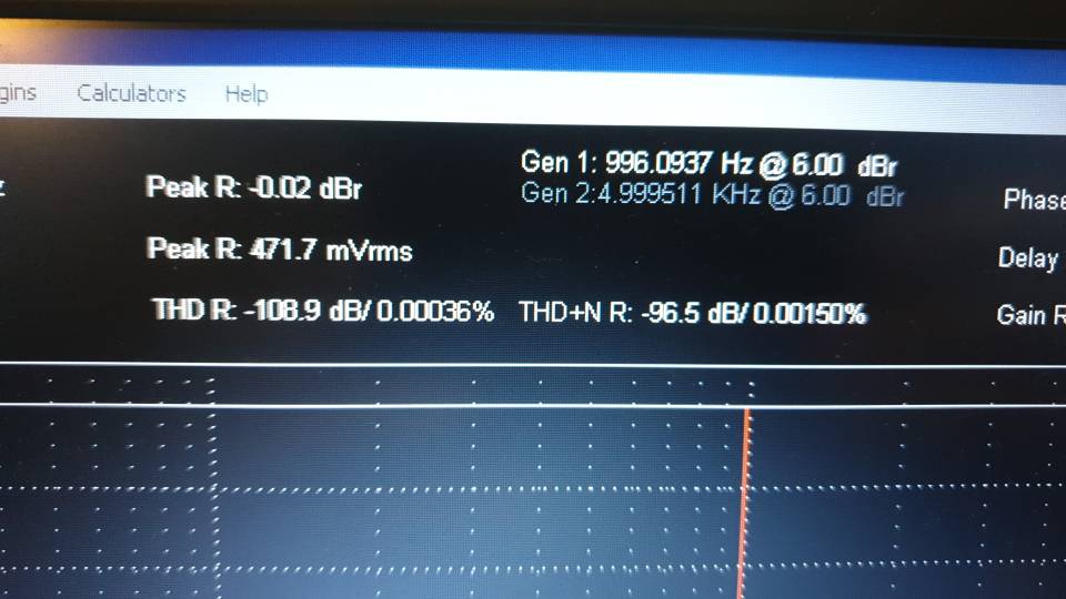

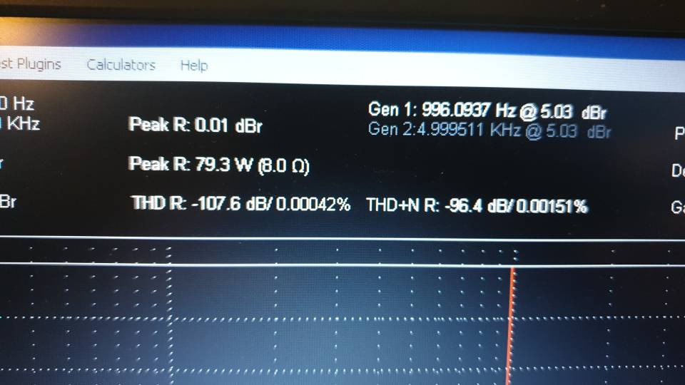

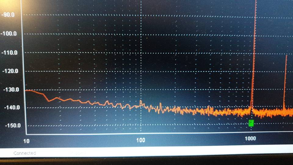

I have posted quite a bit of information on this before. Please search my post history for your answers.Any monoblocks? Balanced?
Any specs? THD+N???
Attached is some distortion plots. Please note that the loopback distortion is 0.00036%
So distortion at 1khz using a 8 ohm load driven to 80wrms is 0.00006%
