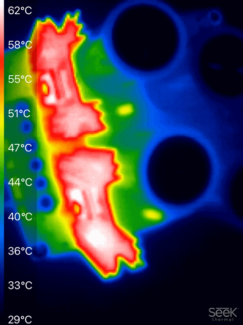

... any suggestions for diodes, and/or diode blocks for an F-6?
Yes. If you're going to place an order with Mouser, DigiKey, Element14, Arrow anyway -- add one more line item to your order and buy some truly excellent diodes for your F6. They will be cheaper than a ticket to the cinema and they will provide you hundreds more hours of entertainment pleasure.
I assume your F6 will use a 2 x 18 VAC power transformer as recommended in the F6 build guide, and I also assume you will build an unregulated DC power supply having two fullwave rectifier bridges (thus 2 x 4 diodes), as shown in the F6 build guide. Possibly using the diyAudio Store's "Universal Power Supply" PCB, or possibly not.
Sometimes builders forget that each diode in a fullwave bridge circuit, never sees more than (2 x Vout) of reverse voltage. Even during a mains spike; yes really. Since Vout for an F6 is 24 volts, a fullwave bridge rectifier needs four diodes rated for 48 or more volts of reverse potential. For peace of mind, add some safety margin and pick diodes rated >75 volts reverse potential. And sleep soundly.
I prefer diodes with the lowest available forward voltage drop, because those will dissipate the least amount of heat. So they won't cook your nearby electrolytic capacitors and reduce their operating lifetime. Here are some low cost options:

Attached below is a thermal imager photo of a PSU board with Schottky diodes on heatsinks, mounted fairly close to large electrolytic capacitors. There really is such a thing as diode power dissipation. Also, there really is such a thing as the inverse square law, so move those capacitors as far away as you possibly can.
