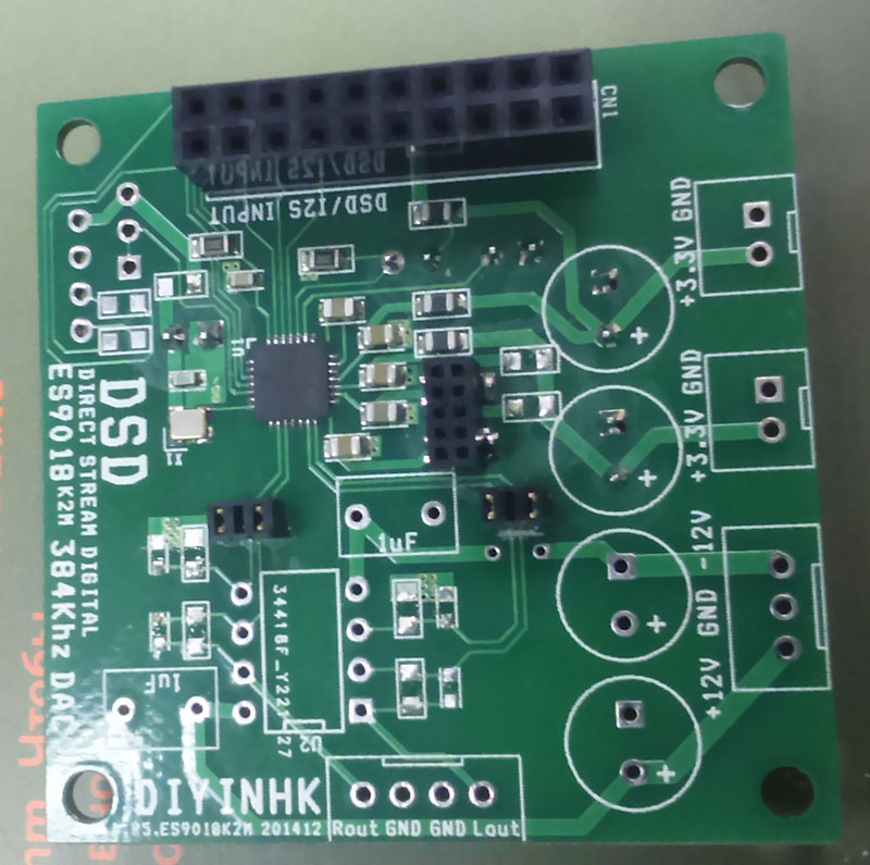

It might be working to some extent but it certainly won't be working well if you are only giving power to the digital parts of the DAC.
I would wait until you can power the output circuit and both the digital and analogue parts as I can't see the reason for testing parts of it.
As long as you supply the correct voltages and solder the parts the right way this DAC will work and sound very good.
I did power digital AND analog (and yes, it works, bad, with only digital supply).
It works well (with a condo) on the raw balanced input with a single ended amp. I did not know that balanced raw input would have a DC offset.
Every current output DAC that I have seen uses the same configuration and floats the differential output on half the AVCC voltage. In a differential circuit it is irrelevant but is a real problem if you only use one phase into a single ended input without a coupling capacitor.

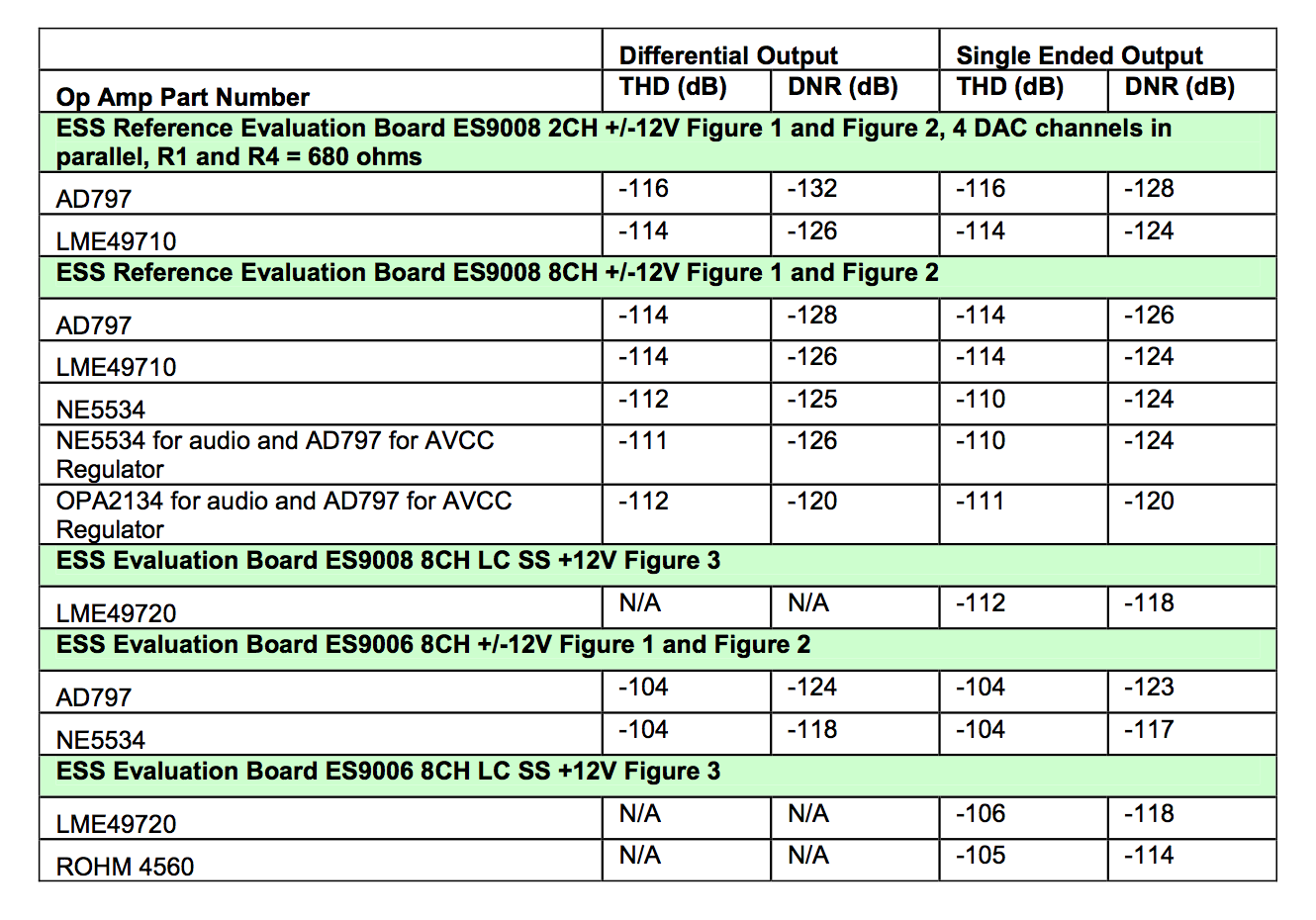

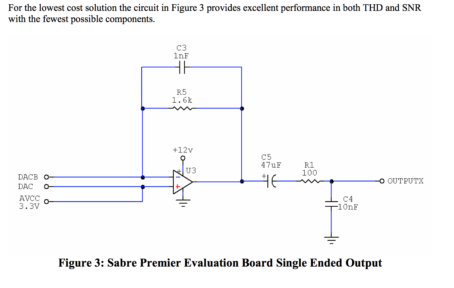

I am using the supplied output stage as it is very expensive to build or buy one that performs much better. The supplied one looks very similar to the single ended only version from the sabre evaluation board which has the RC filter after the op-amp.
This is only 2dB worse in THD which is still -112dB (Figure 3) for an ES9008 using the single op-amp if you use a good one like LME49720/LM4562. Comparison table shown below.

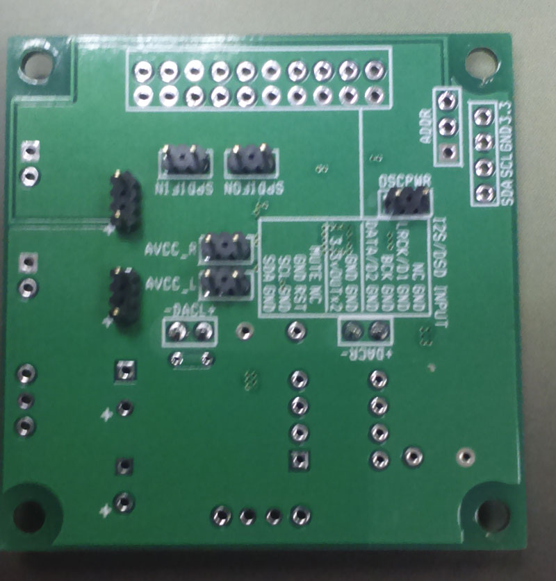

It says Data, Latch, Clxl and Clxr.
Shouldn't it be BitClock, LatchEnable, LeftData and RightData? Did clock and data labeling get mixed up?

Hi, I have this DAC in my system for several months now, very good sound, for output there are 2x ADA4627 opamp in place. Since on board it provides differential output directly from the DAC, I wonder anyone tried different output options? I tried once transformer output with Cinemag CMLI-15/15B, but the sound is weak and lack of bass, any idea how to do it properly? Thanks
I'm looking at the isolated vs non-isolated boards. My question is how clock signal is delivered to a DAC in the isolated version? Is it going through isolator? Or is the clock implemented on the DAC side of the isolators?
Is there schematics or at list a block diagram anywhere?
Where can I find pinout of the connectors?

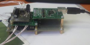

I recently modified that board for easy I/V and power supply changes.
So I made a sandwich :)
Bottom board now contains 5xlm117 (two for AVCC, one for DVCC and two for OSC and VCCA). Top board with I/V schematics left intact, parts taken from original board.
It works, so it will be starting point for further modifications.
There are some questions, though.
What is VCCA purpose? I have no datasheet for k2m. In some sources it marked as "internal oscillator power supply 1.8/3.3v". On original board, pin 17 connected to analog 3.3v via bead. It is good to connect VCCA to separate LDO, powered from supply common with OSC LDO?
I separated DAC ground and I/V ground by 18R resistor to reduce noise. common for balanced applications, it is applicable here?
While playing test sinewave 1000hz/0db file with 100% vol, some clipping occurs. it is normal? No clipping for -3db one.
Planned to build digital power sources on adm7150, analog and I/V on tps7a4700. I/V and LPF will be on lme49710, with balanced output.
