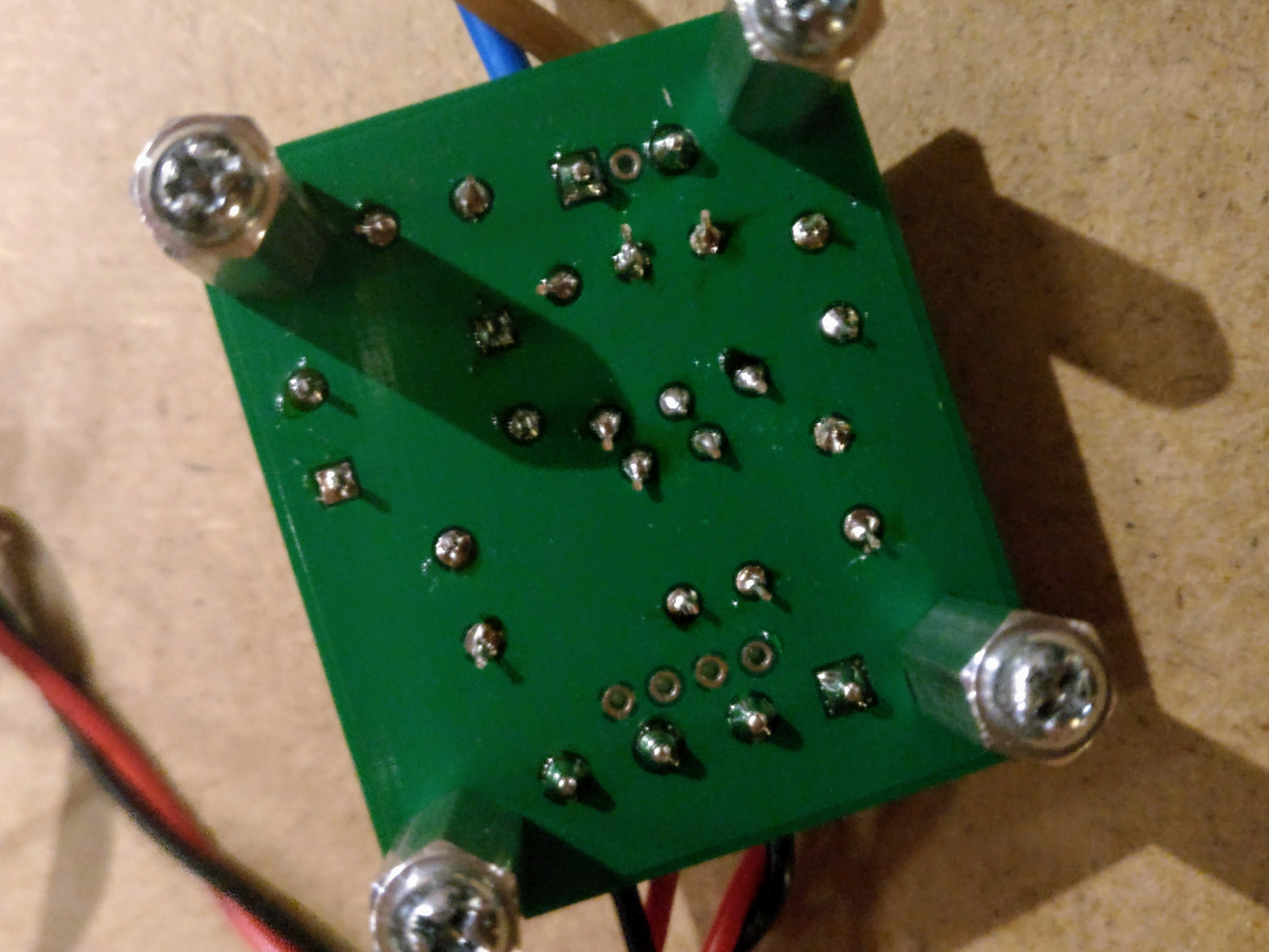

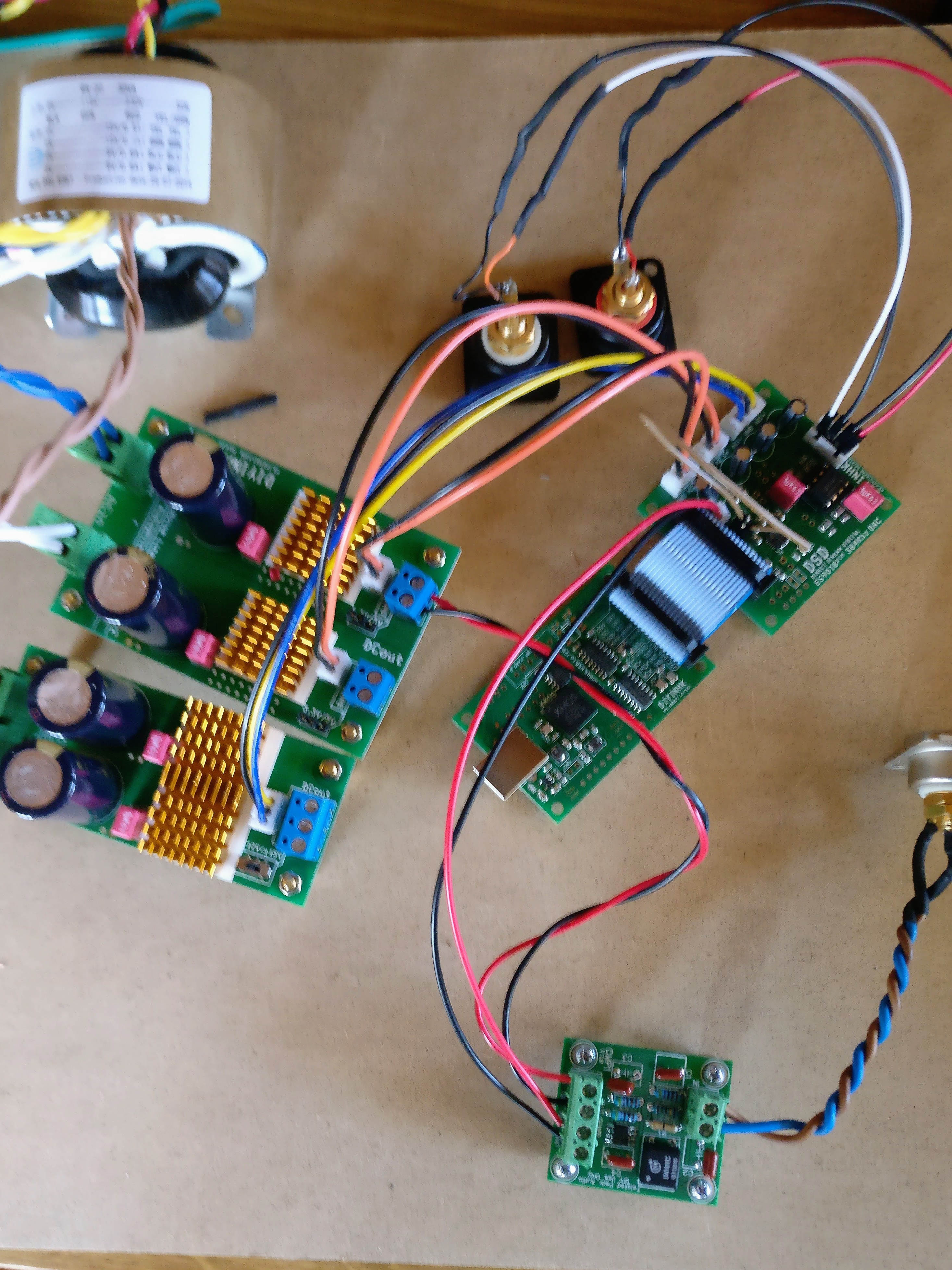

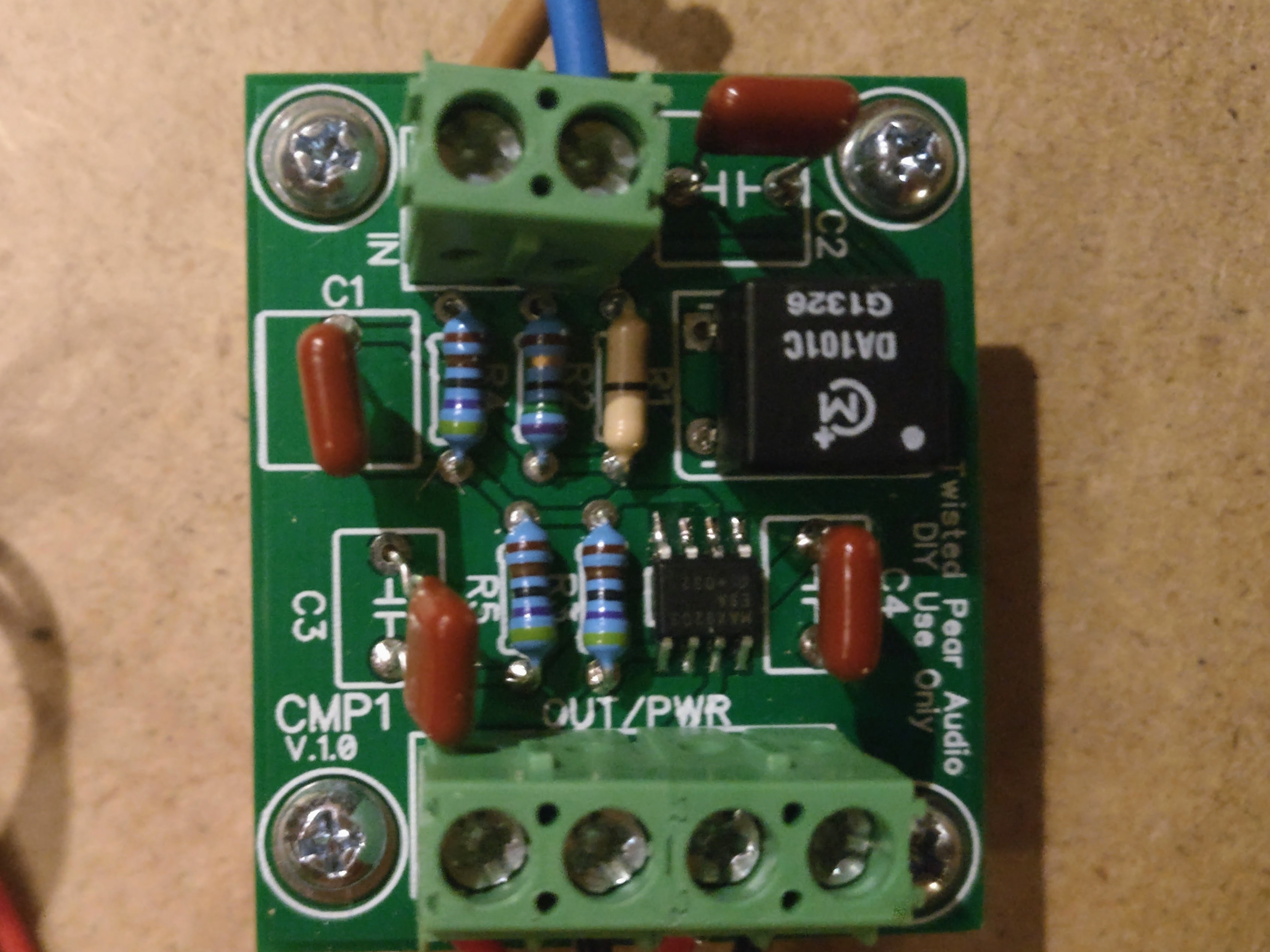

Spdif Coax to ttl converter (twisted pear) doesn't work
Hi everybody,
I know it's an old thread, but I hope one of you can help me.
About 2 years ago I bought the board and matching power supplies from diyinhk.com. Only now I came around to actually build the dac.
Everything works fine and the sound via USB is incredible, I am really happy.
But....
I also have a Sonos system and I want to connect it's spdif coax output to the spdif IN of my diyinhk ES9018 K2M.
I know (or I think?) I need to convert the consumer lever coax out of the Sonos Connect to a 3.3V (?) ttl level for it to work.
I bought this little "Single S/PDIF (or AES-EBU) Level Converter Kit" from Twisted Pear Audio (at bottom of page): The Buffalo III Digital-to-Analog Converter
The Problem: it doesn't work....
Meaning: there is no sound whatsoever. ![dunno :dunno: :dunno:](https://files.diyaudio.com/forums/images/smilies/dunno.gif)
Here are some pics of my setup. Maybe someone can see a mistake I might have made (soldering, wiring...)?
I tried using the 3.3V from my dac's power supplies (digital 3.3V) as well as an externel power supply of 9V - to no avail.
Any tips/hints/help is much appreciated!
best regards
Stephan

The schematic on the Twisted Pear site says 5V which is available from the Buffalo. If you have 5V available from the DIYINHK power supply try that.
Having given it 9V it is possible that you have damaged the IC but without knowing what chip it is hard to say.
It looks like you have connected to the spdif header and closed the spdif jumper but your picture is blurry. Take another one closer to the DAC board and I can tell you if you have it wired correctly.
Do you have a multimeter to measure if there is any voltage on the pins of the twisted pear board?

Are you using 5V for the twisted pear board now?
Check the connections on how you have the SPDIF wired, try reversing the wires any see if that makes any difference. Make sure that the SPDIF jumper points are closed on the DAC board.
If the SONOS has optical out that works with the cheap optical input board from DIYINHK or twisted pear.

Did you try your Twisted Pear board at 5V?
Worst case with the twisted pear board would be replacing the chip. Those 8 pin SMD chips are easier to damage through over heating or you could have got a bad one. The other components should have no issues with much larger voltages than 9V.

I think Twisted Pear are using the Maxim 9203 comparator. They use the 9201 quad comparator in the 4 channel board so it makes sense they would use the single version of that chip and it matches the schematic. I just checked your image and it does seem to say MAX9023 ESA on the chip which is the correct marking for the 8 pin chip.
Maximum Vdd for those chips is 7V so 9V may well have killed it. They are not expensive so you could try and replace it.

I was looking for the little smd chip's description....
Yes, it says MAX9023 ESA but the possible replacements I have have a the same name but a slightly different number underneath. I think it describes some frequency rating or range? Do you think I should try anyway?
