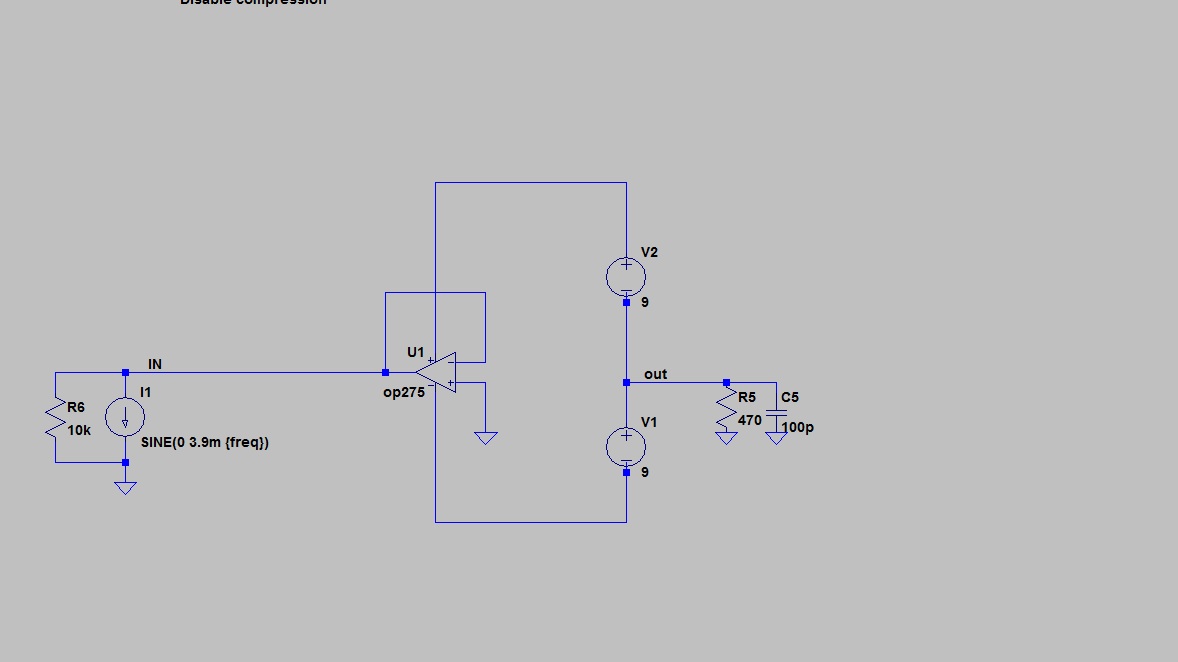

and in answer to your earlier question, return currents where do they come from? the opamp power supply rails, the dac itself and ground. In most circuits the decoupling caps are part of the signal current loop. that is how you can have designs like this cute novelty posted by shinja here
