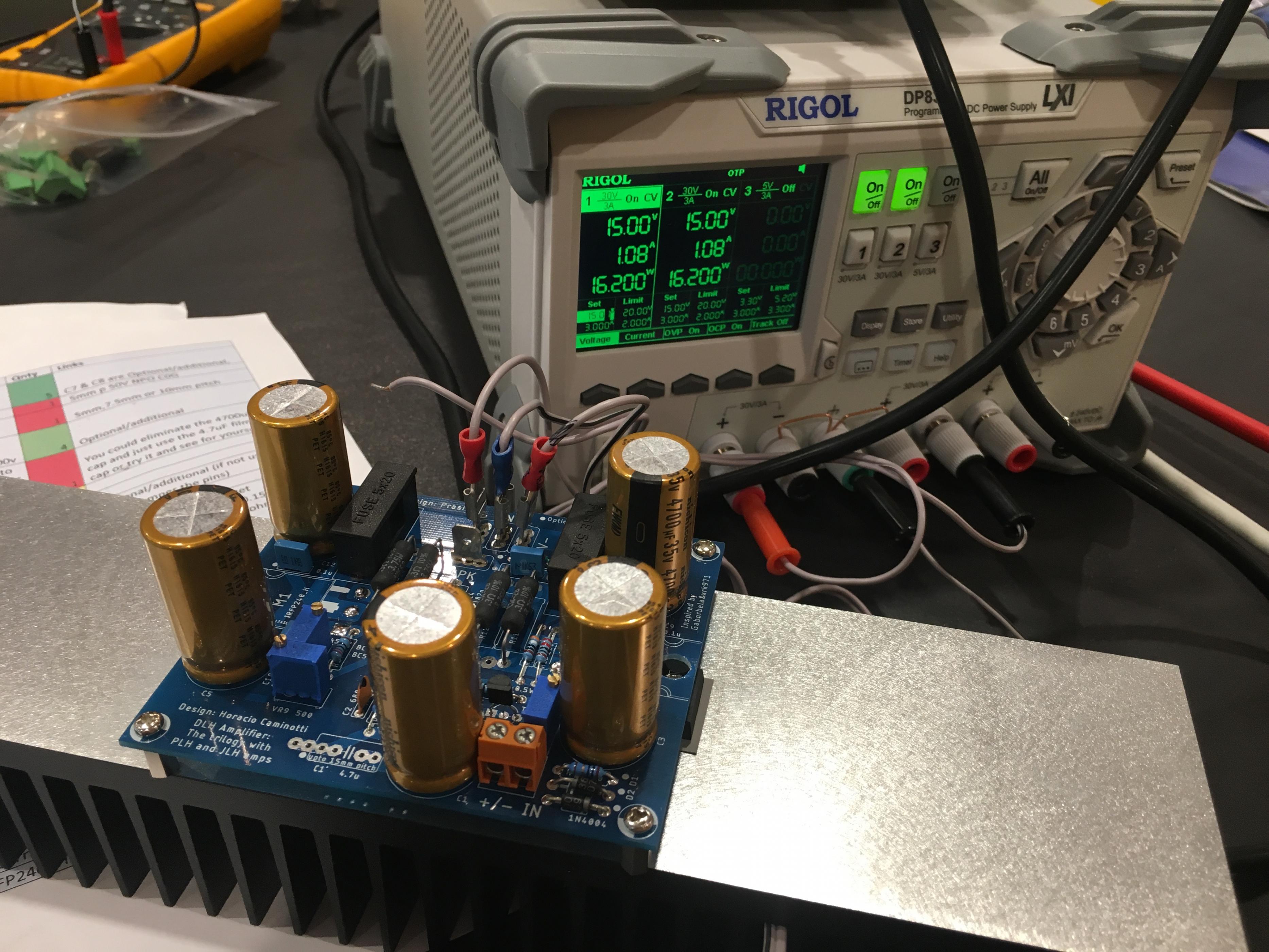

Exactly what i am planning to do with mine Guerilla. They will be the tweeter amps for a fully active system. I have the very nice Prasi boards - all too easy to click on the link to the project at PCBway, pay the ~$20 and have them arrive within a week. Photo of mine gently roasting on my lab PSU at 15V/~1A. Sink only mildly warm (34C).

Thanks Prasi, I will play around with bypass caps for sure - I have some premium "audiophile" caps I salvaged from elsewhere that might work well. Although it only took just over a week to go from ordering PCBs to having them powered today, it may take a while longer to get to point of listening...the rest of system is in pieces at present :(. Will let you know though...
